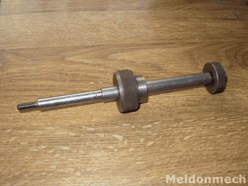

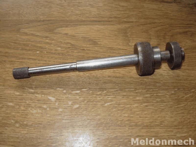

Hi Guys,
               I picked up this tool at the local Boot Sale, and it reminded me of a tool I used during my workshop training. All sizes of dowels were used which had tapped holes in the end to enable them to be extracted.  A similar tool to the one shown was scewed into the end of the dowel and the knurled slide weight slid with some force along the bar several times to knock out the dowel. This one has a 1/4 inch BSF thread and would be used on dowels from 3/8 to 3/4 inch dia. dowels. The 1/4 BSF knurled nut is I think a thread protector when not in use. Has any one used a similar tool for the same or a different use.
                                                                                                                        Cheers David

Commonly called a 'slide hammer' - used in all sorts of applications. There is even a version that grips a pin welded onto damaged bodywork to pull out dents. There is a special large one made by JCB for removing pin bushes in dipper arms.

              Thanks for your comments, by chance I came across a post by Noitoen in reply to Reynards problem with his stuck MT2 taper. His ref. was an Impact Bearing Puller made by Gedore for £ 20.97 + vat. All in all it
appears to be a very versatile and usefull tool, and I have learnt a lot. Andy you have really put me off the Dentist and I have a crown too!

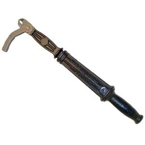

I have a nail puller similar to this one that uses the handle as a slide hammer to bury the jaws in the wood before rocking back on the clamp lever and extracting the nail. Came in handy salvaging some siding.

I borrowed one of those to extract nails from floorboards so they could be lifted with minimal damage. A great device; I offered to buy it, but the owner was too wise for that.

SNAP ! I have the exact same thing - handy for pulling cut nails out of Victorian floor boards - intended for taking lids  off 'proper' packing cases that were nailed shut.

Took only one time to learn not to put your fingers in the wrong place when using the slide hammer feature. Ouch!!  :wack:

I can relate to that. That's a lesson you don't soon forget. I have 2 of them, 1 I bought and the other was from my Dad. I spent many hours on the business end of one salvaging materials from buildings and skids.
