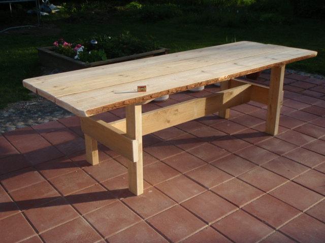

So, I jumpped on the plan:
* Make a 9 m3 crater
* Fill it 8 m3 sand
* Even it with 2 m3 fine rock ash (????)
* Pave 36 m2 of concrete tiles
* Be hospitable to wife's relatives
* Make a table....
Still some fourniture in process...earning brownie points is hard job, but mechman's proven track record keeps me going.

The terrace and table are too good, Pekka. You are in danger of Mrs Pekka's relatives asking you to do the same for them.

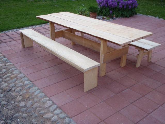

Not only that, but she asked me to make a shrinkking machine to compact fourniture down to aircraft allowance limits :lol:
Build two different benches today. Still have to design a chair for me or  :coffee:
