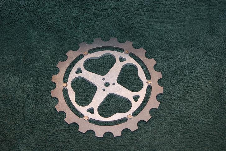

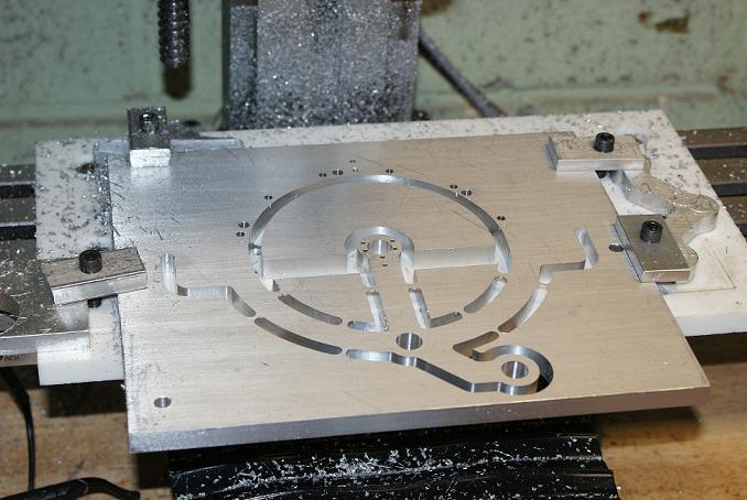

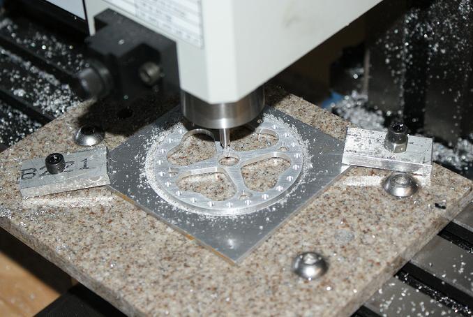

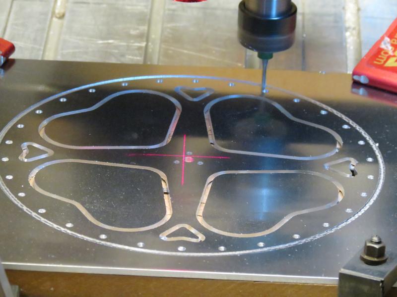

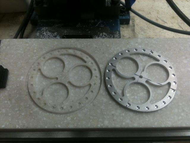

I figured I would start my build of Weston Bye's Clock. I met Weston in Ann Arbor MI. at the CNC build class. Weston had his clock on display and I thought that his cloce would be a great first project with my new CNC mill. I was speaking with Weston and he offered the Cad file for one of the gears. I took the file to the mill and got started cutting it in corian.
Here is a picture

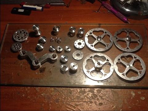

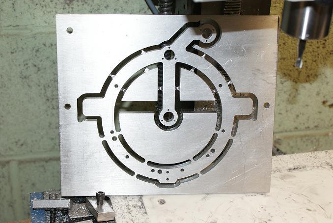

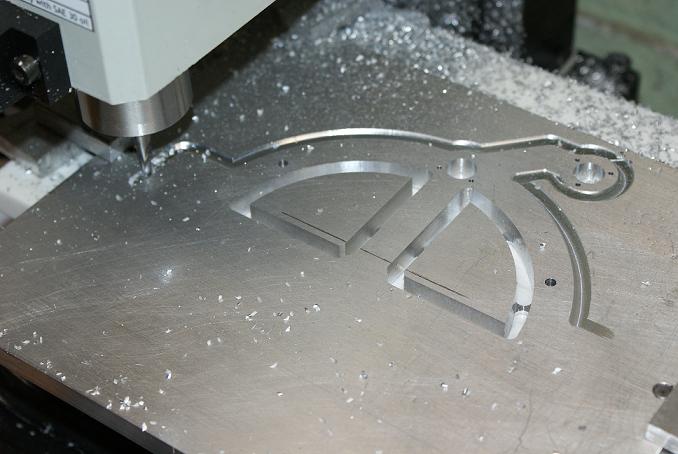

Here are a few more pictures of what I have done.

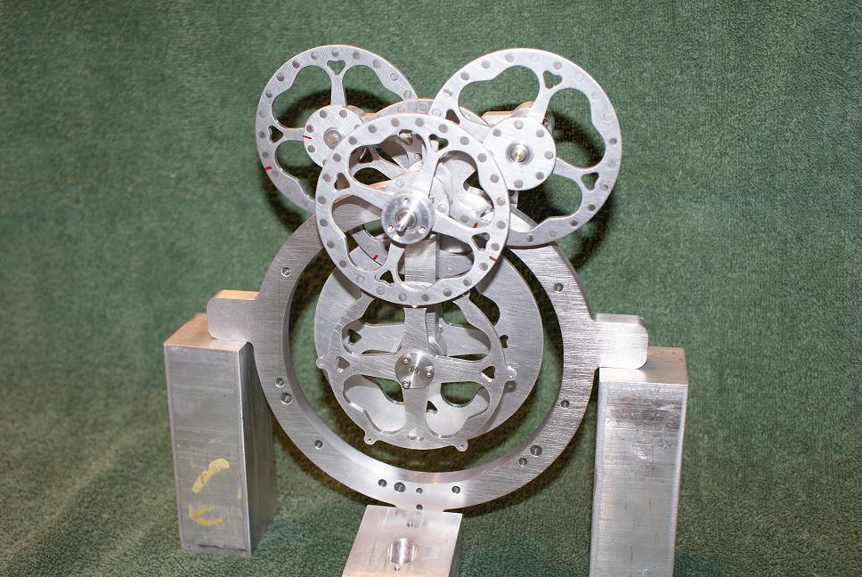

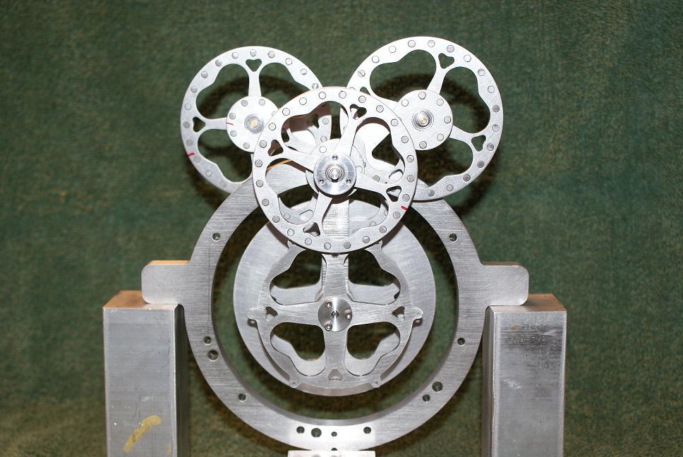

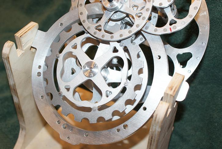

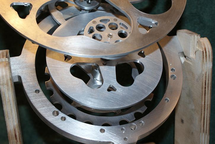

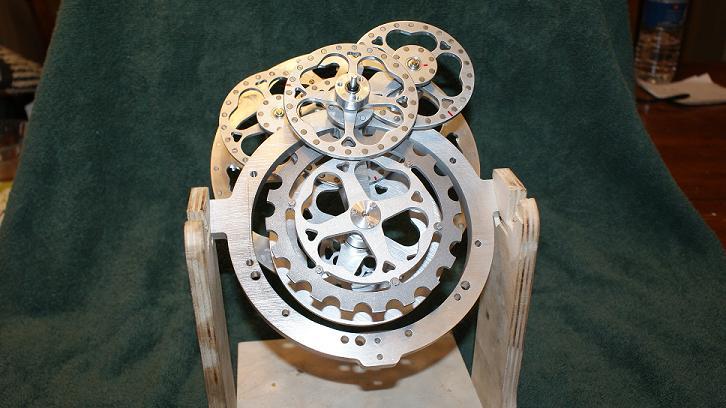

Got into the shop today and got alot done. I have most of the parts up to date waiting on the next issue. I still have the rotor to complete. I changed the design to a bolt together rather than a press. I still have some fine tunning to do and may make some new parts. Here is where Im at so far.
P/S George Im catching you  :D

Ron,  Its working great. If you see above I was able to make a much bigger part than the machine would do. It took some time and thank god Autocad to make a fixture to do it. Thanks so much for all the help at the Build. I would never be where im at if I did not go.

« Reply #11 on: September 27, 2012, 07:01:48 AM »

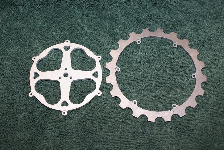

Hi Dave, happy to help.  I do have a question.  In your last picture above, you show a gear with 6 small tabs around the perimeter.  I don't recognize that piece!
Very nice looking work, by the way,
George
Airplane Builder - Pilot
Amateur Radio - WB8BGY
Retired - Having A Ball!
Offline dreeves
  • Posts: 12
Re: Weston Bye's Clock by Dave
« Reply #12 on: September 27, 2012, 07:53:01 AM »
That is the rotor that has the steel piece pressed on. I changed the design to allow it to be bolted on. Look at the second file i sent you thay are the 2 pieces.

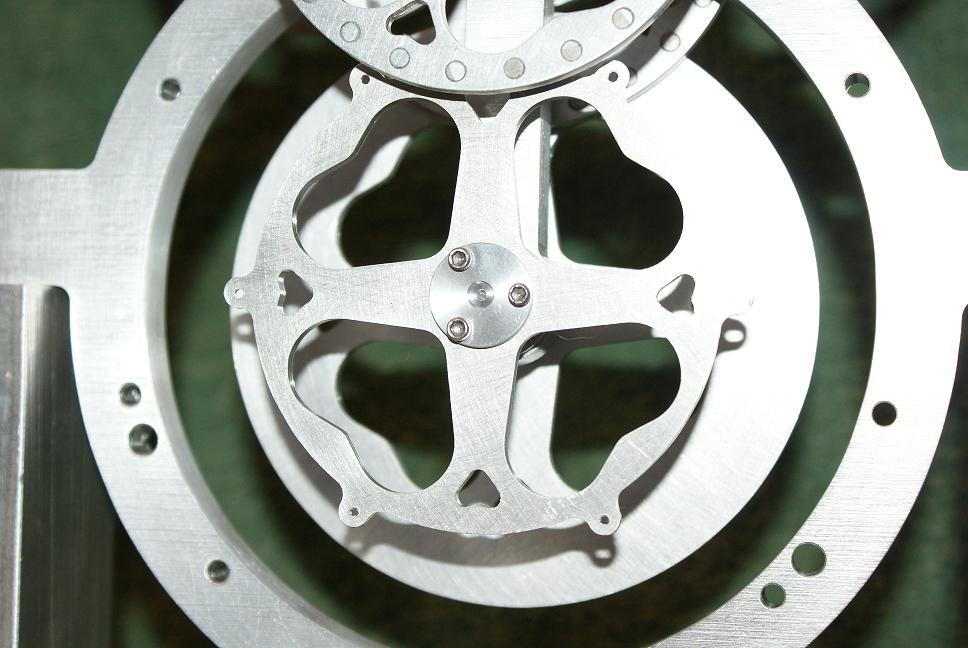

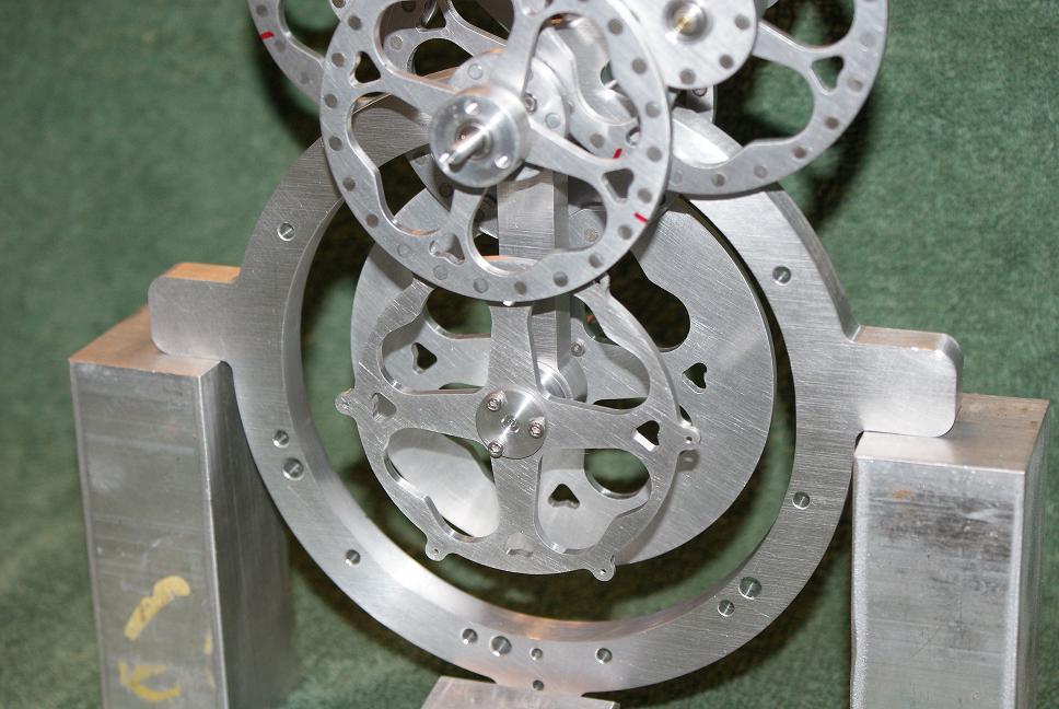

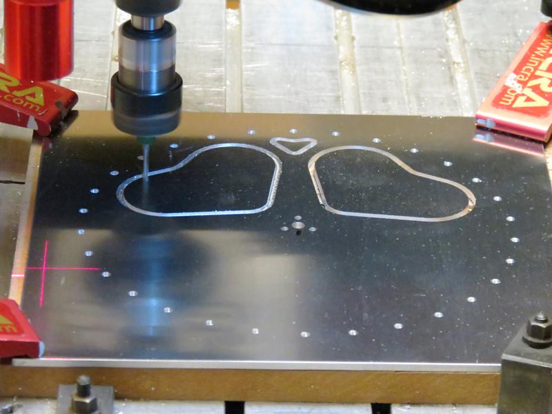

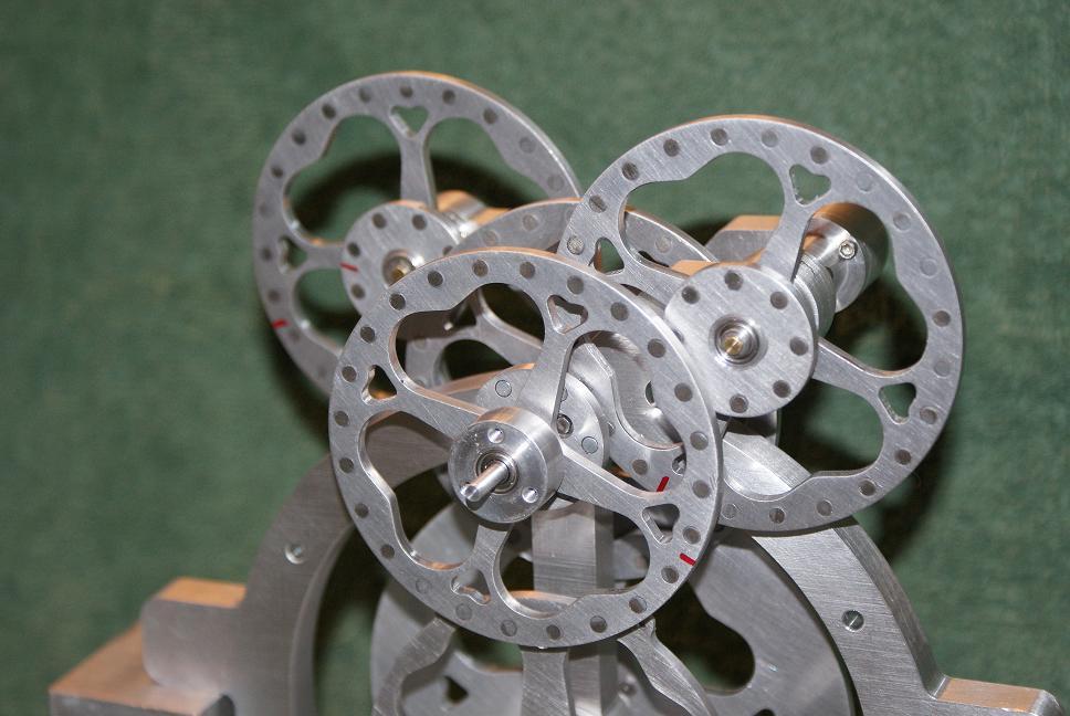

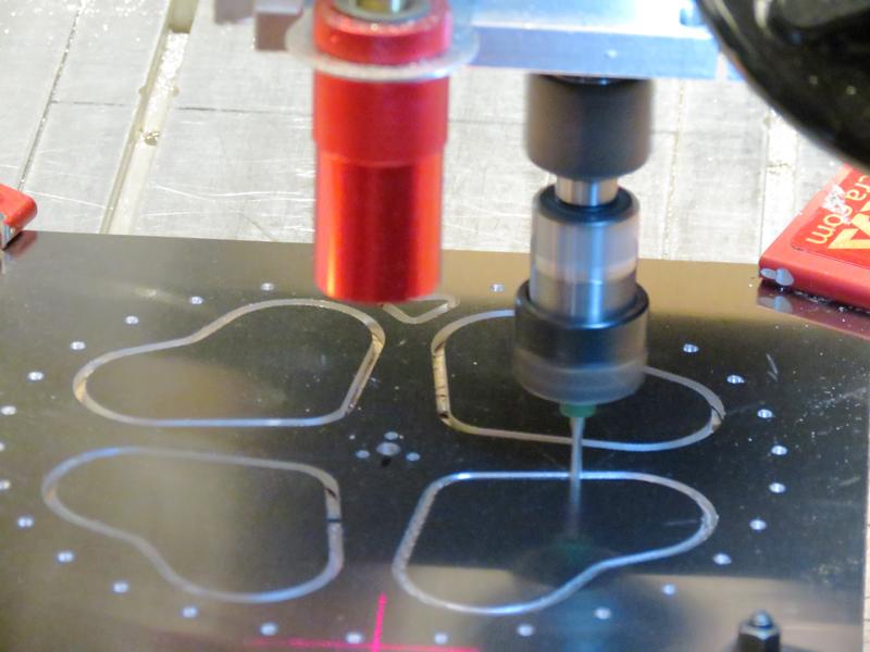

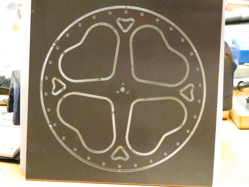

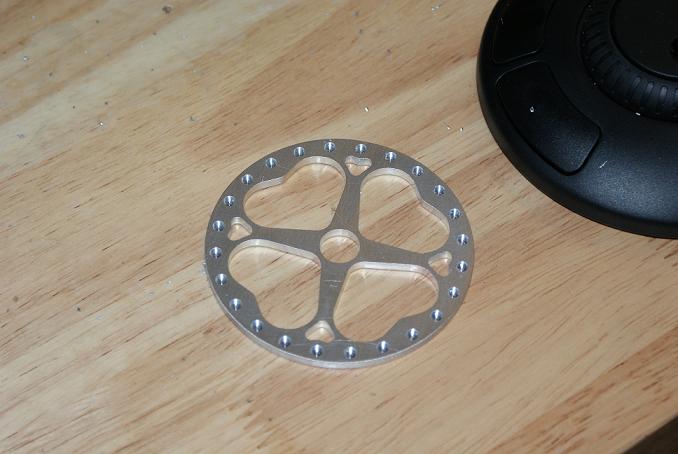

« Reply #13 on: October 25, 2012, 09:40:40 PM »
 :update: :update: :update:
Im all caught up with all the issues to date with the rotor being cut last night finished tonight :D. I can't wait till the next issue arrives.
As you will see in the photos I used the heart shape on the aluminum part but added lugs with half cuts to match the steel rotor. The lugs add a 3/16th  inch cutout between the two except at the lugs which I think adds more to look at.
The last photo is of the dampner disk. I spoke with Weston as to if the dampner needed to be solid and he advised that it should work but to make sure that the area where the maginets are be solid.
Here are a few photos
