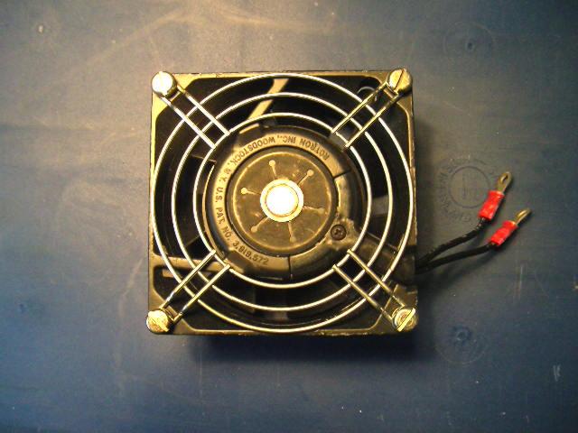

Right! .... This here cooling fan.
Here's the motor side view........
http://i110.photobucket.com/albums/n95/Dayjo/After%202012/P1020778.jpgMini Lathe Motor. Again.......
And the end......
http://i110.photobucket.com/albums/n95/Dayjo/After%202012/P1020780.jpgMini Lathe Motor. Again.......
The motor is 80mm dia.
So, I sawed meself a piece of 70mm square mdf. Seems it will be the best size to hang off the underside of the chip tray, and clear everything.
So, I ordered this one.......   http://www.ebay.co.uk/itm/280932791547?ssPageName=STRK:MEWNX:IT&_trksid=p3984.m1497.l2649
Found me a long redundant wall wart.......
http://i110.photobucket.com/albums/n95/Dayjo/After%202012/P1020782.jpgMini Lathe Motor. Again.......
Plugged it in, and attached it to a meter, to find which is + and -.
Noticed it was reading around 23volts, (50v scale). Is this normal?  :scratch:
Or, should I bin it, and buy new?
David,
Your wallwart is almost certainly unregulated and the output voltage will fall when loaded. You really need to connect the fan to the wallwart and then test the voltage. The fan is unlikely to draw 1.25A so I'd expect the voltage to be higher than 12v.
 You could always connect a resistor in series with the fan to drop the voltage a bit.

£1.78, with the shipping! Money's no object with you, is it?  :lol:
If it's got three leads, one of them will be for a tacho and can be cut off short, once you have established which it is. If it has a red and a black, those are probably the ones you want. Computer fans won't usually run in reverse, so try your + and - from the wall wart both ways. As the fan blows in one direction only, position it so it doesn't fight the motor's own fan when the motor is running forward, which will be most of the time.
My motor's fan was so weedy that I had to set up a smokescreen with my pipe to find the direction of the draught.

Well....... The fan arrived, "instantly"!  :bugeye:
It only took 20 hours from Middlesex. And, the seller had already posted feedback.  :thumbup:
Don't know about you lot. I never post for a seller, who can't say "thank you", for my payment received.
Anyroad! I wired the red and black wires to the wart, and it blew, (air), like a good un!
No need to start smoking, Andy!   :D
After an hour continuous, I decided it might just survive assembly.......  :thumbup:

« Reply #21 on: September 25, 2012, 01:11:59 PM »
Hmmmm...... Almost 4 weeks gone, and no obvious progress...... I'm watching paint dry, at the moment.
The motor set up has been tried over a couple of projects.
All has gone well. It's pulling like a train..... Double header!
I folded up a 70mm square duct, for the fan.......
http://i110.photobucket.com/albums/n95/Dayjo/After%202012/P1020806-1.jpgMini Lathe Motor. Again.......
"Nailed" it together with panel pins, between two pieces of wood........
http://i110.photobucket.com/albums/n95/Dayjo/After%202012/P1020807.jpgMini Lathe Motor. Again.......
And, soldered together......
http://i110.photobucket.com/albums/n95/Dayjo/After%202012/P1020808-1.jpgMini Lathe Motor. Again.......
Snipped off the excess lengths........
http://i110.photobucket.com/albums/n95/Dayjo/After%202012/P1020809-1.jpgMini Lathe Motor. Again.......
The fan's a nice sliding, stay in place fit........
http://i110.photobucket.com/albums/n95/Dayjo/After%202012/P1020812-1.jpgMini Lathe Motor. Again.......
Bunged up the lower gap with foam, glued inside.......
http://i110.photobucket.com/albums/n95/Dayjo/After%202012/P1020816.jpgMini Lathe Motor. Again.......
It locates, with magnets, a bit like this.......
http://i110.photobucket.com/albums/n95/Dayjo/After%202012/P1020856.jpgMini Lathe Motor. Again.......
And this..........
http://i110.photobucket.com/albums/n95/Dayjo/After%202012/P1020811-1.jpgMini Lathe Motor. Again.......
Andy was right about the wind direction...... There's a draught out of both ends, when the motor's running!  :scratch:
The motor fan is angled to draw from the pulley end. So, this addition is going to be an extractor fan........  :thumbup:
Awaiting some better, nimmydimmy magnets, and a quick wiring session. Then another rebuild will be completed!
Until next time.......
