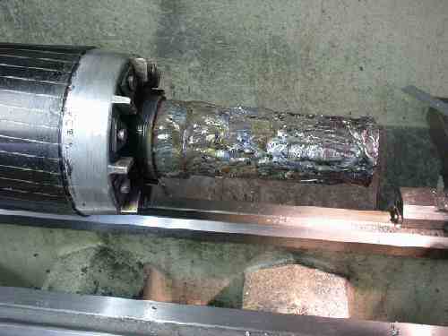

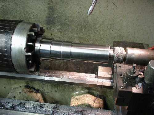

I'm not saying I make many mistakes but I get thru about three 15 Kilo reels of MiG wire a year  :scratch:
This is just on turning and milling jobs, no fabrication.
Before.
After.
JS.

John,
Did I understand that correctly, you built up the shaft dimeter with mig welding and then turned it down to size?
What's the weld like to turn?
Thanks
Darren

Re: Please yourself
« Reply #13 on: February 15, 2009, 08:36:40 AM »
MiG weld turn nice once you have an uninterrupted surface, because it's pure wire and gas there are no inclusions like you get from the flux on stick welding.
You can get different grades, some which can be heat treated but the standard common or garden stuff works well.
I always turn undersize before welding so the transition layer is under the final size as often you can get 'smear' marks where the two join.
This one was a bad one in that the bearing diameter and the shaft diameter were toast and you always have to juggle to get it running true again.
A good selection of steadies, both normal and cathead are needed and also a good rotary 4 jaw in the tailstock is handy.
JS.
Before.
After.
JS.
Hello John, can I ask you how you keep the weld heat from affecting the rotor windings...or perhaps it does not harm them?
