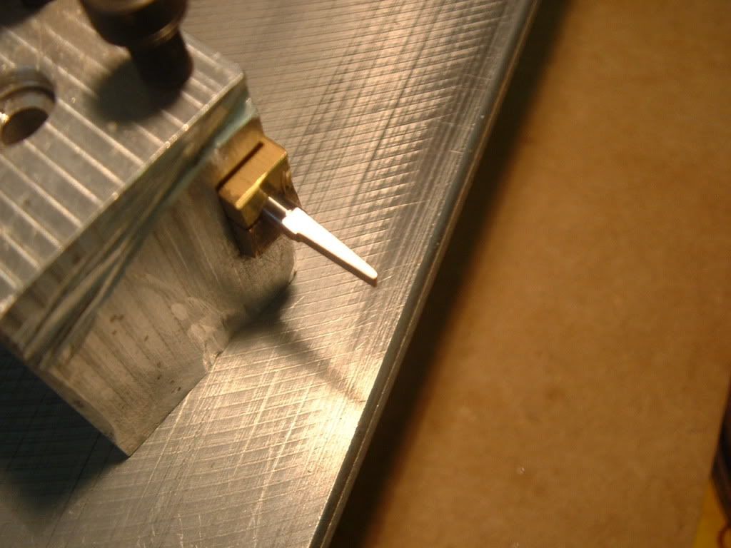

At present I hand grind 3mm dia Tungstencarbide bars into 1mm wide cutting tools for my lathe.

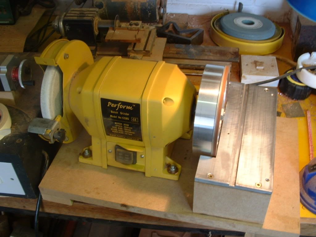

Ok Iv'e bitten the bullet and ordered a diamond wheel from arceuro.
Next problem The bore size of the wheel is 32mm and my grinder has a 12.7mm shaft.
Can't find an adapter on the net anywhere so I think I will have to turn one.
Should I use Alu or Brass or Nylon which would be best are there any rules for this?
Bernard

The wheel arrived today.
Got about mounting it on my little bench grinder.
Made up 2 stepped spacer rings to adapt from a 12.7 shaft to a 32mm hole. It sounds so easy when you say it quick, it took me over an hour of turning on my little sherline lathe.
Then after two cups of coffee set about getting it to run true, can honestly say is was a bitch. But after a few attempts and the wife saying what's wrong with your face ( nothing I'm thinking dear) I finaly got it.
Tried out a test run and Oh my god what a difference, it removes carbide like butter and what an edge.
A very happy Scotsman and all for 35 quid. Thank's to Trev for your advice it helped me a lot.
Below are a couple of pictures of the almost finished Grinder.
