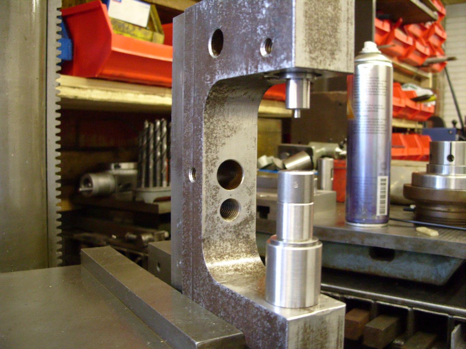

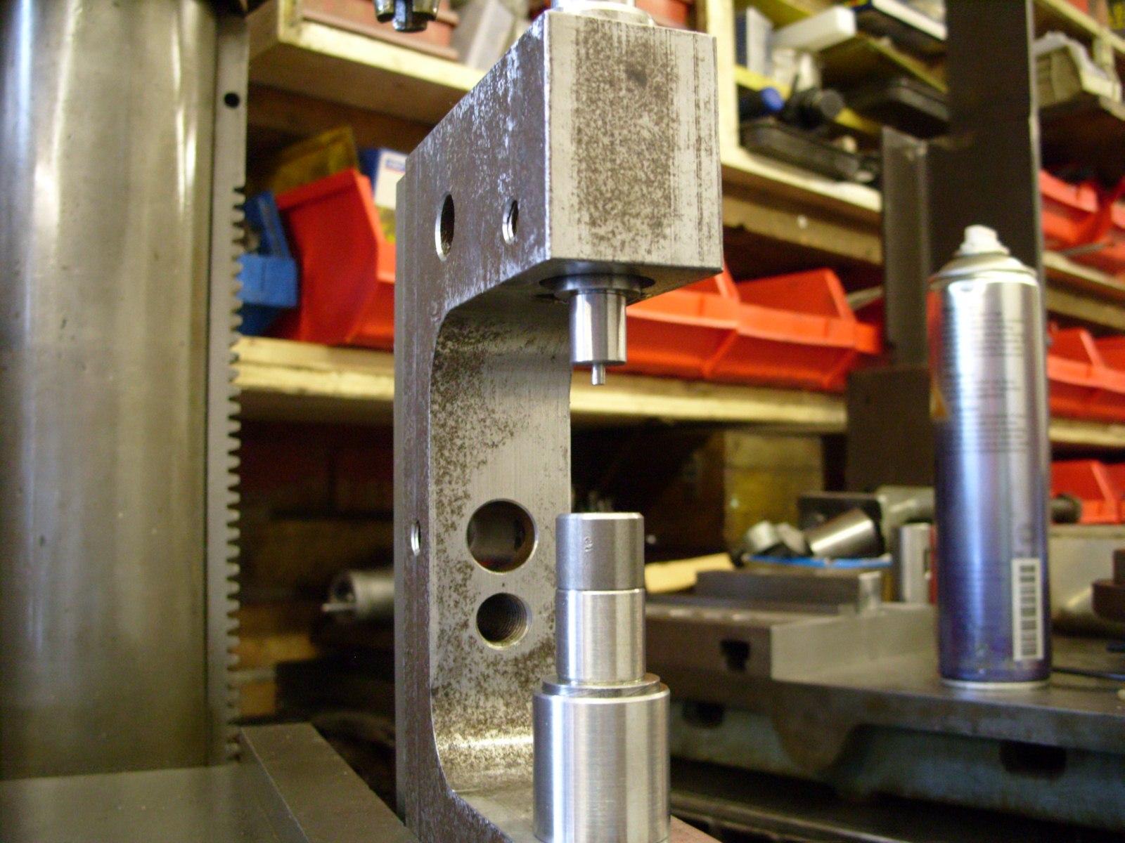

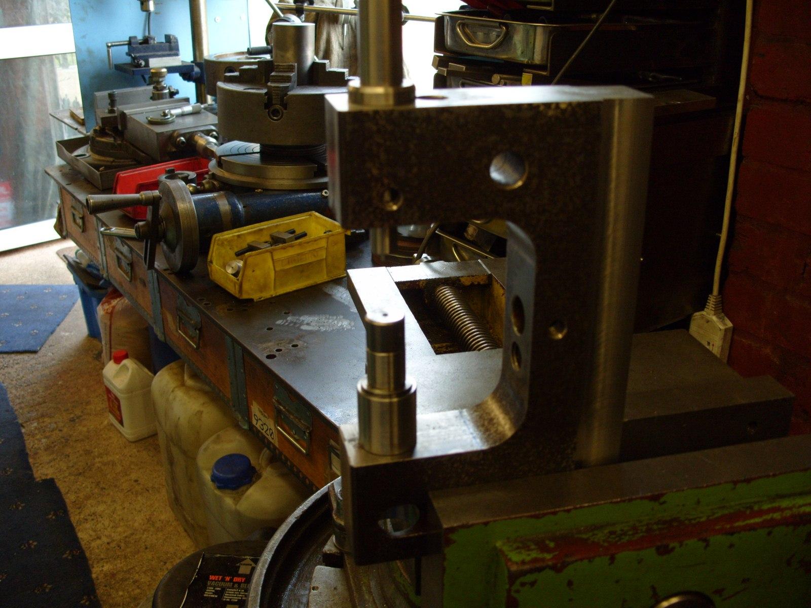

Hi All,
I had a need for some 3mm ID x 10mm OD x 0.005" brass shim washers a while ago, to personalise a centralising gauge.
So I used a few earlier prepared items, and produced some punch and die sets, I can only find the assembled frame photos, but it gives an idea.
The top was just whacked with a smallish hammer, but a decent sized pillar drill would do.
Chris
Sunny Scunny,
North Lincolnshire.
