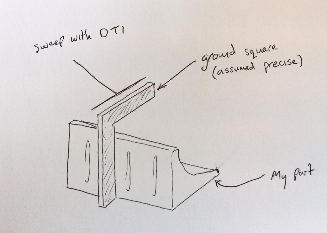

Hi folks,
Been sitting racking my brains about this one and I've come up with the following. I have a DIN-rated precision ground square, though it's only 4 or 5mm wide, I think I can use it as illustrated and sweep it with a DTI to check my part. Only tricky part is ensuring the square is sitting vertically but I think I can accomplish that with a 123 block (or another square!)
Pic attached, any thoughts?
Cheers,
Rich

2) I understand how to scrape a surface flat, but I'm struggling to decide how to scrape one surface of a right-angle jig such that it's perpendicular to the other. Is there a way I can do this with some clever setup of indicators, or do I need a right angle reference to blue off? If I make two at once does that help somehow? I have a height gauge, precision ground square and the usual assortment of accessories but I don't have any decent quality right angle plate to reference off.
When you say, precision ground square, does it have a knife-edge?  If so, there's a way to simplify things.  Scrape a small area on each end of your angle plate such that you get a no light fit between your surface plate and the square's edge.  Now you have reference surfaces to which you can work as you scrape that surface flat.  Your final check is that your second surface is flat to the surface plate and that it is square to the first surface.
I used to do a lot of work for the (American) National Bureau of Standards (before it was dismembered into the National Institute of Standards Technology -- and made a protector of intellectual property rather than a promulgator and enforcer of standards).  They had a set of (approximately) 6 inch diameter cylindrical squares used to check squareness by blowing air between them and the object to be tested.  The air flow rate between the cylindrical square and the test object was measured in very small (vertical) increments.  When the flow became constant over the mating distances, the item could be certified as square.  (I have obviously glossed over a number of issues in that summary.  The test specification was a seriously multi-hundred page document.)  That set-up could measure squareness within .0000002 inches/inch of height.
This will hopefully give you some ideas.  Good luck!

My 'precision ground square' is the type made from one solid piece of steel approx 4-5mm (ie quarter inch) thick, no knife edge, just ground on all sides. It's stamped with a DIN standard of some kind and I presume it's relatively square.
