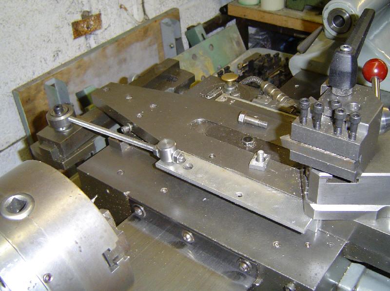

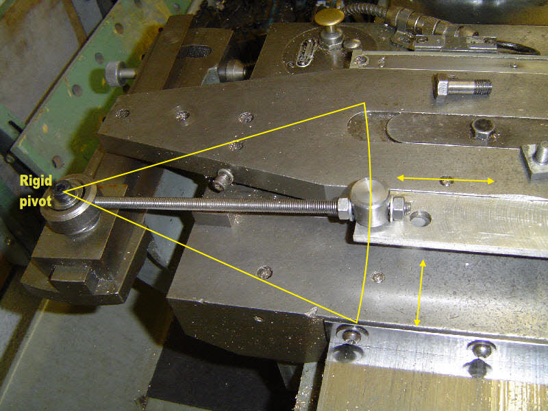

May not be suitable for your lathe but might provide some inspiration:
Re: How do i go about turning a crown on a idler wheel.
« Reply #7 on: July 08, 2012, 10:41:23 AM »
Now thats a clever use of a TTA Bill , my Myford one could be adapted very easily  to that setup .
I will remember that one .
