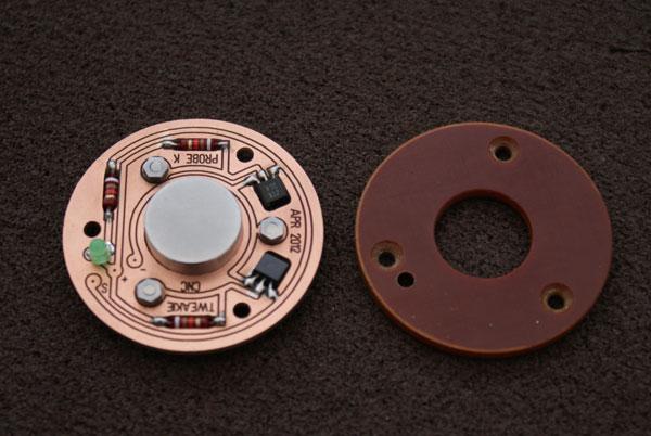

My existing ‘touch plate’ has served me well over the years but as this relies on electrical contact between the ‘tool’ and the ‘plate’ it was just not possible to use it with the diamond and ceramic tipped tools I now have occasion to use.
Something a bit more sophisticated was required and an active, ‘probe type’, low profile, tool height setter seemed to be on the cards.
This is my first prototype and as luck would have it, works just as intended. It is still work in progress, as testing is on-going, but so far so good.

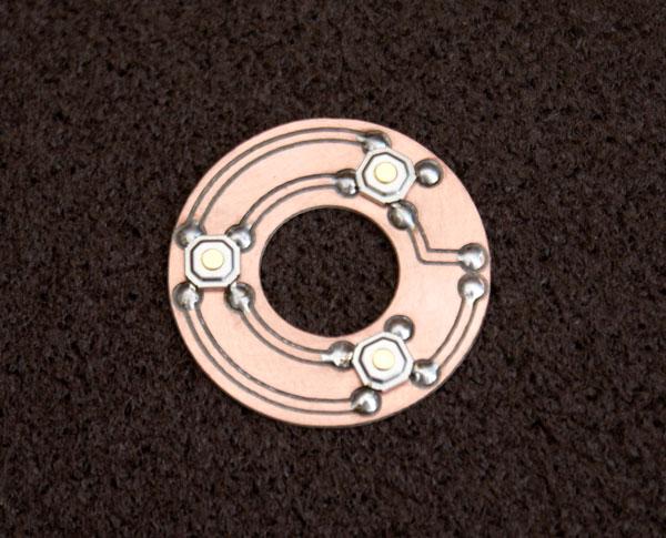

An internal contact ring rests on 3 contacts under spring pressure and the overall height of the completed probe entered into my probing script as ‘plate thickness’. Any downward movement of the plate breaks one or more contacts for the G31 detection. Although the contacts are ‘normally closed’, the transistors invert this logic so the probe output is normally a weak High and only taken to a strong Low (GND) when contact is broken.
The amount of movement necessary to operate the probe is incredibly small but it is largely dependant on the flexibility in the top cover and operational movement is currently smaller than two of my Z axis micro-steps. It does not seem to make any difference if the plate movement is parallel (centre contact) or tilted (off-centre contact) there is never any contact bounce – it either makes contact or it doesn’t.
This type of ‘contact-break’ detection is used in some of the Baumer Electric limit switches – OK they have far more accurate manufacturing facilities than I have but they claim 1 micron repeatability.
My Z axis only moves in steps of  0.001875mm (although the accuracy of micro steps is a long standing point of discussion).
Jogging downwards with the axis set at 0.0010mm step size and zeroing at the exact point of electrical contact a further 2 steps were required to trigger the probe with the Z axis DRO now reading  -0.0037mm.

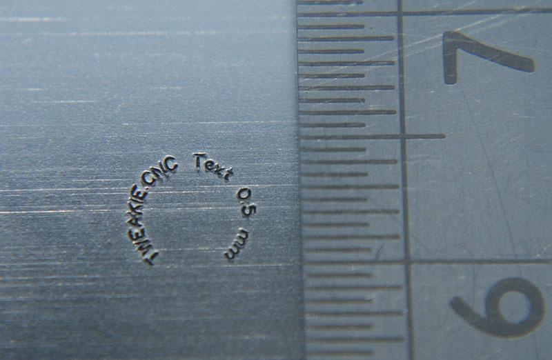

Of no practical purpose this 0.5mm text was engraved to a depth of 0.05mm just to see if it could be done.

Hmm. Looks good. Any chance of a photo of contacts/mechanics? How do they relate to those three screws wired to two transistors?

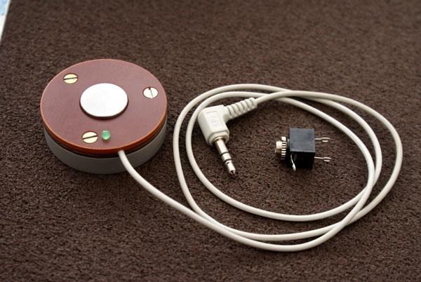

Once I have finalised the design and have completed a few more tests I will post the full constructional details, drawings etc. for those who wish to make this device (or something similar).
Here is a pic of the completed contact ring assembly and another of the machined parts.
Tweakie.

Yes, I have incorporated what I consider to be ‘fail safe’ characteristics but these are not totally 100% foolproof and I am sure could be improved upon in the light of experience and others suggestions.
Currently the probe is connected to the machine with a 3 core cable and miniature jack plug, there is no on/off switch and it is always active.
If either the Positive or Ground wires were cut (or the probe not connected at all) this is detected (at the breakout board end) and the probing script reports ‘probe already grounded’ and no Z axis movement will be made when operating the ‘auto tool zero’.
If the Sense wire is cut the script runs as normal but the contact plate then over travels onto one or more of 3 ‘over travel’ mechanical switches. This is sensed (at the breakout board end) and in turn, triggers an ‘immediate stop’ by activating a machine limit.
The over-travel switch feature, operating a machine limit was, I must admit, not part of my original design but has subsequently been added (as a result of a suggestion made on the Artsoft forum) to protect the tool from damage in the unlikely ? event that the G31 command (or associated probing script) goes wild.
My available ‘over travel’ distance is currently 2.0mm but this will be reduced to approximately 0.5mm (before the over travel switch is contacted) when the updated switch PCB is fitted.
As always, this is an ongoing project and I am learning as I go but so far so good.

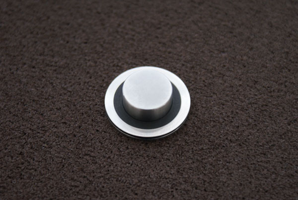

This is my 'over-travel' limit switch, well there are actually 3 of them but they are wired in parallel and operate on the 'first home' principle.
The total thickness, including the PCB is 2mm and it fits below the contact plate assembly in the base of the probe and operates a machine limit in the event that the G31 probing routine fails. That's the theory, only time will tell.

The wiring between the over travel switch and the main PCB had made the probe difficult to assemble / disassemble so the case has been re-designed to include a small pocket to accommodate a slightly longer loop of wire. This seems to have overcome the problem - so far so good.
The new case has been CNC machined, lightly sand blasted then hard anodized.
