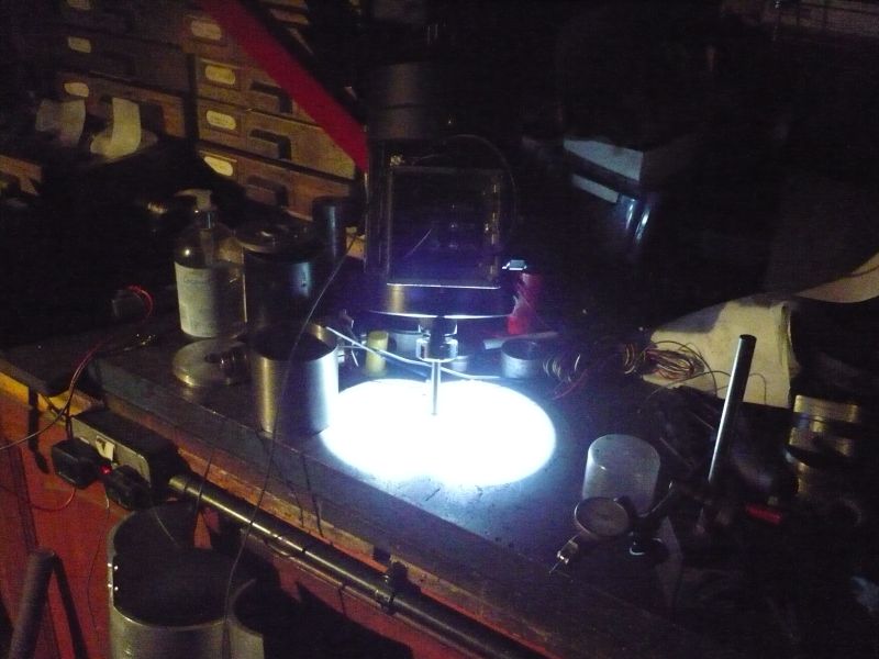

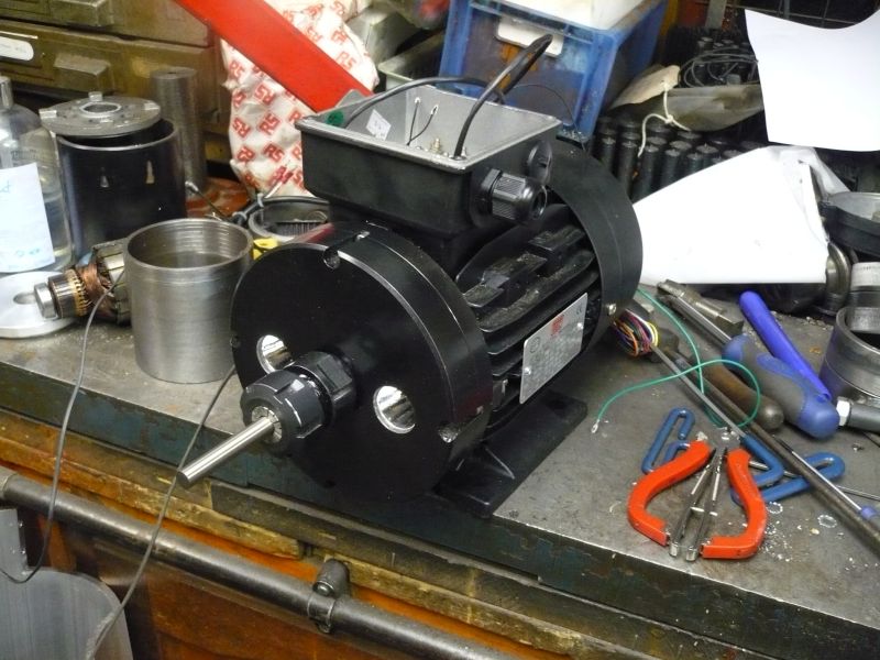

« Reply #9 on: May 27, 2012, 06:02:35 PM »
Peter, I have been using some Cree Q5 modules from deal extreme in China, very good to deal with.
http://www.dealextreme.com/p/cree-q5-led-drop-in-module-3-7v-18v-input-11621?item=108
These are complete units with inbuilt regulator and just require 3.7 to 18 volts but I have found that 5volts is just right, any more only generates more heat and no more light. I use an old Nokia wall wart at 5 volts
This is two of them built into the end of a special motor for a CNC.
And this is the light they throw out, in this case both were wired to the same 5v wall wart.
This was taken with no lights on in the workshop and they are not quite as bright as shown, the low light makes them look brighter but they are bright. good thing is they don't get hot at 5 volts and you can handle them after 4 or 5 hours with no problems.
John S.
