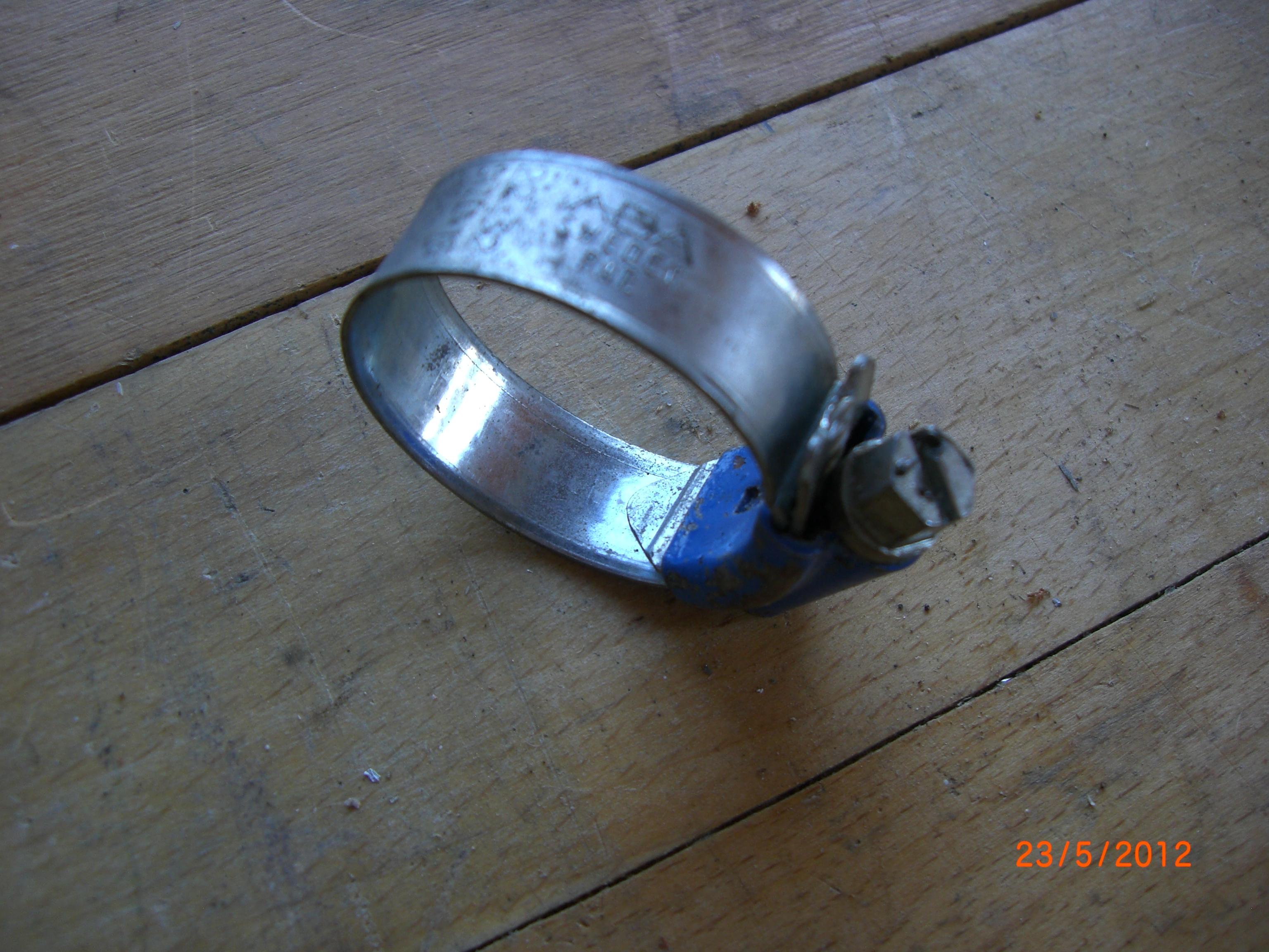

Maybe it's called 'clamps' in english ...
« on: May 23, 2012, 11:57:27 AM »
But I know why these ware invented - see the attached piture !
It simply takes too long time to make one with one of these:
http://kelds.weebly.com/3/category/spaendeband72efd893aa/1.html
let Google do the translation for you !
For 'bigger' clamps I think it's a good idea.

Yeah, that video is showing an example with - I think solder tin -  notice she turns and lock it on top of the tools with her fingers !
Let's see an example with 1mm steinless steel - and try turn THAN with your fingers ! :Doh:
But I'll try add that extra smaller pin in the nose and as I said it's good for big clamps.

Here is my version...
IMGP9634 by MrJohnHill, on Flickr
......those are inches on the rule.
Here is my effort with some really hard 12gauge fence wire, it is really awful stuff to try to do anything with (except build fences of course).  I think the baling wire would be a real cinch with a tool of this size.

Mine are nearly that size too - AND I have added the extra pin at the tip now.
I notice, that you "only" made a "single" clamp with the fence wire - that did halfen (or more) the time spend, I think.
Notice, I'm not saying it can't be done - I'm just saying it takes too long time !
And I sure there ARE cases where a clamp like this IS the best - maybe the only - solution to the problem.
I just expented more from the tool.

I think the tool is a good idea and I would like to improve mine so I could use it more than I do.
It is very good for those occasions when you do not have a clamp, when you want the clamp to be 'tidy' and not catch on things, when you want to clamp something of big diameter.
I would like to improve mine to better hold the end of the wire so that so much wire does not need to be wrapped around the tool.
