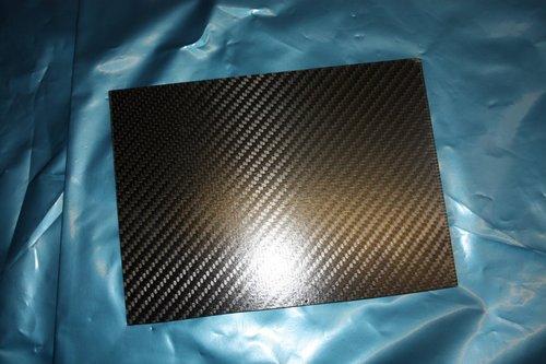

Hi guys, I've been thinking about the carbon fiber print-plate idea and started wondering about G-10 Garolite (think old circuit boards).  It's rated at 265F (130C) and about a 10th the price of carbon fiber.  Anyone have any experience with it?

is that the same as Paxolin ?
Peter
Re: Building a 3D Printer, RepRap Mendel Prusa2 by craynerd
« Reply #78 on: July 10, 2012, 08:24:51 AM »
Peter, I think it's the same general type of stuff as Paxolin, but Tufnol might be a closer British equivalent. Tufnol comes in various grades as resin-bonded paper, cloth or glass fibre. I don't know if Garolite comes in these different varieties.

I think it's same stuff, also heard it called reinforced bakelite.  Several different varieties (paper, cloth, etc.), it all gets a bit confusing after a while.   :scratch:   From the very little experience I've had with it it seems like it should resist warping under the heated bed.  At $25 for a foot square sheet of 1/4" I may just give it a try when I move to a heated bed.

Jeff, would certainly be worth doing, although in comparison, how much is carbon fibre 2mm sheet?

Hi Chris, McMaster-Carr doesn't list metric thicknesses but 1/16" (1.58mm) is $57 and 1/8" (3mm) is $95 a sheet.  If I drop the thickness from 1/4" (6mm) to 1/8" (3mm) the Garolite price drops to $15.50.  Do you think 2 or 3mm would be thick enough?

Only my opinion, but I think 3mm would be well thick enough. As long as it is rigid, it isn`t under any force! The heat beds weight is next to nothing and it is only function is supporting the heatbed and I suppose having the linear bearing holders screwed to it to run on the rods.  I`d go as far to say that the thinner you can get away with the better - lower weight = faster acceleration for the bed.
I saw a MendelMax with a thin aluminium bed and that was far too heavy. 3mm carbon fibre could be a good one for sure!

Chris - My thought was that the 6mm might resist warping better, but I tend to way over engineer things. :loco:  I think when the time comes I'll try the 3mm.  Thanks.  :thumbup:
