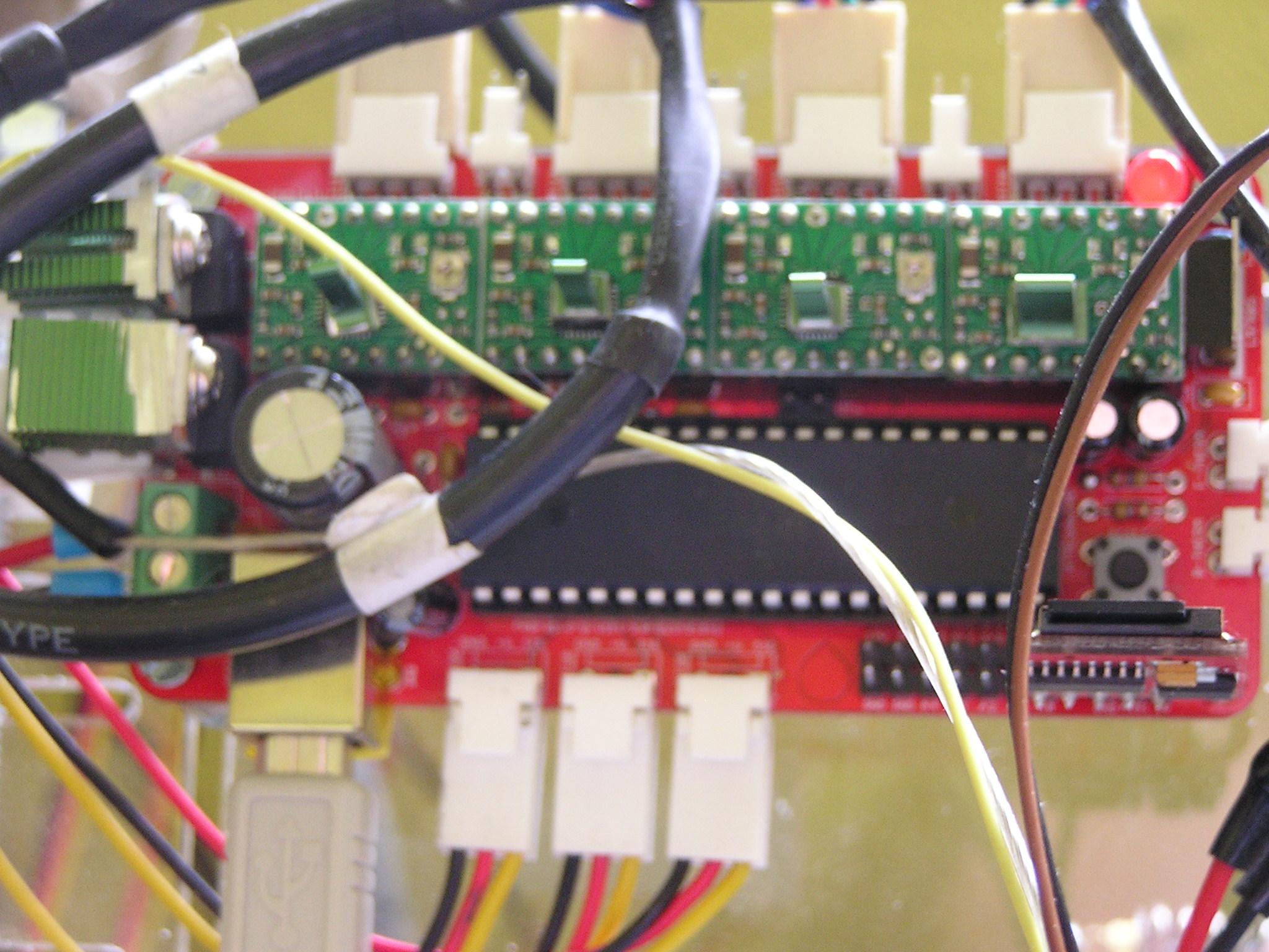

The next stage for my 3D printer build is the electronics to control it.
The Reprap Commuity has designd and built it's own electronics for a while now.
I Chose a brand new offering from a guy in Holand. The electronics is named Gen 6
Can I use a mill control board ?
Probably, but we also need to control 2 heating elements and 3 end stops.
It also needs to be compatible with RepRap software.
The electronics were installed and powered up late one Friday evening. The magic somoke stayed contained :)
I loaded up some software (repsnapper) and it (to my total amazement) moved under it's own power with nothing nasty happening.
Calibrating the movement took a while. Move an axis 100 mm and measure tha actual travel.
Adjust the motor steps per mm in firmware and uplaod it to the Board. Rinse and repeat.

« Reply #16 on: May 05, 2012, 10:07:46 AM »
Part 4
Electronics and Software.
Once you have your hardware together you can start to make it move and do stuff.
The Reprap printers are Belt driven from stepper motors (X & Y) and a pair of lead screws for Z.
T5 Belts have been superceeded by T2.5 belts.
We use NEMA 17 Motors. Must have Good Holding torque.
Something like SY42STH47-1684B  from Zapp Automation in the UK are ideal.
DO NOT scrimp on the X, Y and Extruder stepper motors. You can howeve use lower power motors for the Z.
The RepRap Community (and others) have developed their own electronics and it is a minefiled out there.
Most RepRap stuff is based around the AT Mega chips and Arduino boards. i'll try and summerise the options here.
Gen3: Obsolite and will not work with current firmware.
Gen3+: Obsolite but will (with some work) Work with current firmware.
All the Gen 3 Series requires separate Motor Drives and End Stop Boards.
Gen 4 and 5 never took off.
Gen 6: developed by Mendel-parts.com is a really nice attempt at a 1 board solution.
It's stepper drives will only do 1/8 stepping. This makes your printer noisy as hell.
It has no Heated Bed support.
Current Firmware will run with some work.
I have one of these boards gathering dust, it's simply far far to noisy.
Gen7: A well respected low cost and full featured DIY solution. Well worth looking at but still being developed.
RAMPS: The most popular current electronics. It's a shield that plugs into an Arduino Mega board.
Works with all current software and Firmware.
Uses 4 separate 1/16 stepping Polulu Drivers
Has support for 3 end stops, 2 Heaters (Nozzle + Bed) and 1 fan.
A very good choice.
Sanguinolulu: My Preferred Choice.
Missing the Fan controller that RAMPS Has. That's about all.
It's a stand alone 1 board solution.
Easy PTH Soldering (except for the FTDI chip).
Image attached from my Reprap mendel.
There are Other Electronics solutions out there that may or may not perfom well. I have not seen used or tested anyning not in this list so am unable to pass comment.
