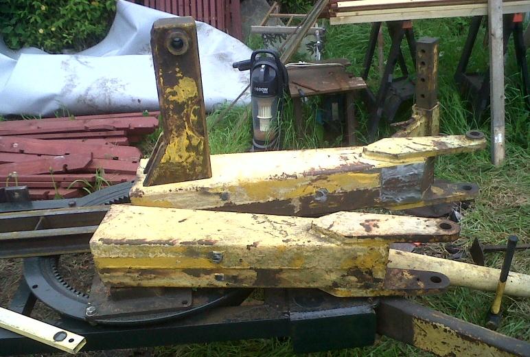

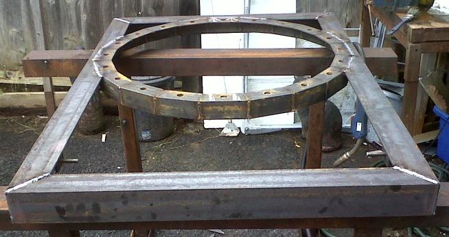

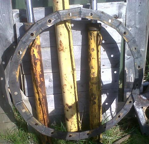

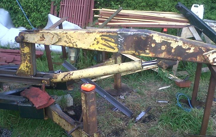

Been a little quiet lately however I have not been totally idle.

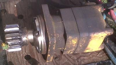

A while ago I purchased a smalley 5 towable digger which was modified for severn trent to use for clearing weeds from the rivers etc. This meant it was almost useless for doing the jobs I needed to do with it but it was cheap so whatever.
Anyway I got around to dismantling it and am now starting on rebuilding it to make it more useful to me.

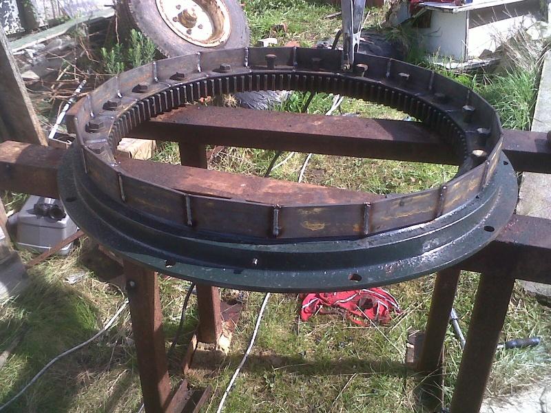

so today (in between rain showers and hail) I welded the mounting for the slew ring.
sorry for the massive pictures now been altered

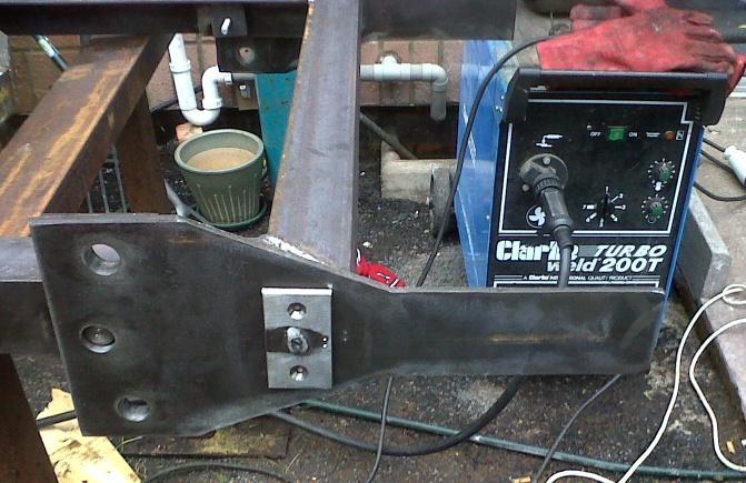

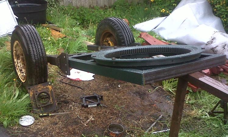

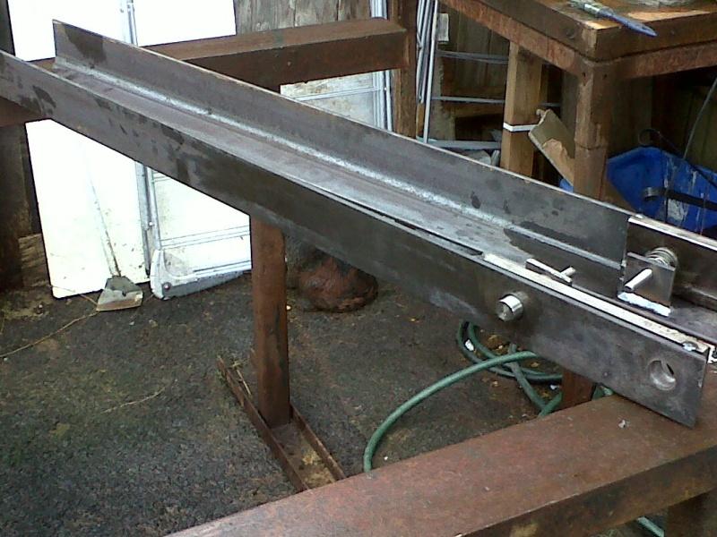

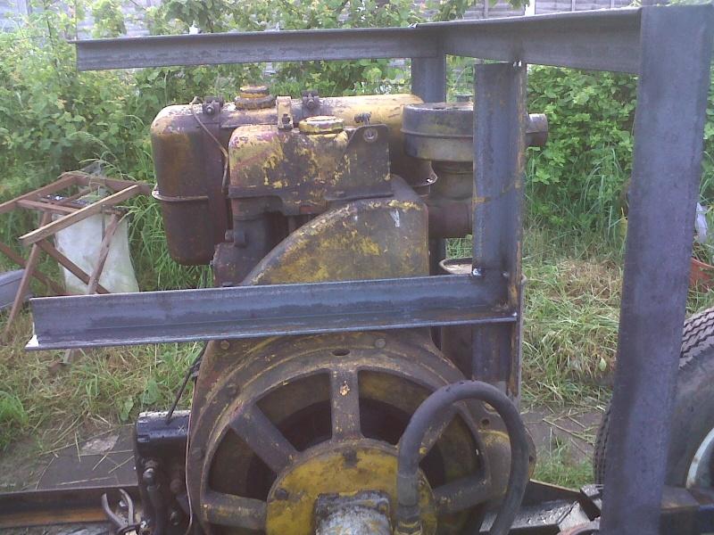

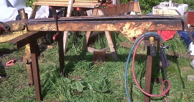

Managed to dodge the showers and get a bit more done today,
started with the base sides (pic 1) which I had put two stop pins (pic 2) and the slew ring base I did last week and made them into the main base (pic 3). This just needs a final support for the back of the slew ring base and then cleaning up and painting and I can bolt the slew ring to it and get started on the more interesting stuff. I still have to work out how the out riggers on the front are going to fit to this base but that should not be a major headache. I really should get it all done before painting but if I do that I will start using it and it will never get painted.
The final pic shows a bit of the adjustable rear axle in place which I am praying to the god of rain I will be able to get done tomorrow.

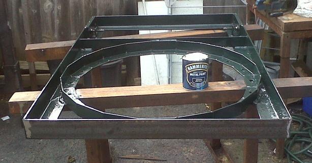

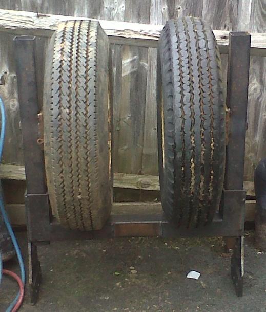

Got a decent bit done today. Did some more work on the adjustable axle to the point of getting the wheels mounted.
Although I got the one wheel welded on the wrong way around  :Doh: which will require a strip down to put the brake the right way around now.
when I first started building this one of my first thoughts was to make it able to roll out of a gateway so pic 1 shows the wheels how they will be to get in and out of a garden gate during normal use they will be the other way around. I am planning to put two 16mm pins in each side to hold the wheel assemblies into the axle but I will wait until I have it on the wheels and front supports to drill the holes for those.
I also added the rear slew ring support and painted the base too (pic 2) tomorrow I will bolt the slew ring itself to this.

Ok so now its starting to come together. I have the outriggers on and its standing on its own two wheels and feet. It now has the first ram in place too connected to the first section of the turret, I also got the jib? (never know which bit is which so I made my own mind up about them and I think it goes boom-jib-bucket please feel free to put me right) cut down to size this is the origional from the digger but cut down by just over a metre and I have flame cut it to a slimmer size, will weld it tomorrow.

I am at a stage now where it is a lot of preperation and few showable results. cut the main pivot from the old machine modified it and its now ready to fit once I have completed the boom which is shown in its two halves but I need to square up the two ends I have cut with the grinder, I am thinking it may be easier to take them to work and do this on the bandsaw but I will see how i feel tomorrow.
the biggest bit very near broke my leg was heaving it up and I slipped, fell and let go of it and it went over luckily though there was another bit of the boom very close and it landed on that rather than my leg

Not so sure about renting it out I can imagine there would be lots of things to go wrong there, mainly getting sued if someone ends up killing or injuring themselves or others while using it and I am sure the insurance for such would be pricey.
anyway I decided to carry on today got the ends squared up and started to weld the two halves together ..... and ran out of gas :Doh:
so took some time to clean up the rams and its a good job I had a spare because the one is really badly pitted.

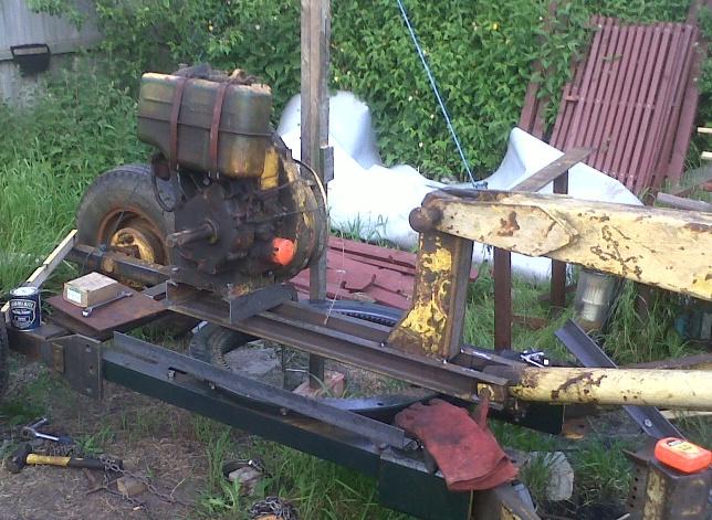

first ram in place and engine on
*end silly major tom tune*

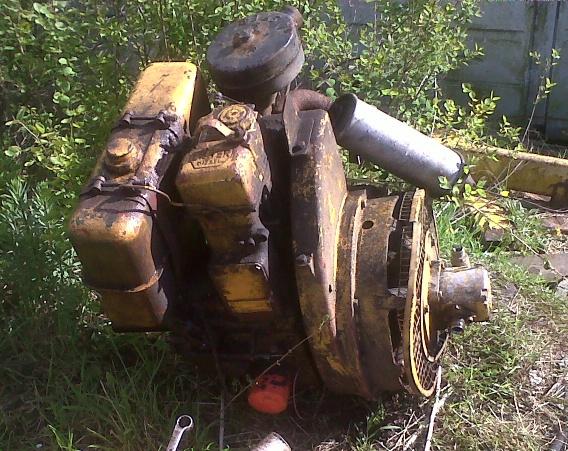

but as it says I have managed to get the first ram in place and the engine onto the digger now (even got it running it for a few seconds (well you just have to dont you  :D )) I havent welded the mounts properly yet I want to make sure it is in just the right place before i do that.
still have lots of work to do but getting excited about using it now.  :ddb:

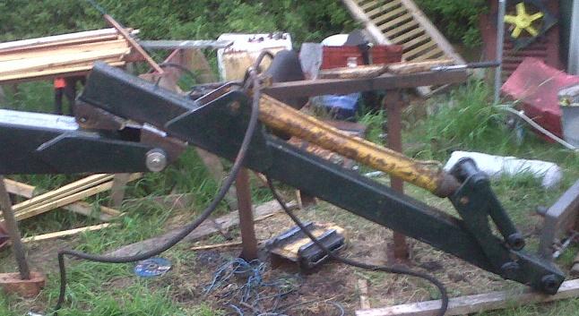

After yesterdays constant drizzle had a nice dry day today (although had to weld with wet gloves I forgot to bring them in last time I used them).
Today I got the jib welded on and the bucket ram but to be fair didnt have to do anything but fit that as I left that all in place when I made it less bulky. If tomorrow stays good I should have the actual arms finished and done and be ready for piping it all up.
I really should pay some attention to the engine cosmetic wise but I really need to get it running soon so cant justify the time maybe after I have finished using it. I did do a engine flush and oil/filter change (the only oil filter I could get to fit was massive compared to the old one but no matter it will be covered anyway) and have a new air filter on order.

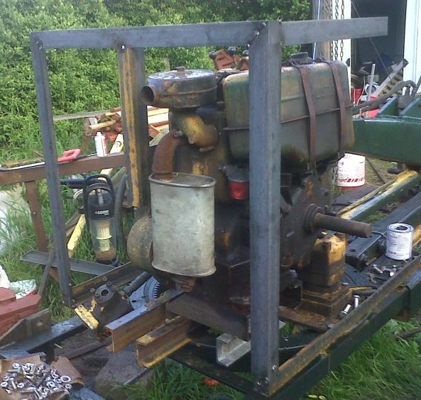

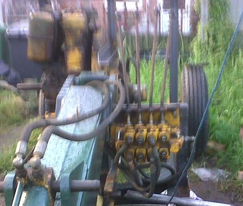

On holiday for rest of week so getting more done.
had to dodge some showers but started on the frame work for the body and mounted the control levers even got a few pipes worked out.

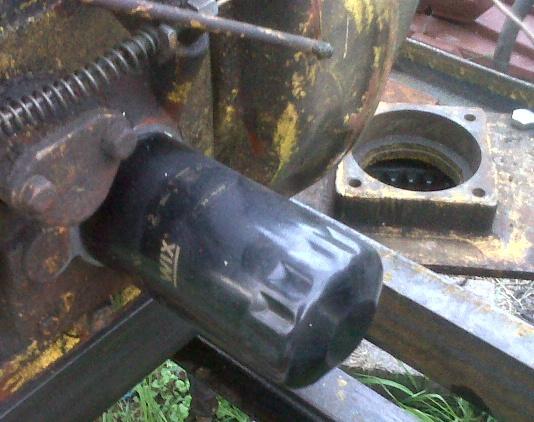

hi its cumming a long I'm i have concerns with the oil filter  you say its not the same as the old one you do no that their fitted with presher relief valve the valve is their too keep the oil flowing threw the engine ie if the filter gets blocked or the oil is to thick to run threw the filter the valve will open to let the oil run threw if the presher is to open the valve is more than the engine oil pump can deliver you may starve the engine of oil  befor the oil gets up to tempricher to run thruw the filter
Offline shipto
  • Posts: 867
  • Redditch, UK
Re: Digger
« Reply #20 on: June 07, 2012, 11:05:59 AM »
I didnt know that but it sounds right. the guy told me it was a compatible filter despite the size difference.
I am not sure if you can add a gauge to a lister sr1 easily but it may be a good idea and as lister seemed to make their engines for almost every purpose I bet there will be a easy way to add one, will have to check the pdf manual.
since it has been flushed and has fresh oil I doubt it would be a problem for a good few hours though.

I'm pretty sure most of the older Listers (like the SR1) will cheerfully run for hours with sod all in the sump, they are built like tanks.

Hi Shipto, As krv3000 said be very careful about having the correct filter fitted. When I worked for SLD pumps we had a batch of filters for these delivered with incorrect pressure relief valve setting. Engines were running ok for a while until they started running on the sump oil. Their demise was smelly,smokey,spectacular and rapid !! As Adev commented they are fairly well built but do need looking after. I had a TS3 brought in from site "it just stopped working", it had worked all morning to pump out the dig and then been stopped for oil check  at lunchtime and seemed alright, they started it after lunch and all was ok,stopped it mid afternoon to refuel ready for pumping overnight. When they went to start it before leaving site it was locked solid, my fitter unscrewed the oil filler caps on the heads to find what he thought was carbonised oil crust so brought it back in for inspection. When we finally got a head off we found that someone on site had very carefully poured hot asphalt into the engine,fine while the engine was hot and running but not when allowed to cool ! Amazing what some people will do . Total scrap.

I think to err on the safe side i will do another oil and filter change after I have leveled the ground but this time will order filter offline.

SO CLOSE!
got the framework finished today and its all piped up, in fact the only thing stopping it from running is the hydraulic oil tank which has not been made yet. I have shown where it will be placed in the second pic right behind the operators (me) seat.
still a few little bits to finish some of which have to wait until it can lift itself high enough for me to brace it and get under it and of course panel it all in nice and tidy.

ok got the tank finished, painted and mounted and I am please to declare ITS ALIVE!
hopefully get a video tomorrow but I have a slight leak from the slew motor  :bang: so that going to need some new seals (if I can get them)

It went a bit wrong  :zap: it turns out the machine is capable of lifting way more weight than the base can handle which is going to force a rethink and modification. It was all fine when I was lifting buckets of dirt but then I lifted a big concrete cloths line post along with its big block of support material. slewed the machine around and the base frame started to buckle (pictured).
So to solve this little problem I am going to cut the base frame down a bit and get rid of the adjustable rear axle and have it fixed in place. as well as doing this I am going to weld plates along the sides and just sure everything up in general.
