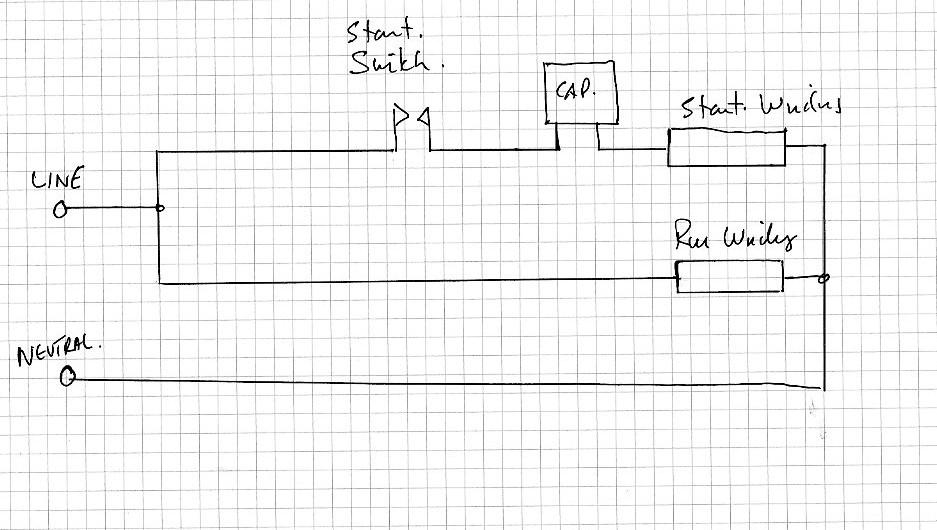

Send a piccy .... if you can.
There should be 2 connections to the start capacitor .. :thumbup:
Do you want a generic diagram of a 1 ph cap start motor ??
Simple enough ..
The 'cap / switch / start winding' may be in any order, just a series circuit.

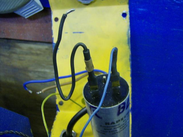

Hi bluechip yep i will post sum pics as soon as i can i no nothing regarding the black art of electrics the switch was faulty when i got the lath so i put a septet on off switch to the feed in will post pics tomorrow thanks for the help
Re: lathe gone bang
« Reply #5 on: April 17, 2012, 05:52:39 PM »

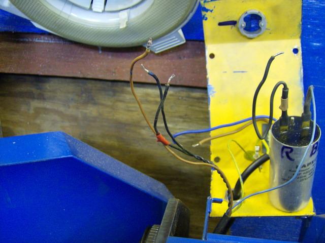

HI all all is not lost with the aide of bluechip have got the lathe ruining well sort of it needs a new capacitor i can only get it to run foreword no revers I'm go wing to whip the motor of and get it checked out right sum pics the way i have wired it up is brawn is live so live to the motor and capacitor and the black with the red tag on it to blue which is nutrel and with a spin on the puly wheel its of and ruining

Hi all thanks to all that has helped bluechip if i post a pic of the way its wired up to run will you be able to confirm that i have dun it right i have bin in touch with emco and got sum prises of parts the motor with condenser is £240 the switch is £60 with vat and post it all cums to £398.40  :jaw: :jaw: :jaw:

Bob
You need to find out what's gone pop ..
Get someone to meter the motor out, no point lashing out loads of shekels if you have no need to.
If a motor won't start, but runs after a quick flick, it may well be that the start winding is shot. But other, cheaper, things can be wrong.
ie, start switch crudded up and not making contact. Cap gone open cct. Sometimes the start switch assy. gets corroded.
Have a damn good shufti at any rivetted connections on it.
As you have the motor running, can you hear a click as it nears stopping. This is the Start Switch dropping back to the closed position.

HI no problem the switch fitted is brand new i got three and have tried all three the cap that's in the pic is us and the cap i have it ruining off is the wrong type I'm striping the motor off for testing its only held on by 4 nuts and getting a new cap from rs
Re: lathe gone bang
« Reply #9 on: April 19, 2012, 07:11:30 PM »
ITS A LIVE   :ddb:   I got a new capacitor today from rs and it runs as it did before I have just wired it up on a separate switch so at present no revers   thanks to all that has helped  I'm in you det

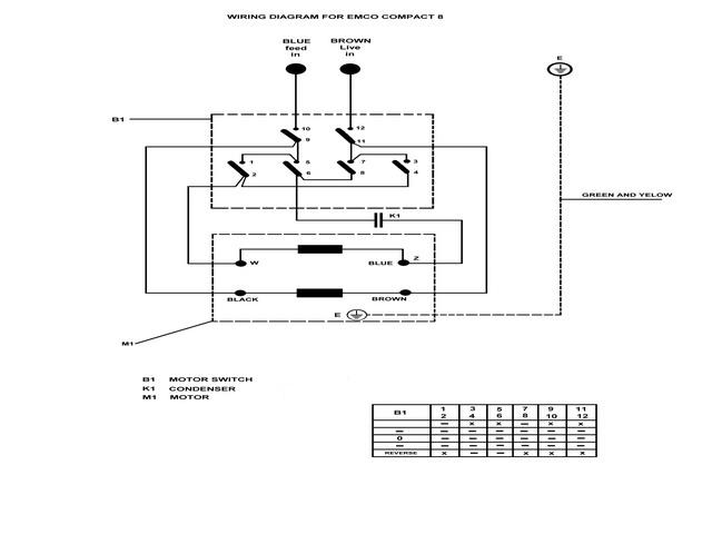

hi just a up date the lathe has bin run for most of to day with out any problems her is the diagram i got of emco for wiring
