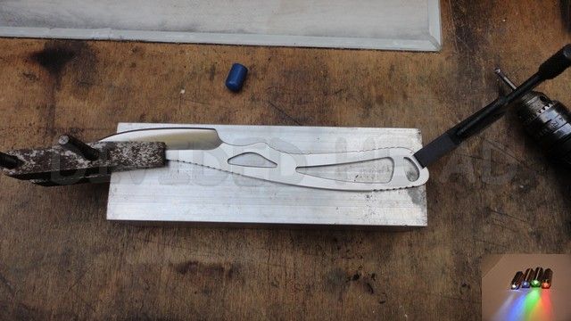

This is fine but I decided to make it easy to find in the dark,
Clamped to a piece of ali box section.
I then traced around the inside of the cutouts with a 3mm round carbide burr. This created an indent approx mid depth of the cutout.
Leaving a nice ghost behind  :dremel:

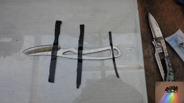

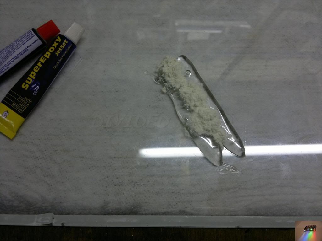

I decided to use my glass plate to pour on. But since this epoxy resin sticks so well to the plate it actually removes glass when you chip it off! I smeared a bit of Vaseline on the glass under the knife itself. Then firmly ductaped it into position

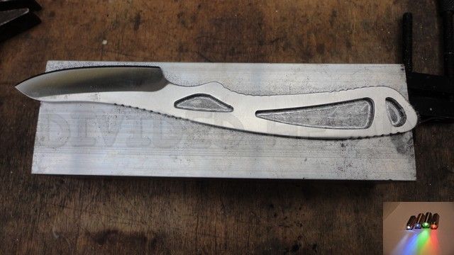

I mixed up a quantity of clear epoxy resin and GID powder and spooned it into the cavities with the scraper, Then chased around the edges with a pick to make sure it contacted all the sides. (archive pic' just to help visualise! Hence size diff')
The resin was then trimmed off with a long flexible blade smeared with Vaseline. This was a 5 min' resin and set probably faster than that... It was tough to cut off, a sawing action was needed and without the Vaseline I don't think it'd have been too easy cause it was still tacky.

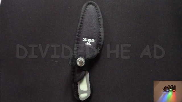

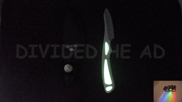

The completed knife....

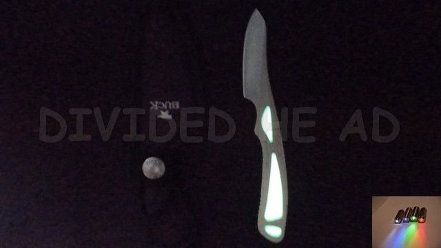

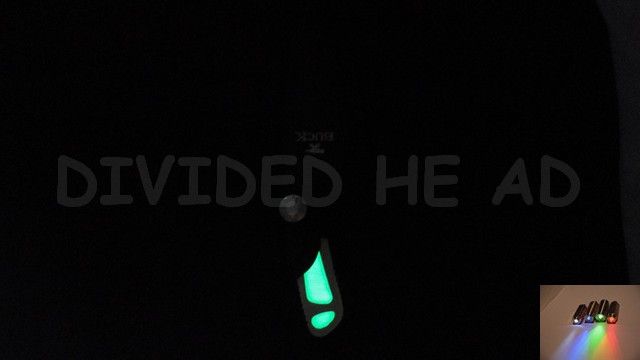

And in the dark... After the initial charge it glows eerily for 8-10hrs  :)
And that was that... Probably took no more than 30min's and it was pretty much cured in a further 10min's too!
