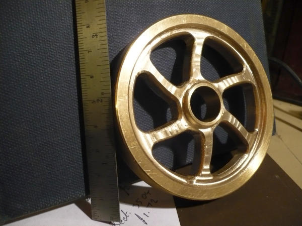

Don't bother with VCarve pro code, it's the same as Cut2D, to go full 3D you need either Aspire [ spendy] or Cut3D.
I did a flywheel as a test to see how fast I could get from thought thru drawing to CAM and then cut it [ 47 minutes but I had to do the design twice as I programmed up for a size of bar I didn't have  :( ]
I used a corner rounding cutter just to trim it up.
Ignore the hole in the middle it was already in the blank.
Now if you milled the bulk of the wheel out, did a goround with a tapered cutter then a rounding cutter you would have the same as a 3D generated one in less time.
3D programs are looooooooooooong.

Thanks for that John,
Aspire is well beyond my pocket. I'll have to save up for Cut3d methinks. Have you tried any other affordable 3d CAM packages?
I modelled the wheel in ViaCad which is a: very affordable and b: very easy to use - did you ever get to try it? A pity they don't do a matching CAM package.
I'd wondered about going round the spokes with a rounding cutter but I could only do that in 2d and all the cutters I have are too big to get anywhere near the corners where the spoke meets the rim.
