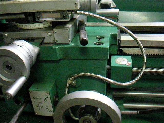

For the lock on the carriage, Make a new one up with a handle like I did in the picture below. You can either machine it up and thread it to suit, or do as I did and plug weld a turned and drilled piece of scrap on the end of the bolt for the handle to screw into.

I don't plan to put the bolts underneath. The adjusting slots will go in the tailstock and the base will be drilled and tapped. I use the tailstock a lot but rarely (as in maybe once a year) offset it to cut a taper. What I need is that it be centered and stay that way. The tongue and groove on mine isn't as snug as your's but it is tight enough to align to the base. When I opened the crate the tailstock was in pieces and it got a good cleaning before reassembly.
