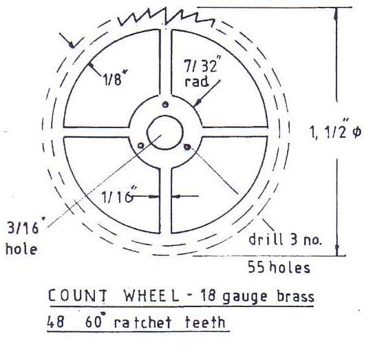

  • Posts: 2913
Re: Aluminium CNC build (TEP mill converted) by Craynerd
« Reply #30 on: April 09, 2012, 05:52:31 AM »
Phil - Metal is next before I stop any more tests and finish the machine properly -stops etc....
I expect this is probably asking too much, but I`m very much learning CAD and I`m getting OK now for more obvious parts. I know this is only a practice, but I`d love to make a part I want. Could any draw this up for me to scale in a dfx file? However, i want it modifying...I want all the little teeth with only a 3/64" instead of a 1/8" line to the centre. In an ideal world, the hypotenus would then come up at a corrected angle to meet the tip of the next toot, but it actually doesn`t have to..there could be little flats between each tooth. The one deep tooth, at the top of the drawing, would than be 1/8". So basically, the wheel exactly how it is in all dimensions but I want smaller teeth and the one deeper tooth can be like the "standard" 1/16 on the original plans.
I`m away from my normal computer right now which is why I`ve attached the image rather than posted it. While writing my message I have realised this is likely not a two minute job so I appreciate it if any could even just give me some pointers as to how to get that drawn up, I`d be thankful. I`ve not tried a gear yet although with it being a ratchet wheel (count wheel on the clock), I expect it is easier than a normal tooth profile !
Chris
EDIT: Just thinking, I expect i`ll need to use pretty thin bras sheet and a 15deg engraving bit to get a sharpish angle in the corner where the pawl gets hooked. I guess I`m always going to get a round corner due to the radius of the cutter.

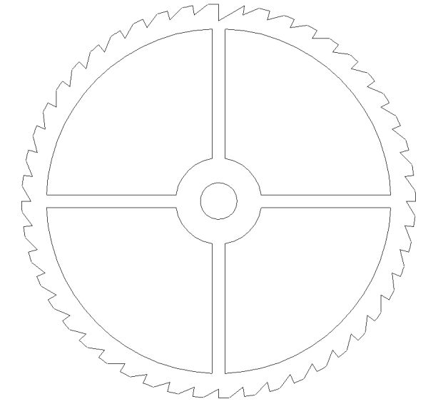

« Reply #32 on: April 09, 2012, 06:33:20 AM »
Chris,
Is this what you wanted?
The deep tooth at 1/8" looks deeper than your drawing. I've put the three no. 55 holes in the centre of the hub as there was no pcd for them.
DXF attached.
Cheers.

« Reply #35 on: April 09, 2012, 09:11:49 AM »
John, Phil...many thanks for both your drawings! I think John, you have actually drawn what I want and what I meant to say. Phil, you have drawn exactly what I said....sorry my fault... :doh:
I`ll have another go:
The drawing shows 1/8" rim with "normal" teeth at 1/16" depth to the centre. I have asked for teeth 3/62" to the centre BUT then incorrectly, I said:
... I`m sorry, that should have read the one deep tooth would then be the standard 1/16" from the original drawing. i.e making all the teeth smaller and so the "deep tooth" becomes the standard depth of the old drawing.
However, I`m fairly sure that is what you have done John...!
I`ll give it a bash later today... not sure how well it`ll work as I`m invetiably going to end up with a rounded corner. This could also be quite critical in its failure as this is where the pawl binds to the tooth to drag it around!

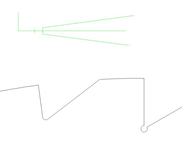

« Reply #38 on: April 09, 2012, 10:15:40 AM »
Neat Idea Phil, gave me an idea.
Edit,
Chris has said he wants to use a 15 degree engraving cutter so i drew the cutter and offset the tip by 30 thou to see how big the diameter is when cutting 30 thou sheet. taking a guess here as Chris has said 'thin sheet'
So alter two teeth, the one on the left to give a rad at the bottom as you would get by profiling and the tooth on the right by pre driling with the cutter, then profiling.
Looks like the pawl will have to me modified from a complete angle to a radiused one to fit in.
Comments ? bricks ? flying custard ? muuuuuuuum yummmmy
John S.
« Reply #39 on: April 09, 2012, 11:09:45 AM »
Hi John,
I don't know if Chris has a 15 degree inclusive cutter or half angle.
Whichever, the wheel will still have non vertical faces which I suppose could be compensated for in the pawl.
Personally, I'd prefer to use a small diameter parallel cutter to do it.
I prefer the look of the radiused bottom rather than the drilled relief on purely aesthetic grounds.
I'm going in the workshop to experiment on the Quorn T&C grinder - I've plenty of broken carbide cutters as blanks.
Alternatively, it's the ideal job for a 4th axis using a 60 dovetail (or fly) cutter.

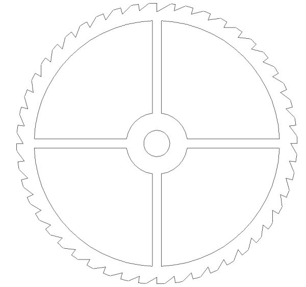

« Reply #43 on: April 09, 2012, 05:43:12 PM »
Try it at 0.5mm then file the rest, you will have a pattern to follow and that bit of brass will file out easily.
« Reply #44 on: April 09, 2012, 06:08:07 PM »
Chris,
I've just done the preview in Cut2d with a 0.5mm cutter and it's come out OK.
I've attached another 'clean' DXF  the previous one had some arcs left on the points of the teeth from a previous incarnation. (That may have been the problem or maybe Cut2d doesn't worry about fitting into the corners.)
Good Luck.
« Last Edit: July 13, 2017, 02:40:29 PM by philf »
