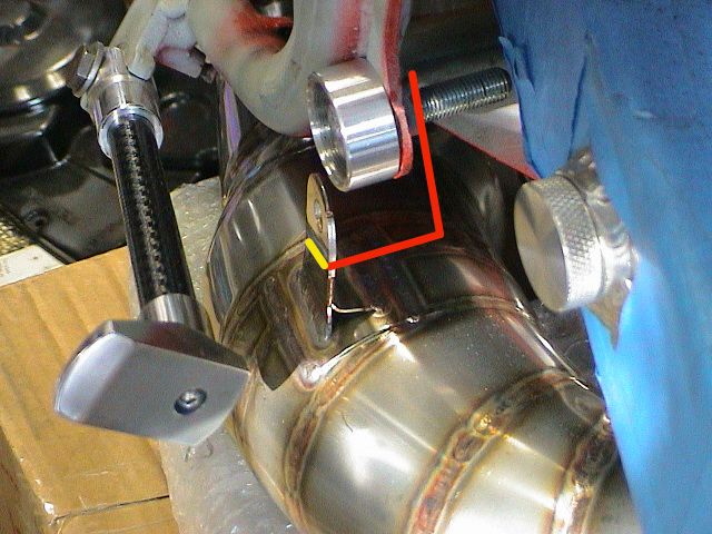

Re: DT-100 Bucket Racer
« Reply #19 on: March 27, 2012, 12:36:40 PM »
Nope. All the pictures for that particular build got deleted. I have some CAD models of another set I was going to do for a different bike though.
The set I had built was for a Suzuki TL1000R. I used aftermarket pegs and levers for a GSXR1K. That way I only had to design the bracket. The other set I did never made it to manufacture. A company in asia started making a cheap set of rearsets that everyone gobbled up (The bike I was making parts for is no longer made in the states and has a cultish following) that up instead.
Was going to be the same thing. An adjustable set of brackets using aftermarket pegs and levers.
I still do the kickstands and other parts...

« Reply #20 on: March 28, 2012, 12:03:35 AM »
Kickstand! I knew there was something I forgot!  :doh:
« Reply #21 on: March 28, 2012, 12:21:03 AM »
Here ya go...
One billet/CF stand I did for a custom RZ350

Brass Machine, carbon fiber? Awesome!
I think I'm going to rock a center stand on this bike. It'll look cool, and let me hand start the bike.
