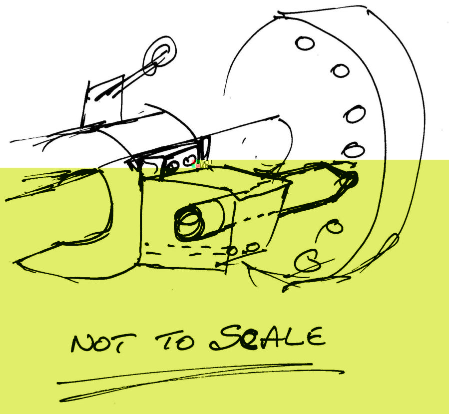

I like that idea. Nice, small and probably fast to make. I kind of wish I hadn't rounded the part yet.
So I'll mill a flat on the large rounded end and mount the index pin.  :dremel:
And I'll call this Ver. 1.0.0.
 Ver. 2.0.0 coming early next year to a shop near you. :lol:
P.S. while writing this I already think I've come up with Ver. 2.0.0  :)

Now that I've got the Rocker running I need to get to some tooling built so I can build a more complicated project. Ya like that's going to happen. Well, anyway I've gotten back to try and do a bit more on the indexer.
rleete asked what the aluminum plate was for. Well as you can see in the pic, it's to hold the indexer to the table. I need to study it a bit more to decide how and how much more I'm going to add to it.
This could be the start of my winter project, a bit early.  :)
