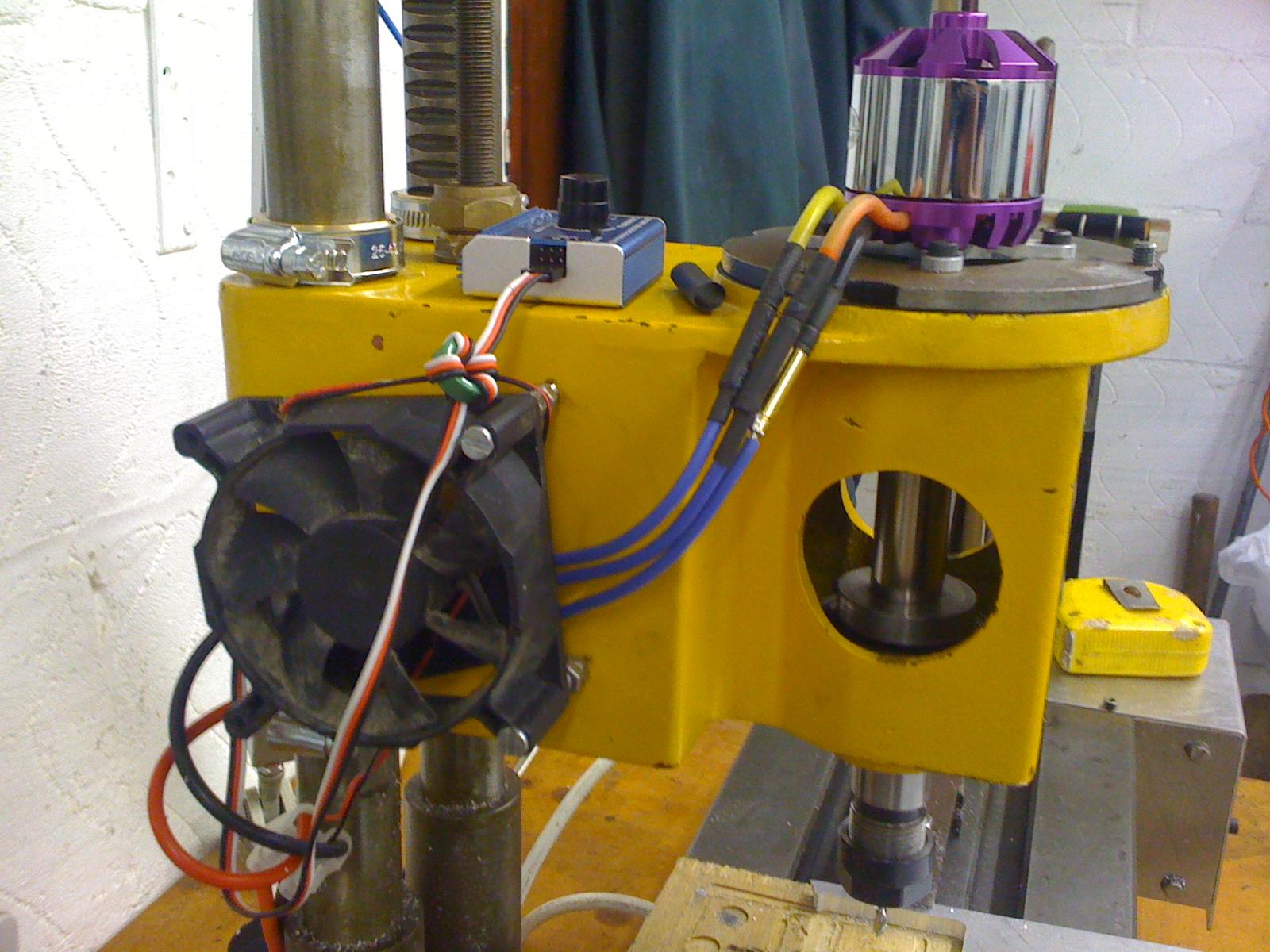

Hi guys,
Got it up and running tonight, not mounted on the intended machine, but spinning.
ESC 3phase driver is Sky...something. 100A
Speed controller is a servo tester - not explored yet but I presume the control is linear!? I intend to get rid of this and use PIC in conjunction with EMC  to control the spindle once up and working.
Power supply is a cheapo variable supply upto 13v, 8.5A  power supply.
It spins damn fast and with seemingly enough torque... the proof will be in the pudding!
Runout looks good  :clap: but more on that when it is fully mounted and not vibrating in the vice resting on the bench!
Warning... sound is stupidly high which is nuts because it is less than half noise of a dremel on full, the camera just captures it for some reason.
[youtube]http://www.youtube.com/watch?v=eZ3BzL82qNg&feature=youtu.be[/youtube]
I still need to strip it, clean and take pictures. Has anyone any suggestions as to a secure way to grip the shaft in bell at the end. It is currently held in by a grub screw but since this is going to be taking some of the cutting force, it needs more...any thoughts?

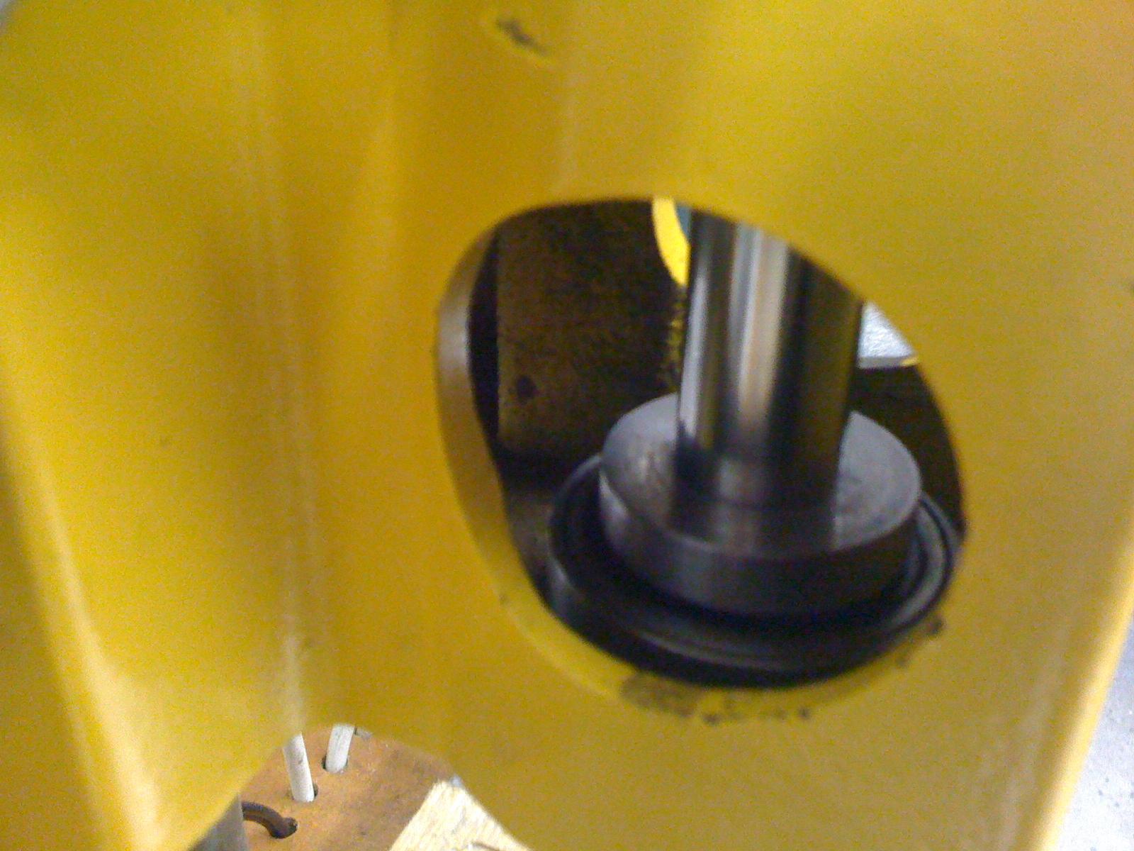

Hi guys, just updating this thread as I`ve not had much time to do so recently.
 I stripped and rebuilt the spindle and while doing so, I took some pictures:
Here are all the bits. You`ll notice the surface marks where the bearings were skipping on the previous built due to not enough tension and slight misalignment. I hope this is now stopped!?
You can see the thust bearing on the shaft up need the head of the chuck.
The bearings are separated by a number of washers which will compress to apply tension to the bearings.
Bottom half of the motor is screwed up:
And the bell slid on the shaft with a grub screw tightening this up. There is now a flat milled onto the shaft:
It is working well so far. I`d love to know how it would perform as a tool holder grinding spindle on the lathe!
According the my hall effect sensor and Mach3 - I can get 10,100rpm max speed.
