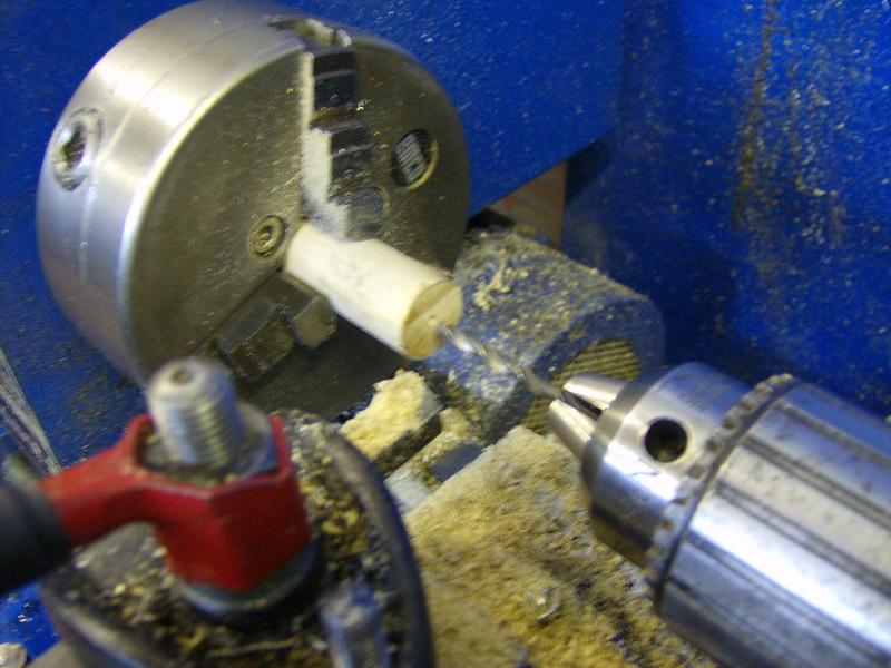

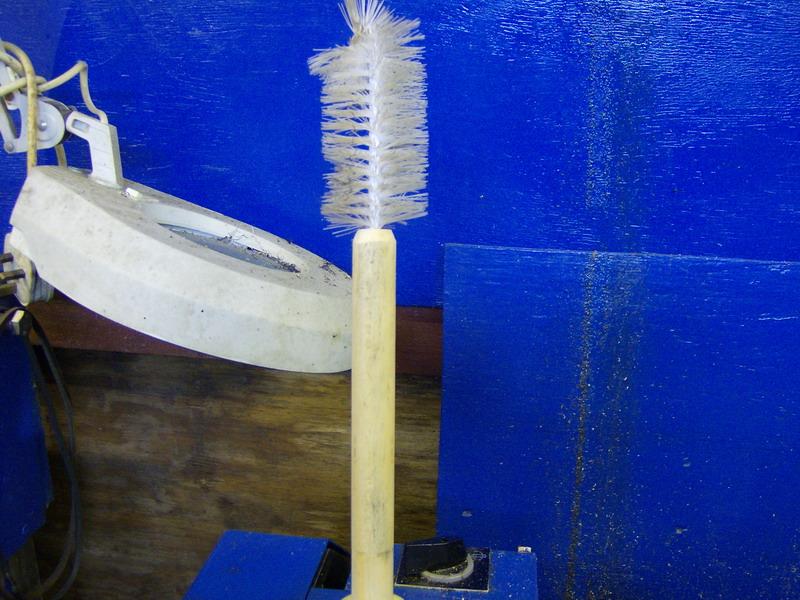

HI i made this up today sum pics
Re: a wot not
« Reply #1 on: February 26, 2012, 06:11:05 PM »

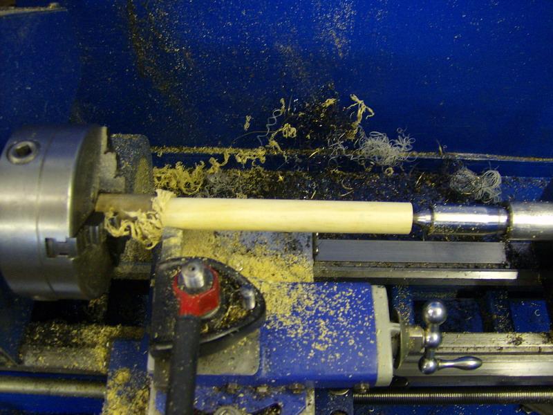

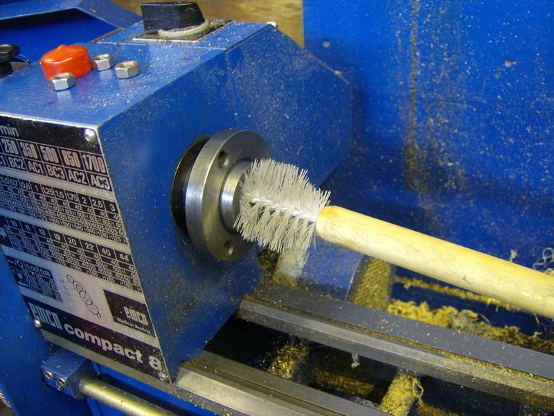

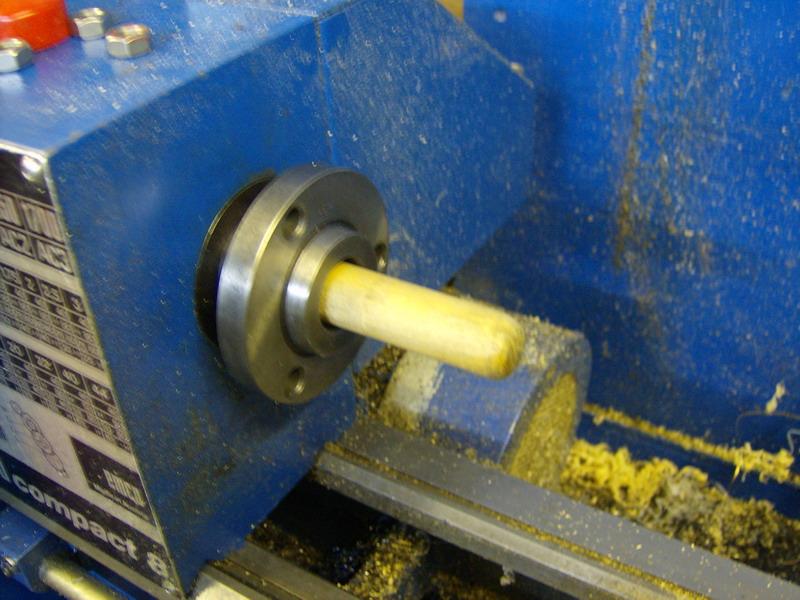

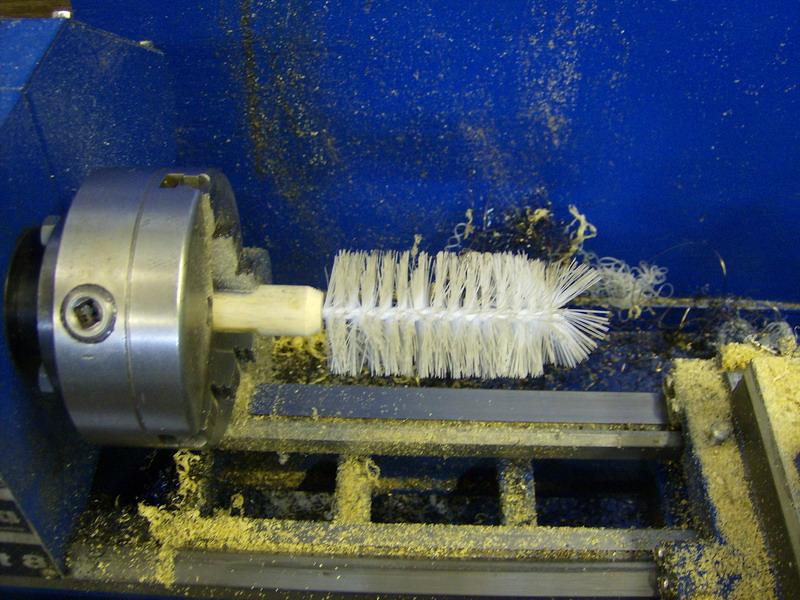

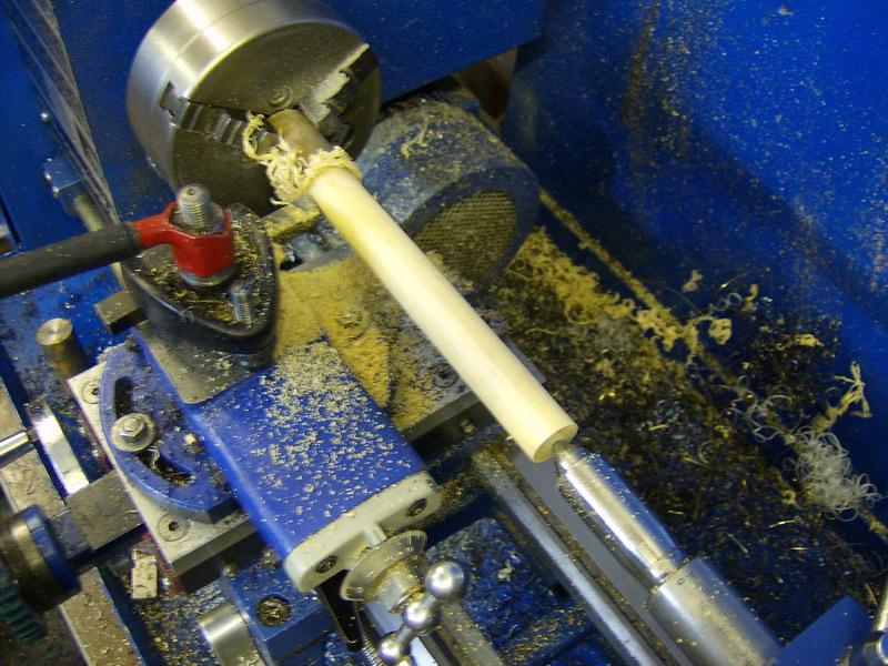

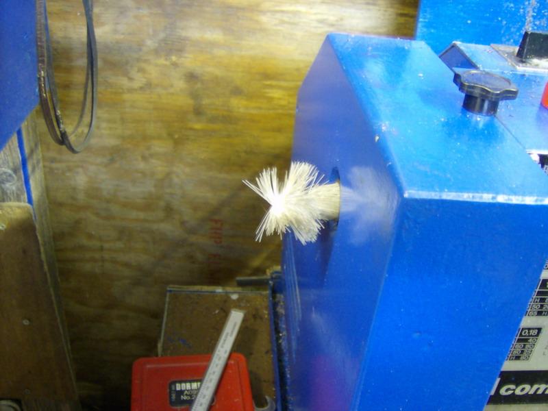

OK the rest of the pics its for cleaning out the Morse taper on the lathe Head the brush it self started out as a brush for cleaning  drinking glasses but the Handel was plastic with a Handel on it which prevented from gowning threw the head stock  turned dawn a length of broom Handel to 19 mm OD and their you have it

Bob,
Hey, Hey, Hey ........... a very clever idea  :clap: :clap: :clap:

Along the same lines...
Go to your local gun shop and buy a cleaning mop for a 12 gauge shot gun.  Fit it to a handle and you've got a great mop for cleaning the taper on the tailstock.  The fuzzy material used for these mops has an almost magnetic attraction for swarf.

« Reply #4 on: February 26, 2012, 06:54:28 PM »
HI well thanks for the tip but gun shops are a bit thin on the ground where i live as the brush was only £1 nothing to loos
