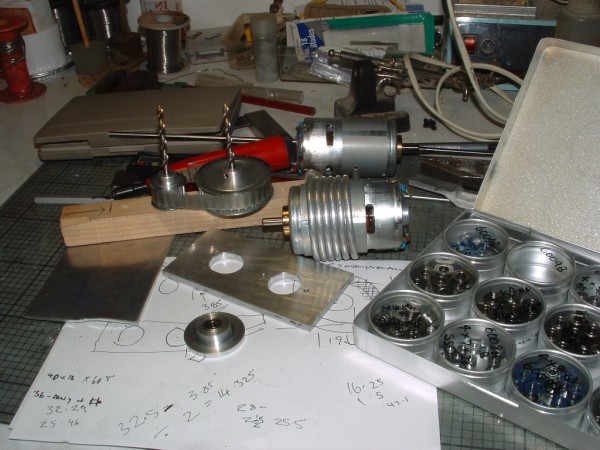

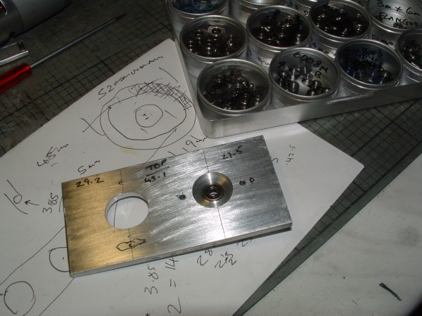

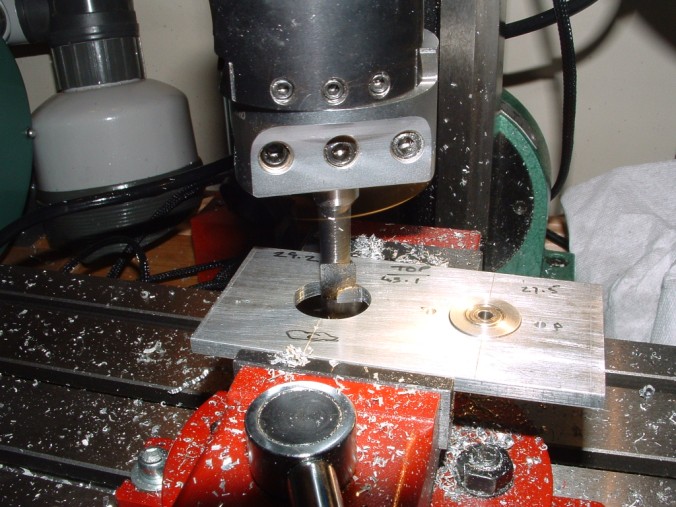

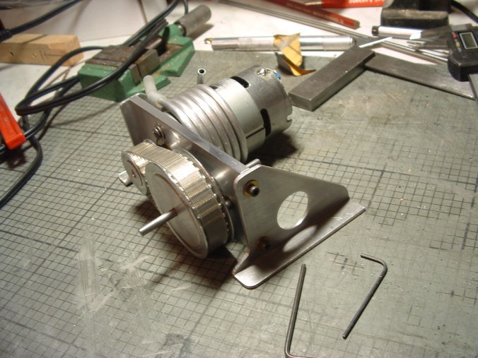

Hi a friend has asked me to build a gear drive for his boat , one thing he wants is a good motor mount hat can also revert to direct drive so we can do back to back tests, I started today to make the main mounting plate, this has two positions fo the motor which is a water cooled 700bb race type motor, first you can use it for direct drive and by moving the motor ove and inserting a bearing holder you can have 2,1-1 so able to get a bit more eficency out of it heare a a few pictures of it so far, I started by drilling the motot holes with a step drill then finnished them of with my trusty boring head, I am getting better at using it , I only get half the noise and smoke I did when I started.
I have made the bearing holder that drops in the motor hole and locates as the motor would . there is a picture of yh mock up of how it will look I have to make theside mounts that will hold it in place.
I will put a link on to show the boat as it sails now , we are hoping for similar speed but a better run time
Peter :coffee:

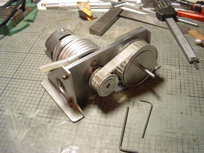

A few more pictures, Ill post the finnishe unit in the next few days I hope.
Peter

« Reply #3 on: January 24, 2009, 05:16:02 PM »
Very tidy,
What's that piping around the motor, a heat exchanger?
Offline rleete
  • Posts: 538
Re: Small belt drive for model boat
« Reply #4 on: January 24, 2009, 05:24:22 PM »
Water cooling jacket.
bogstandard
« Reply #5 on: January 24, 2009, 05:26:57 PM »
Hi Peter,
If you get the prop selection right, you will find that not only will you get longer running times, but better performance as well.
You should easily be able to add 20% to 25% to the prop size. If it is running say an X45 direct drive, try it on an X55 with the reduction gearbox.

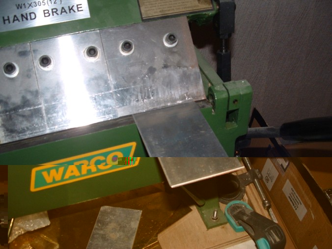

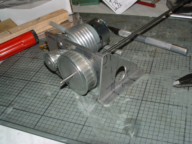

Did a few bits tonight while I wait for the M4 bolts to arrive , i bought a bender a few years ago and prob only use it about once every six months , I thought it might making brass parts a bit easyer on my hands but I still tend to end up using two bits of angel iron in the vice as I can controle it better. It seems to be each time I but something that I have thought that will help me do so and so when I get it I find its easyer to do by hand,  anyway hear are a few more  pictures to show the sides , the ally is a bit of "I dont know what" all I know is it rings like mad when drilling and took an age to get my panell puch through it , anyway the pictures will give an idea what its supposed to look like , we will see when its finnished    :ddb:
Peter

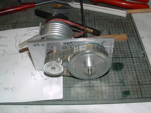

A few pictures from tonight it just needs some air holes and a bit of lightening, Ill post the final pictures when installed ,
Peter

just a quick picture showing it installed in the boat, the motor is now about an 1" lower than it was and it now lines up, the boat was built about 30 years ago and had a small IC engine in origanly, there is also a picture of the old direct drive set up that was far to high and helped make the boat roll at speed, hopefully he may now get a better run time as it is far to fast anyway.
Peter

« Reply #15 on: February 26, 2009, 09:21:22 AM »
Very nice job there Peter.  :thumbup:
I would think that the boat would lean to one side a bit with the motor offset like that or does the large pulley counter act the motor?
Offline HS93
  • Posts: 788
« Reply #16 on: February 26, 2009, 09:24:04 AM »
we will be balancing it up with a set of cells on the other .
Peter
