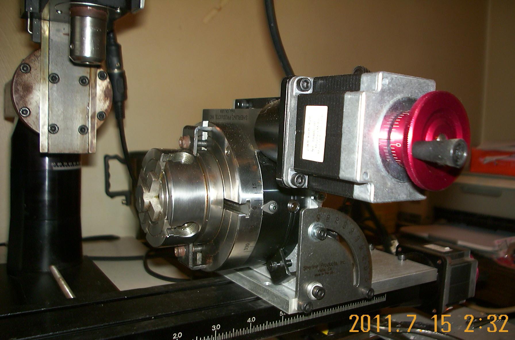

I have the above mentioned lathe, a taig manual mill, a small rotary table and (just purchased) a tailstock for the rotary table.  It seemed easiest to use the mill and rotary table/tailstock.
It took about 2 weeks of part time work in a cold shop to get set up and about 1/2 hour to actually make the gear.  I had some scrap brass so cut it into several disks and cleaned them up on the lathe.  Also made an arbor for my small four jaw chuck (I had already made a mounting system for that chuck on the r/t.)  It took some time to make a mounting plate and some mounting washers for the r/t and tailstock so that they would be secure on my mill.

Cleeve sharpening jig with completed 60 deg. threading tool:
Mandrel and gear blank:
Setup in the Taig manual mill:
Another shot of the r/t etc. on the mill:
And the final result - the brass gear with an original steel change gear:
I made two 36 tooth gears since it didn't take long once the setup was done.  The cutting was done in two passes - about 50 thou. then another 32 thou).  I suspect that the setup would have been ok with one pass but didn't want to abuse the machinery.  The gears mesh quite well with the other change gears and I plan to run them in the lathe to improve the contact.  The other change gears are steel so I figure the brass will wear in quite well.
