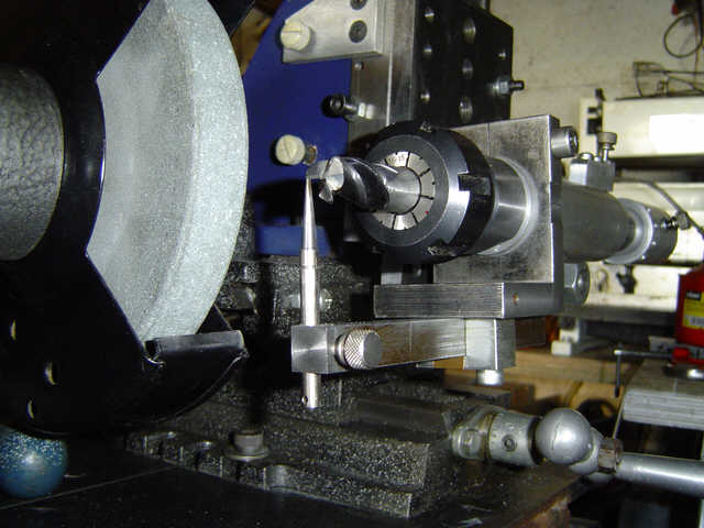

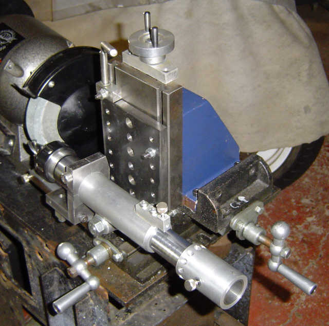

I've got the grinder pretty much finished to the point where I've put it back in it's home spot, ready to go to work.
I've got to change out the crank handle on the y-axis since it interferes with the x-axis handle.  I'm waiting delivery of a small timing belt which I will use to connect the lead screw to the handle after moving it a couple of inches to the right... the way it was before!
I finished the z-axis crank assembly on top of the column and re-purposed the tool post tightening lever from my mini lathe to now serve as the clamp screw for the motor assembly to the column.
Chuck
Next I'll be looking at some different tool holding fixtures to see if I can improve on what I've got...

Is the fixture mounted on the bed for sharpening lathe tools ?

Thanks, Rob.  The fixture is primarily for doing lathe tool bits but will do pretty much anything that can be clamped to the round work surface.  I plan to do a video later and show all the functions of the grinder, including the fixture.
Chuck

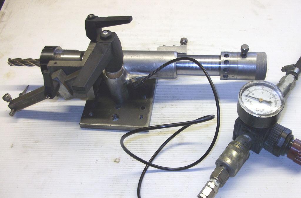

I'm beginning work on updating my existing grinding fixture and perhaps adding some new ones.  The first thing I did was spiffy up the piece of angle iron that attaches the fixture to the base.  I radiused the side and the base and rounded over the outside edges.  After 40 years or more of working around metal I'm finally learning to remove as many of the sharp corners and edges as feasible because sooner or later I'm going to bang my hand against one of them.
Here's the base attachment and a steel disk with newly scribed graduations.  This will be part of the horizontal angle adjustment and has 5 degree and 10 degree graduations.
Here is the setup in my mill drill for cutting the graduations.  The disk is mounted on my smaller rotary table.  Each full revolution of the crank handle rotates the disk 5 degrees.  The scribing tool is just a boring bar that takes 3/16" square high speed tool bits.  The tool cuts on the upstroke which makes the inside end neater and the bit of metal that is removed comes out on the edge which is easier and cleaner to remove.
This is a closeup of the boring bar and the 3/16" tool bit.  You can see that it is ground to a sharp point with the cutting edge on top.
Hopefully this will all make more sense as I get it put together.
Chuck

Thanks, all, for the kind words.  Here is a picture of my home made fixture for sharpening the flutes on end mills.
The spindle has just enough clearance so it floats on a cushion of air when hooked up to a low pressure air supply.   This makes it very easy to spin while moving in and out.  In it's current configuration it will handle cutters with a 1/2" shank on one end and 3/4" shanks on the other end.  I can also do other shank sizes by using bushings.  I'm going to try to adapt an er20 collet chuck to it so I don't need to use bushings.
Chuck

Thanks, Pete.  Yes, I spent a lot of time getting this thing to work.  I made the housing first.  As I recall, I line bored it to get a uniform bore.  I had to make several spindles before I came up with one that was parallel and worked.

« Reply #48 on: March 09, 2012, 09:58:32 PM »
I got my end mill flute grinding fixture hooked up to the air supply and have been practicing sharpening on a 3/4", 2 flute end mill.  The fixture will "float" the spindle at about 5 PSI and essentially becomes frictionless, except for the flute of the end mill riding on the small post which keeps it oriented withe grind stone.
I began thinking about a fixture that would easily let me grind the bottom cutting edges of the end mill and had visions of a fancy collet holder with indexing, etc., that would let me sharpen a tool at any angle, any rake, any number of flutes, etc.  But when I got to looking for suitable material, my practical side kicked in (some might say it was my lazy side  :-X) and I remembered this old, cheap Enco end mill sharpening jig I had bought years ago.  After some searching I managed to locate it and after some head scratching, here's what I came up with.
Here's a couple of pictures of the lash-up I used to drill the holes for attaching the new base to the old one.
And, here's a picture of it sitting on my T&C grinder, ready to go to work as soon as I bolt it to the T-slot in the table.
Not real fancy, but it will do the job until I get the urge and the time to make something better.
Chuck
