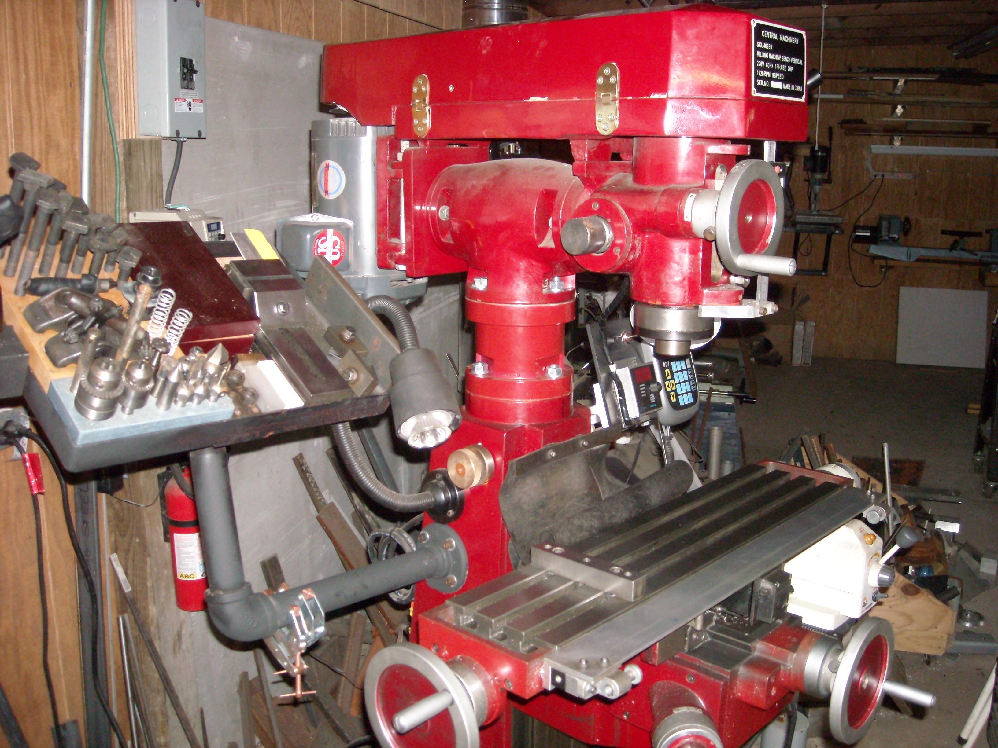

Hello,
I have an 8x30 mini-knee mill that does not have a stand but goes to the floor with a smaller built in stand (kinda).  I think it has more distance between the table and the spindle compared to the one you picture.
I added a DRO to 2 of the axis (have the 3rd but have not installed it yet) and a 3HP DC treadmill motor for variable speed up to 3000RPM (can go to 4000 with a belt change but not tried it yet)
Been happy with it over all.  Not sure of the real brand as this was a left over brand new mid-1980's Taiwan mill that was left in a basement of the importer.  He was selling off 4-5 of them that were left over.  Still was covered in the waxy/oily goo when I got it for $750.
(first photo inclusion so ... we will try this ...)
This was the delivery back in 2007.
From when I have been to KBC Tools it's very similar to their mill other than mine is manual lube.
TTYL, Jeff
