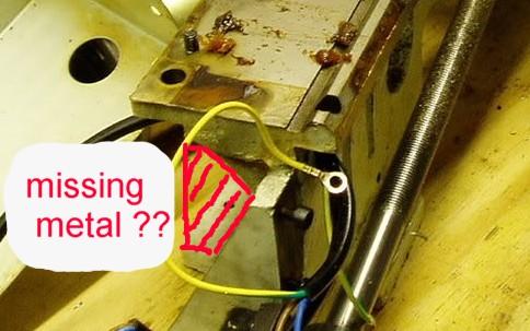

 And the headstock end of the bed is cut away to accommodate the motor so much that it might flex a bit with supertorque, as Fergus said. See two of the pictures on this page, which show the Real Bull variety, but Siegs are the same.
Andy.
Where's this cutaway?  :scratch:
This is my Real Bull, during a stripdown, some time ago........
http://i110.photobucket.com/albums/n95/Dayjo/p12700121.jpgMini Lathe Speed Reduction.......
Same thickness of bed, all the way through. Full, four bolt fixing.

Sorry, David; I omitted the link from my last post, but have now rectified that. "Cut away" was not the best way of putting it, but I was referring to how the rear vertical side of the bed stops short and doesn't afford any reinforcement to the top of the bed under one side of the headstock - see the last pic on that page.

« Reply #14 on: January 26, 2012, 08:51:57 AM »
Hi Dave
I guess this picture shows the cutaway
without it ,you need extra metalwork to attach the motor
(not what the exra bean counters want when the are keeping the cost down )
PS       the motor  mounting in the Ralf Patterson speed reducer has given me ideas

I realise there's a little less metal, in a Sieg version.......
I wondered if the deck was cut away, under the headstock. Or summat!   :Doh:
