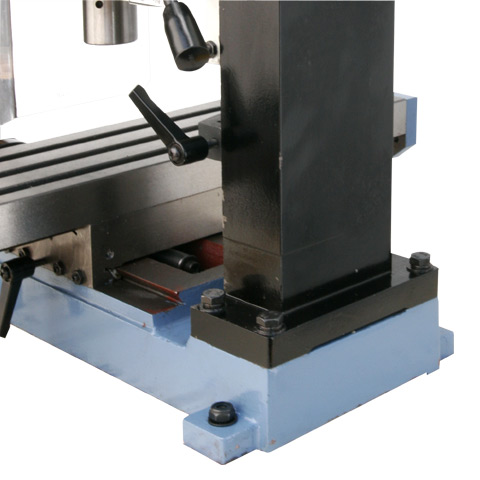

Looks like Little Machine Shop is offering a X2 with a solid non tilting column.
LINK
Might have more potential?

Quick question based on this new rigid column - I`ve owned an X2 for near 3 years now and yes, it is small but in all honesty, I`ve only been really annoyed that something wouldn`t fit on once! It does for everything I need. An X3 would be my ideal choice but I can`t afford one. I read a lot of the forums (only tend to post on here and clock/watch forums) and lots and lots of people have modded their X2 to strengthen their column.  In reality, will you be able to tell a difference and how? I`ve read that it will be more rigid of course and there will be less deflection - what does that physically mean - I understand it implies the column won`t bend or deflect but will you actually be able to see different results from the machine?
Chris
Re: LMS offering rigid column X2
« Reply #5 on: December 30, 2011, 01:58:30 PM »
Chris,
I've owned and used the Chester Conquest mill for at least 5 years now...it is basically the same machine but with a bigger motor (500watts of dc motor and a bigger table)...
The most ambitous project  I've used it for, was to make the indexer described by Harold Hall in his book on milling...That involved using a 2 inch boring head to make some big holes and to slit sone slots using big saw blades...
IMHO, it has never let me down on when I managed to smash the gears in the cog box when fly cutting(I was learning at the time)...Strengthening the column imho does nothing to improve the machine when used as designed...

John, I said mine was an X2, but actually I have the Chester Conquest as well! Your reply is really interesting and I guess in some way I was loading my question with the fact that I can`t imagine a stronger column would do anything! I`ve used mine for fly cutting, gear cutting and general milling and at the tollerences I expect from the machine due to other features, I just can`t imagine this mod would give me any benefits. I could be wrong....
Chris
HaHa, I am so happy you and JR brought this up. i.e. ...Strengthening the column imho does nothing to improve the machine when used as designed... :clap:
Now comes one of the real reasons why this happened......About two years ago, a particular person with no mechanical knowledge took advice from a seller who also had no knowledge (not me), and wrote an article in a well known publication. This made me, for one, very angry to say the least!  :bang:, and my opinion was colourfully stated to the editor...even though I was not selling the X2 at that time. The editor did some editing to avoid collective damaging actions being taken by parties effected, but a little too late.  Obviously what ever is written in this "respected" publication has to be true...doesn't it?, and the newbies obviously follow what is said......so, the rest is perception as you have noted...
To deal with this, "we" the sellers have to come up with what the market wants. Simples
