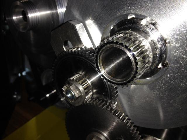

An update.
I bite the bullet and remove the lathe from the chip tray and flip the lathe over.  The 2 setscrews and 2 bolts holding the plate are rather tight. I break the grip of the bolts and setscrews and retightened them.
Now the carriage and leadscrew handwheels turn very smoothly.  I'll do some test cut after lunch with my parents to see if its too loose.

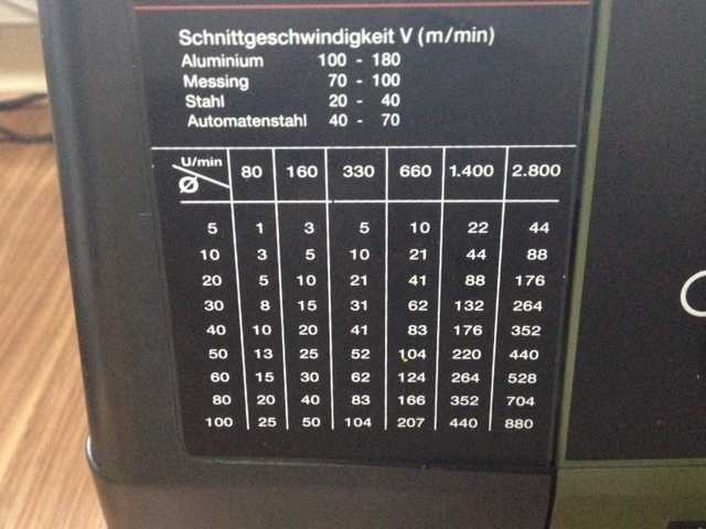

May I know how to read the table on the lathe on suggested feed and speed?  I want to test cut a piece of steel with diameter of 8.35mm.  Any suggestion on depth of cut for machine of this size to start me off?

Re: Hard to crank handwheels - Proxxon PD400
« Reply #16 on: January 02, 2012, 06:26:34 AM »
Hi Wong,
At the top, there is a short list of materials and  the recommended surface speeds in metres per minute for each of them. "Messing" brass. "Stahl" is steel, and I assume it refers to mild steel. I think "Automatenstahl" is free-cutting mild steel.
The table is there to as a guide to show what surface speed per minute your available spindle rpm (shown across the top of the table) will produce on different diameters of stock. You are looking at 8.35mm diameter, and if it is mild steel you want 20 - 40 metres per minute. The nearest diameter shown down the left side is 10mm, and looking across that row it seems that a spindle speed of 1400rpm will give you 44 m/minute. That's a bit fast, but your stock is only 83.5% of 10mm, so its surface speed will be about 83.5% of 44 m/minute - around 37 m/minute. And as you take successive cuts, the diameter and hence the surface speed will reduce.
As to depth of cut, I would start off at 0.25mm for a roughing cut.  That will reduce the diameter by 0.5mm. Bear in mind that the cross-slide may be marked up in "diameter reduction" rather than depth of cut, so advancing 0.5mm as shown on the dial gives you 0.25mm depth of cut.
Experience will show how adventurous you can be with depth of cut. On my 7x12 lathe (which is more robust than the usual mini-lathes) I usually use 0.5mm on mild steel, reducing the diameter by 1mm per pass. I only tend to use cutting fluid near the end, and for light finishing cuts. The feedscrew is 1mm pitch, so on repeated passes I just advance the handle 180 degrees from its previous position. That's easier than reading the dial.

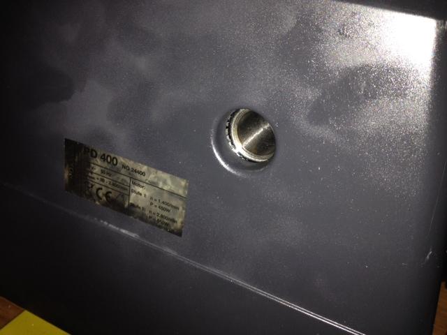

When I use a drill chuck in my Sherline headstock (with MT1 taper), a drawbar holds the drill chuck.  With the PD400, I don't know how a drawbar can be used with the 20.5mm spindle bore.  I've the 2 pics here to illustrate what I mean.
The spindle bore can be seen through this hole on the gearbox cover:
With the gearbox opened:
Regards,
Wong

Re: Proxxon PD400
« Reply #62 on: January 16, 2012, 07:39:53 PM »
Hi Wong,
The drawbar: If the hole in the gear cover B is ~3mm larger than the outside diameter of the spindle, you can make a nut with a boss projecting from it. The boss will have two diameters, one being about 24.5mm to pass through the hole and push on the end of the spindle, and the second about 21mm to fit inside the spindle bore to locate the nut.
If the hole in the gear cover is too small for that, either enlarge it to around 25mm or make a nut as above, but with the hex section of the nut smaller than the hole. This will allow you to tighten the drawbar and then close the gear cover.
Or do what many of us would do - run the lathe with the cover open, and keep your hands clear of the gears and pulleys. I think you had a Sherline, and they don't have a cover over the pulleys. If you still have all your fingers after using that lathe, you will probably not lose any of them with the Proxxon.
« Last Edit: January 17, 2012, 02:52:11 AM by andyf »

Lots of info. Letting them settling into my head.  May need some files to thin the outer shell for more to pass through...
Andy, the gap between the spindle end and the cover is rather small.  I think I can file the plastic thing (any name for this protruding circular thing with a hole in it?) shorter to make more space for a thicker bolt head.
I believe the bolt head can bear against the end of the spindle though it only measures about 1.5mm in thickness?
The hole in the cover is almost 25mm but the alignment is off to one side (spindle bore and the hole in the cover are not concentric). By the way, is the "nut" you mentioned the head of the bolt of the drawbar or it is really a nut to be fastened onto a rod making the drawbar?

Re: Proxxon PD400
« Reply #68 on: January 17, 2012, 12:52:06 PM »
Yes, that would be perfectly OK. The surface area at the end of the spindle will be around 100 square millimetres, which is plenty.  You won't damage the spindle when you tighten up the drawbar unless you have superhuman strength, and as Pete (Miner) says, it doesn't need to be tightened very much to stop a Morse taper slipping, and overtightening will make it difficult to get the tapered item out of the spindle.
Normally, a drawbar is in the form of a long bolt, so I should have referred to the head of the bolt. Sorry I called it a nut; that is because I was forced to use separate nuts on two drawbars (M10 and 3/8" respectively) which I made for my milling machine.
