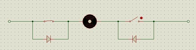

Here is my problem. I'm working on my '66 Corvette which uses two 12vdc electric motors to open and close the headlight buckets. These motors are 45 years old and parts are hard to come by. Someone has started reproducing these motors but they are $400.00 each. So I decided to reinvent the wheel, err, the system. My plan is to use a single motor mounted between the buckets with a driveshaft  running to each one.
I would like to keep the orignal 'up/down' switch as it is very classy looking. The only problem is that is  a single pole double throw switch which won't work with any motors I have come across. On the original motor (which is much like any power window motor of past or present), the case is grounded and their are two 'positive' terminals. Power to one terminal is CW, power to the other is CCW.
I have no idea how they wired these. I'm wondering if the wiring on a new motor can be changed to work like the old one. Or, if there is such a thing as a relay that would reverse the polarity of the wiring to the motor?
Plan B is to simply hide a DPDT switch under the dash near the old one.
Here is a diagram I made showing my current wiring. Please feel free to fill in the missing links on the bottom part.
http://i53.photobucket.com/albums/g62/mithslew/Machine%20Shop/MachineShop-HowToWireNewDCMotor2.jpgHow Do I Convert DC Motor To Reverse With SPDT Switch?

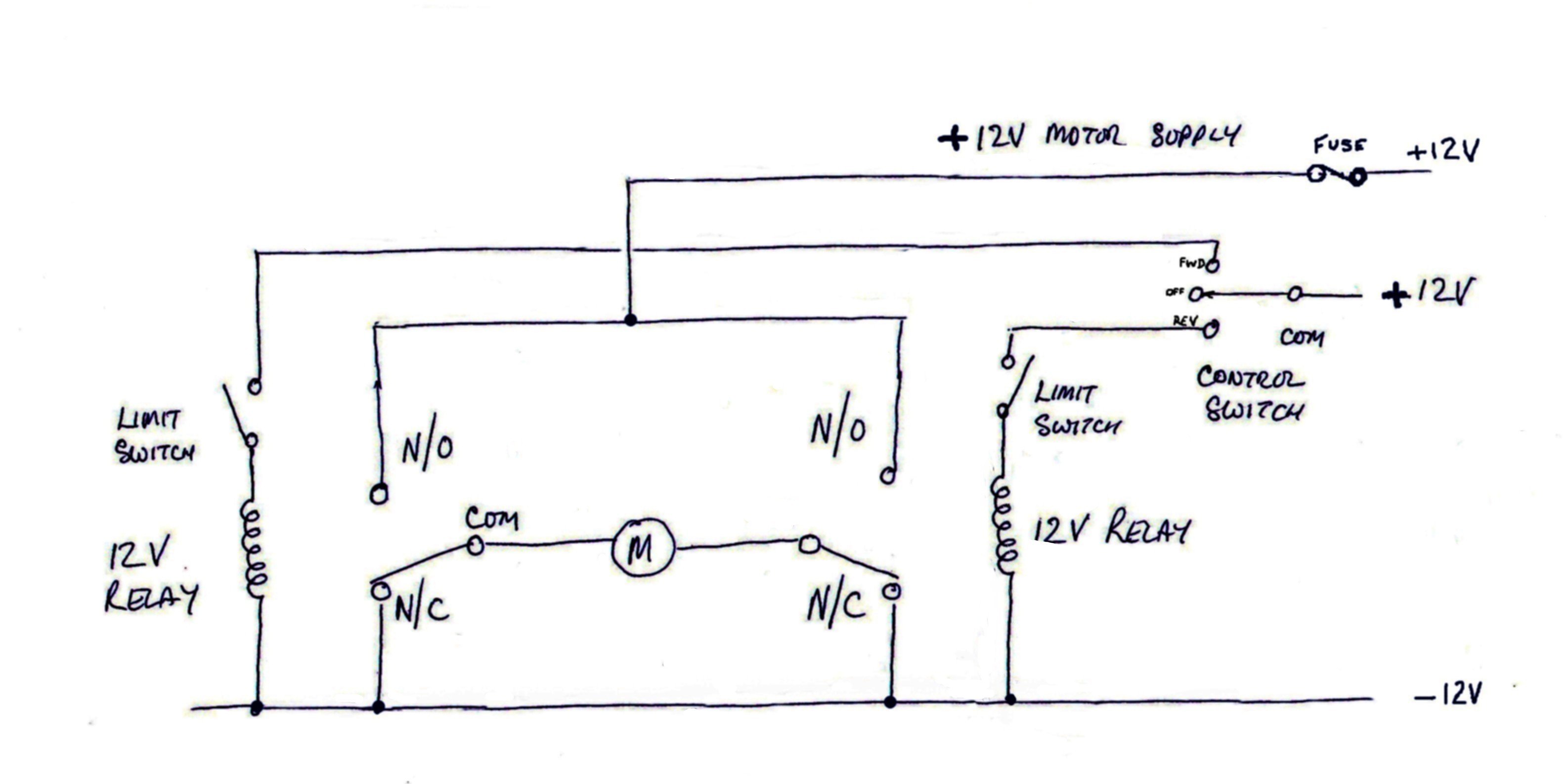

Offline John Swift
  • Posts: 344
Re: How Do I Convert DC Motor To Reverse With SPDT Switch?
« Reply #3 on: December 30, 2011, 08:17:15 AM »
Hi Snub ,
you can use two single pole automotive relays
 connect the motor between  the  common relay contacts
the negative supply to the normally closed contacts and the positive to the normally open contacts  (on both relays )
until a relay switches, both motor terminals are connected to the negative supply
when the existing switch  operates  one or other relay, the positive supply is connected to one  of  motor terminals
if the motor torque is not too great you  could just let the motor stall until you release the switch (assuming its normally off)
other wise  wire two limit switches , one in series with each relay coil
« Last Edit: December 30, 2011, 09:17:31 AM by John Swift »

Offline John Swift
  • Posts: 344
« Reply #5 on: December 30, 2011, 10:46:19 AM »
Hi Joe ,
how much smaller do you need it ?  it just fits my screen
attached picture  at 70% of original size

Offline John Swift
  • Posts: 344
« Reply #9 on: December 30, 2011, 02:29:30 PM »
Hi snub ,
with motors that powerfull , I'd fit limit switches ( one at each end of travel)
or if that's not easy, try adding a wirewound resistor in series with the motor to limit the torque
as a starting point, measure the motor current before you hit the end stops
and divide 3 by your answer to get a resistor value that drops 3 volts
with the engine running the motor now runs on about 10.5V
both the torque and stall current will now be reduced
to find the maximum current with the motor stalled
divide 13.5 v by the sum of the motor resistance and your added resistor
the wattage rating for your resistor  is given by  I squared R ( I = stall current, R = added current limiter resistance)
PS    could you use a mechanical torque limiter as used in battery operated drills and screw drivers ?
« Last Edit: December 30, 2011, 03:39:55 PM by John Swift »

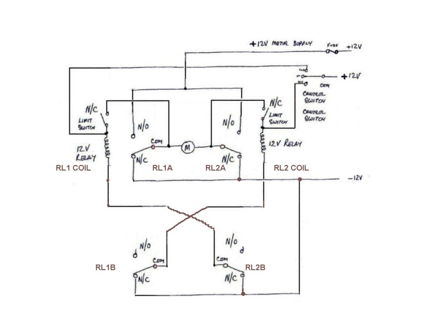

Offline John Swift
  • Posts: 344
« Reply #12 on: December 30, 2011, 04:29:40 PM »
Hi Andy ,
the only problem I can see is if you selected a motor direction and then selected the reverse
before it reached the limit switch and the first relay dropped out
both relays would be latched on and the motor stopped between the two limits
sod's law predicts it will happen sooner or later
 you need to be able to switch off the 12v supply to the relays to reset the circuit
or  use two pole relays to interlock the relays to prevent this
circuit added
« Last Edit: December 30, 2011, 05:17:06 PM by John Swift »
« Reply #13 on: December 30, 2011, 05:30:15 PM »
Good point, John. Sod's law* would leave my version connecting both motor terminals to +12v, so it would stop, leaving the headlamps stuck halfway up and both relays latched on until the "+12v Motor Supply" was broken momentarily.
More thought required.
* For the benefit of our US cousins, Murphy has a close relative called Sod who also fouls things up, but whose name isn't mentioned in front of the children.
« Reply #15 on: December 31, 2011, 03:54:31 AM »
John, great minds think alike  :thumbup: . I drew up exactly the same circuit late last night, after going to the pub and consuming a considerable quantity of beer, so I thought it best to leave it for checking in the morning. I suppose the two new relays RL1B and RL2B, which only handle the small current required by the coils of RL1A and RL2A, could be replaced with transistor switches, with the addition of protective diodes across those coils.
Snub, though it's more complex than your drawing and needs another two relays, John's latest version allows you to work the motor through your existing momentary switch. Good luck, and don't set the car on fire!
Offline John Swift
  • Posts: 344
« Reply #16 on: December 31, 2011, 05:20:03 AM »
Hi snub,
on your diagram just swap terminals 30 and 87 so the motor is connected to the common terminal 30 on each relay
otherwise you will short circuit the supply !
