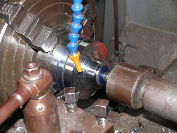

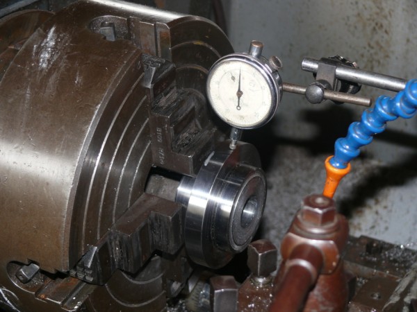

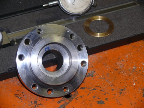

This is the 1st project that I've posted up here, so here it goes.

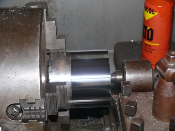

As the title says, it's an adapter to fit a balancer to a 6 cylinder 202 Holden engine. As it is an Australian GM engine & the balancer is made in the USA, they don't make an adapter to fit this application.
I purchased a piece of steel, 4"long , 4"diameter, which ended up being 4140(but I was only charged for "Bright" steel  :thumbup:.
This is what it looked like at the start.

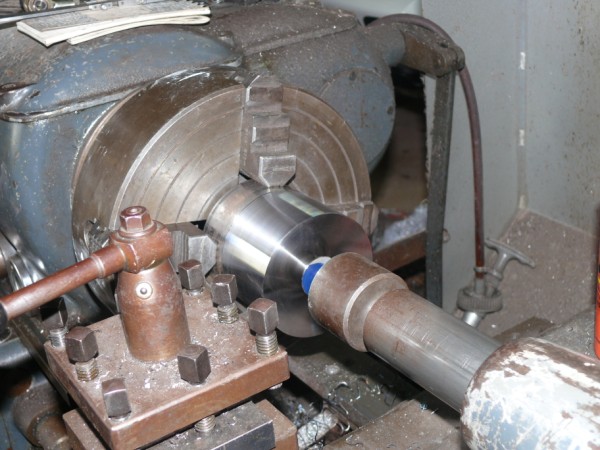

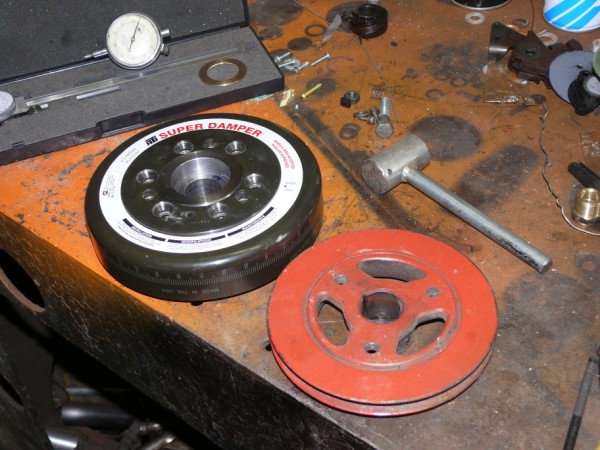

I'm fitting an ATI Super Damper. This is an inline 6 that has all the usual balance issues you get when you start to spin them over 7000rpm. The only balancers that are available to suit this engine are the std type, that are not heavy enough, or one made by Romac which is heavier, but still not heavy enough.

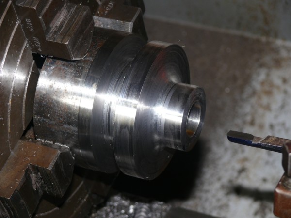

Now for an update. The 4140 is an Australian standard, the British standard is BS970-1955 EN19A.

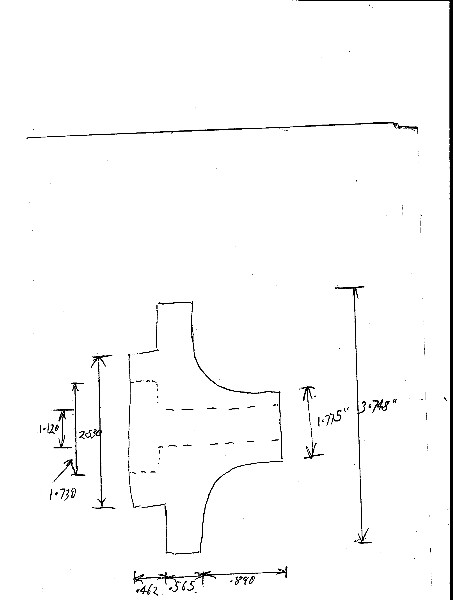

A plan of what the finished article should look like & some progress on the lathe.

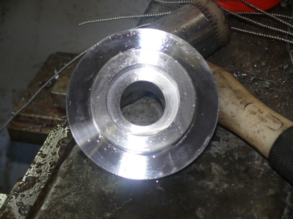

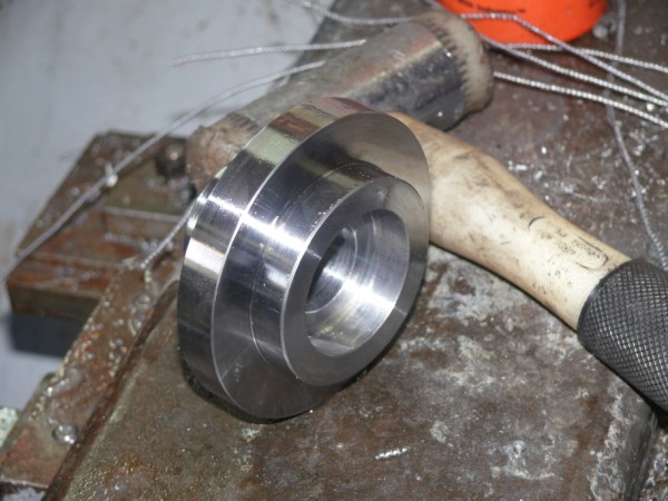

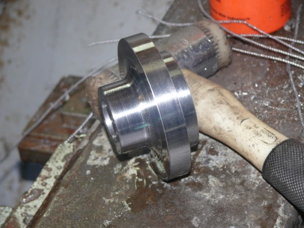

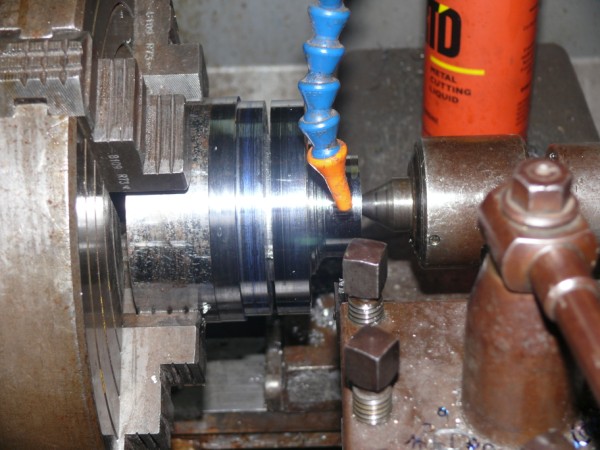

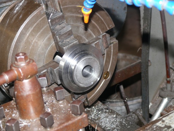

I've now parted the adapter of & turned it around in the chuck so that I can finish the other side.
Just need to broach the key way & drill & tap some holes to bolt the balancer to.

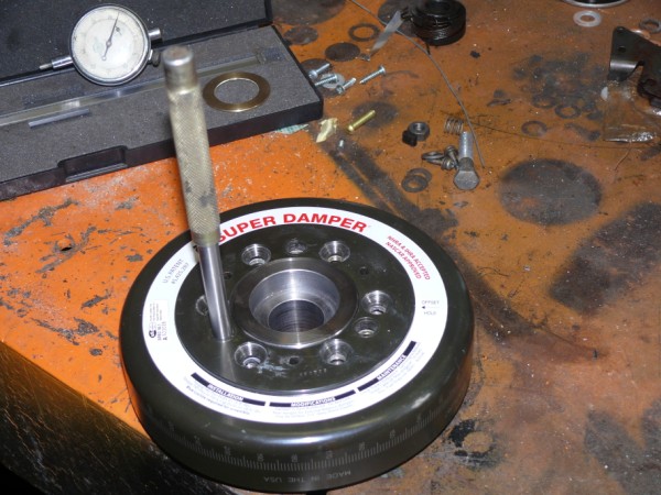

Bit of an update to my small project.

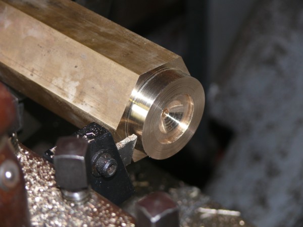

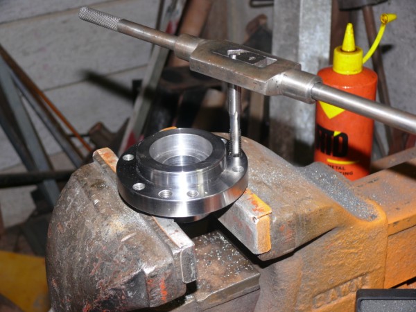

Using a transfer punch, I marked the mounting holes. I didn't take any pics in the drill, then tapped the threads, 3x 3/8" UNC & 6X 5/16" UNC.
Now I need to visit my good mate & use his broach to cut the 3/16" key way.
This the std balancer (2.5lbs)& the Super Damper(8.5lbs) for comparison.

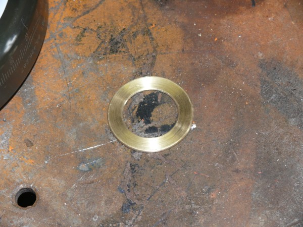

I then machined a .060" shim from brass, I'm not sure what this does, but was told some years ago when fitting a larger balancer to these cranks to use a .050"-.060" brass shim, as the cranks have a habit of breaking with the extra weight & this helped to stop it. Maybe some one may have an opinion on this subject.
