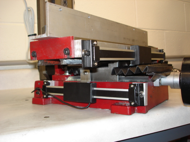

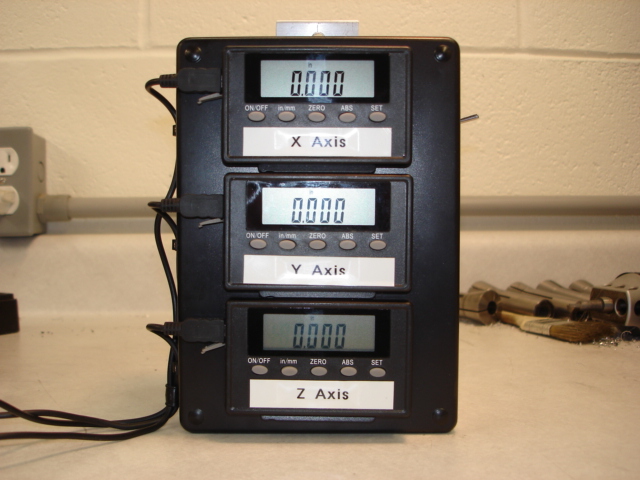

« Reply #24 on: December 15, 2011, 08:56:55 AM »
I posted from work the other day, and did not have the photos uploaded to my web site. Here are some photos of these installed on my large lathe.
I have not had a problem with metal chips getting into them, but I guess I could glue some felt wipers to them, that might not be a bad idea!
Dale
Re: New DRO's
« Reply #25 on: December 15, 2011, 09:37:05 AM »
Nice job!
I'm just waiting for funds to accumulate to a sufficient level to buy some for mine, after Ketan relieved me of £500 for a mini lathe the other weekend.... :D

Here is a sneak peek at my DRO system on the X2 mill.  The scales are installed, but the chip covers are not on in this photo as I still have some milling to do on them before they are ready to be installed.
I was worried about the life span of the watch batteries in the readouts so I soldered wires to the battery terminals and hooked them up to two "D" sized batteries.  Two "D" batteries cost $3.00 and should last over a year, while six watch batteries are around $19.00 and if they are like my calipers they will only last 6 months so making the up grade was an easy decision.
I should have the chip covers done by the end of the week and post pictures of the whole project.

Absolutely awesome, thats just what I would like to do with mine, given the time and money to do so. I like that very much, great thinking on the batteries too  :thumbup: :clap: :clap:

You did a good job on that, and those covers will keep anything off them.
