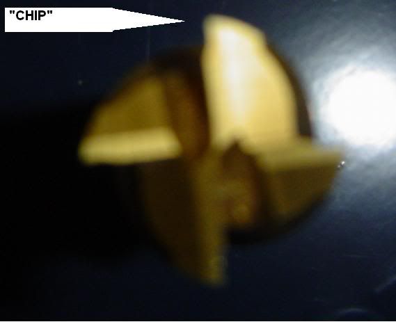

I received my large order of end mills from Richon Tools today. I purchased 32 cutters, in pairs, from 1/16” to 5/8”, 2 and 4 flute,  and some metric ball end mills. They came in individual plastic tubes, wrapped in a plastic bag, inside a very tough plastic outer bag.
I opened a few for a look. I was surprised to find several had what appear to be chips in the end cutting edge. At first I thought they were just the profile where the flutes met the cutting edge, but not all of them have this chip. Is this normal? I really don’t want to use them if they are damaged/defective.

Chuck, are the "chips" symmetrical, in the sense that there's one out of each cutting edge of the tools which exhibit them? If so, they are probably supposed to be there.
This pic of an unused Chinese endmill is very blurred, but you can see that the edge at 12 o'clock seems to have had a bite taken out of it. The other three are just the same, as is just about visible at 9 o'clock.

After digesting the input here and on a couple of other forums, I have concluded that the Richon end mills are not chipped. There were, however, a few other problems with the order. I had ordered a pair of 10 mm ball Nose end mills and received a pair of straight 10 mm end mills, one extra ˝” 2 Flute, and 2 extra 3/8” 4 Flutes and a substituted part # for the 3/16 4 flutes.
I emailed Peter at Richon to apologize for the misunderstanding of the “Chipped” cutting edges and point out the other errors.

I may be wrong, but it seems to me that the issue of the chip in the cutter hasn't been addressed fully. I have taken some pictures of some larger end mills showing the so called chip.
What you see is the radius ground on the spiral part of the cutter for clearence. Here are two pics. Not very sharp, but I think you'll get the idea.
Best I could do with a point and shoot digital. Hope it's helped to clear up the "chipped cutter" problem.

My 4 flutes are all like that.

Quite simply, the 'chips' are where the flutes finish.
Actually, they can't do anything else.
What seems to have escaped comment is whether the extreme edges are sharp and therefore ready to chip or rounded which reinforces the tool but gives a rounded edge on the work- which makes the work stronger.

I have a feeling I'm still not getting through with my explination. What you are seeing is not, I repeat is not a chipped cutter. It is the result of grinding the cutting edge of the spiral flute. Take a closer look and you'll see what I mean.

I did take an extra look at the latest of my cutters and they have exactly the same "profile" on the cutting edge. I noticed it in the beginning before use, but as the cutter felt sharp to the touch I did not  think any more about it. It does work well.
Taking a further look I find that on my cutters the extreme outside edge/corner is really sharp and could actually do with a very light rounding off. That would mean that I will gain two things - firstly that the tool gets stronger due to less risk of chipping the cutting edge corners, and secondly that I will get less sharp "roses" from the cutter on the surface = a better surface.
Coming to think of it, I took a third look - my eyes are getting strained now  :bugeye: - at an older cutter which does not have the small curve in the cutting edge. There I found that the flutes are ground in a different manner, and that ought to be the reason for the difference in cutting edge appearance.  Correct me if I´m wrong please.
