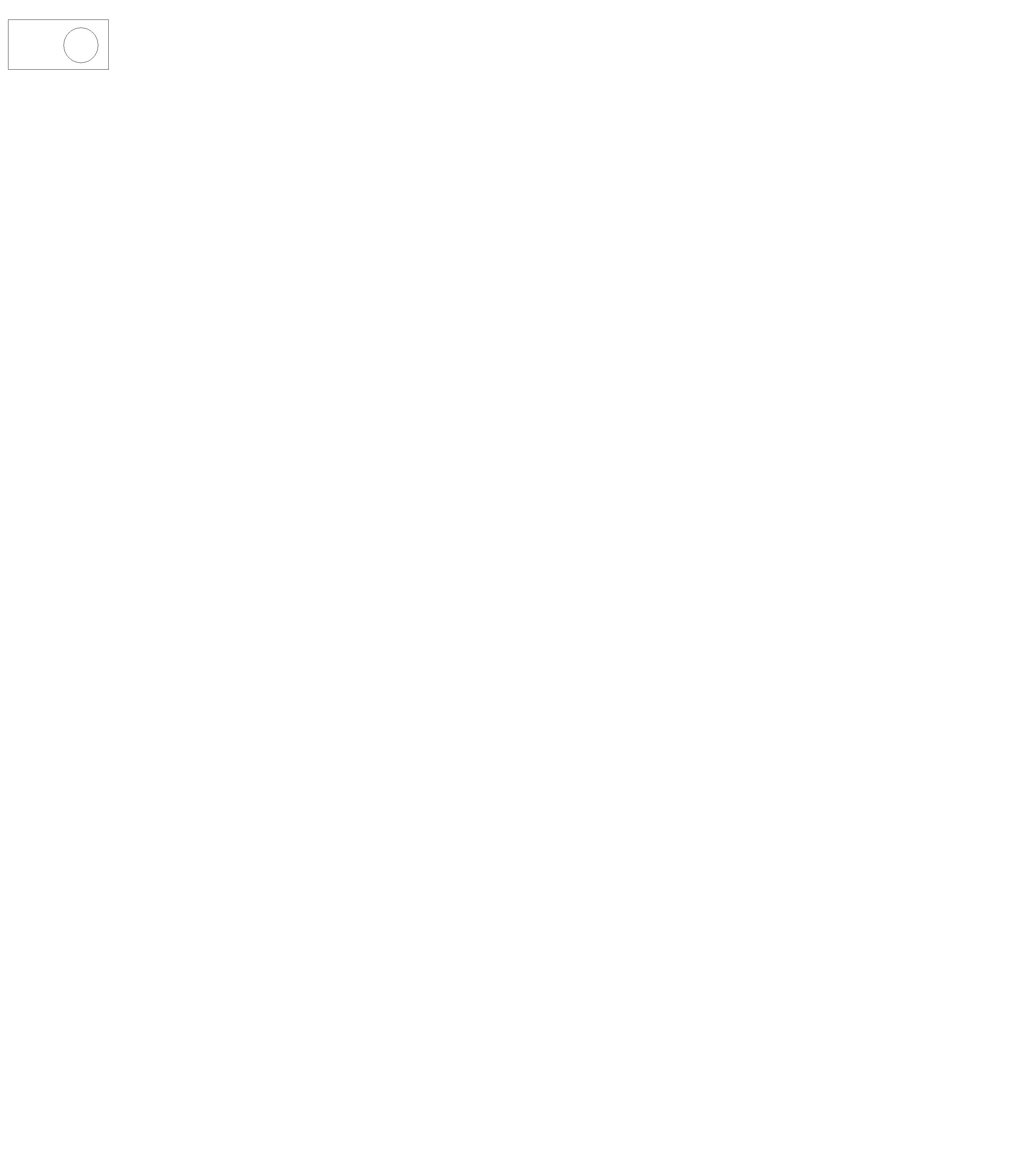

I think the answer to this one is obvious. I need to make a large hole in a piece of aluminium
(1 1/8" dia). But it is offcentre and has to be exact. I only have a 3 jaw chuck, but I also have a milling machine. Is there a way to do this on the mill (non CNC) or am I better of buying a 4 jaw chuck and using a boring bar? I might be able to get work to stump up for the chuck if I can find a way of justifying it, but if not what are your suggestions? I hope this doesn't sound really stupid
I don't think my picture came out right?
