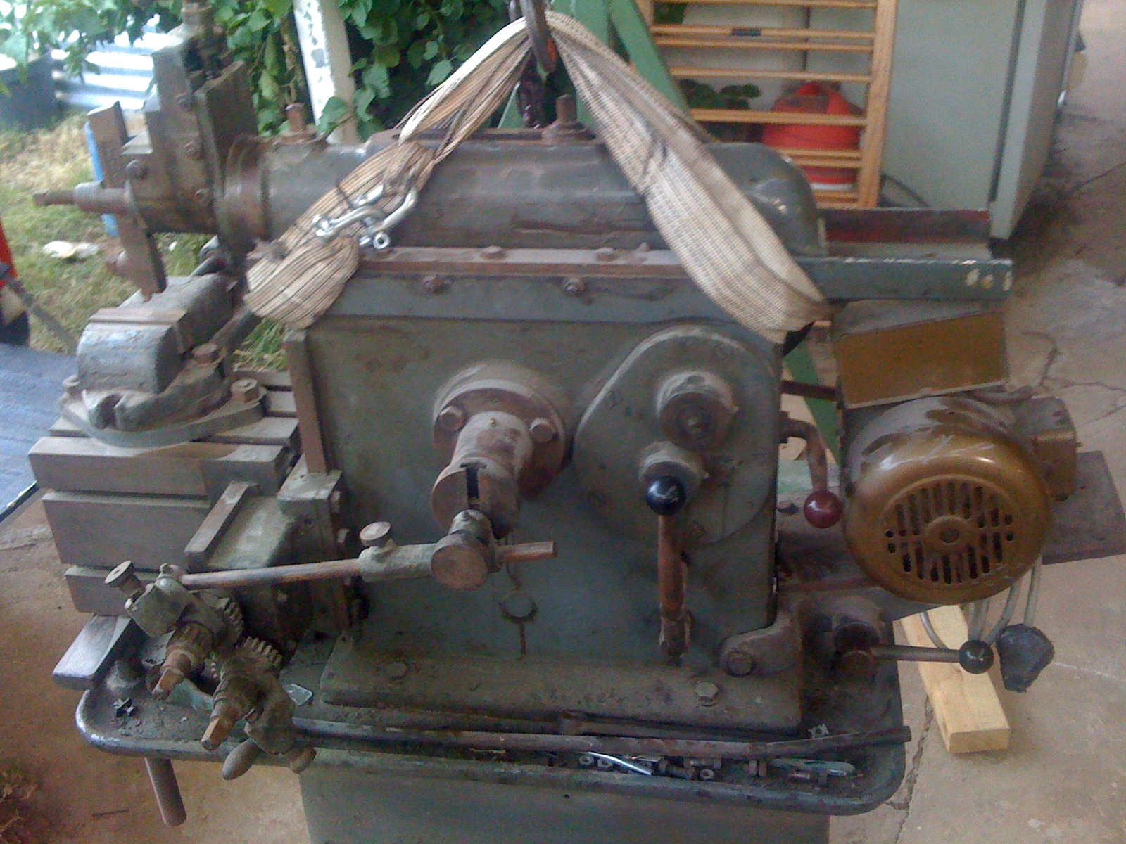

Hi Guys,

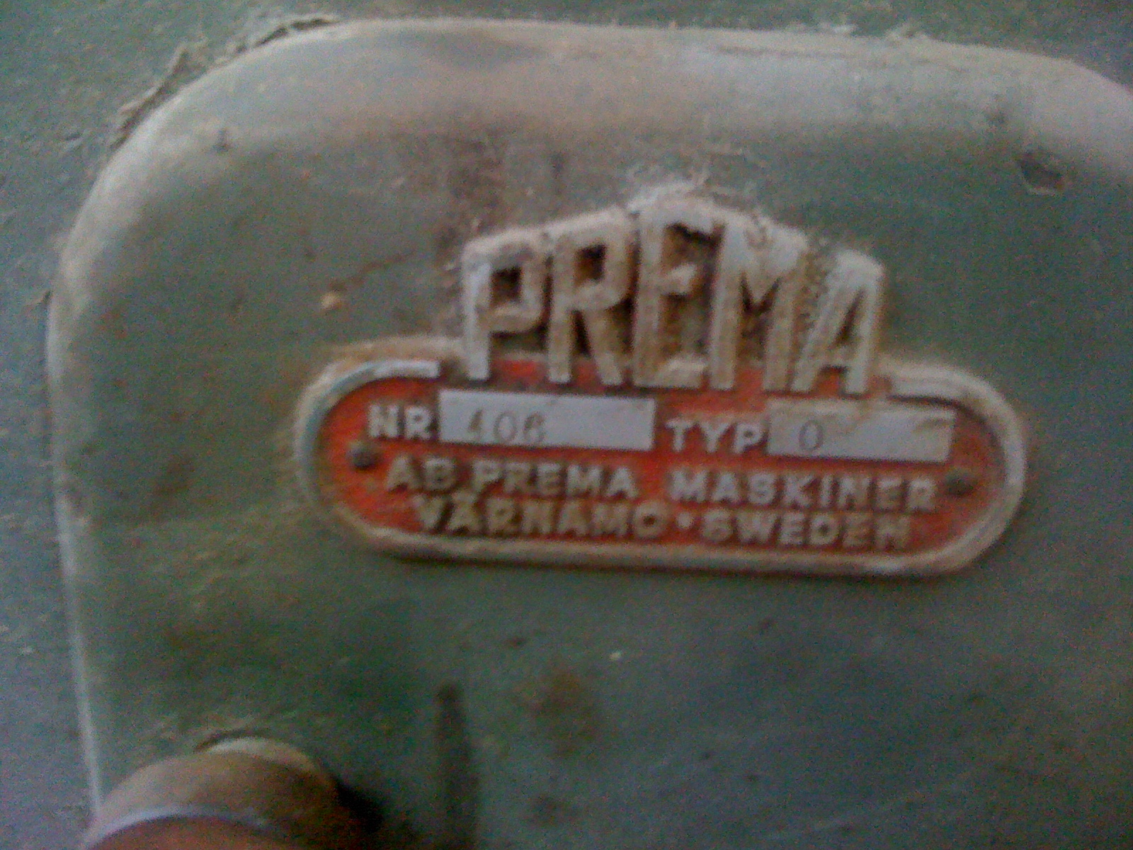

Just bought a Prema nr 409 type 0 shaper. Can anyone help with more info? I tried to register on the Practical Machinist site, as I see there was quite a bit of Prema discussion, but was rejected?

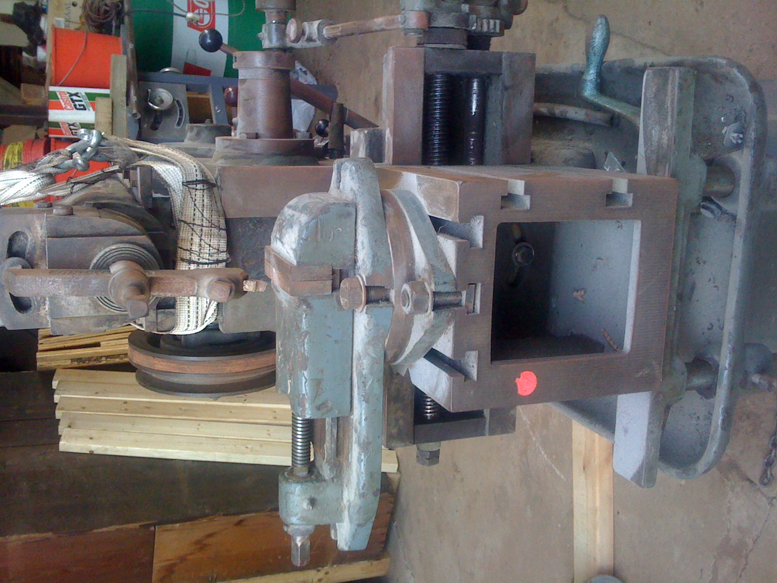

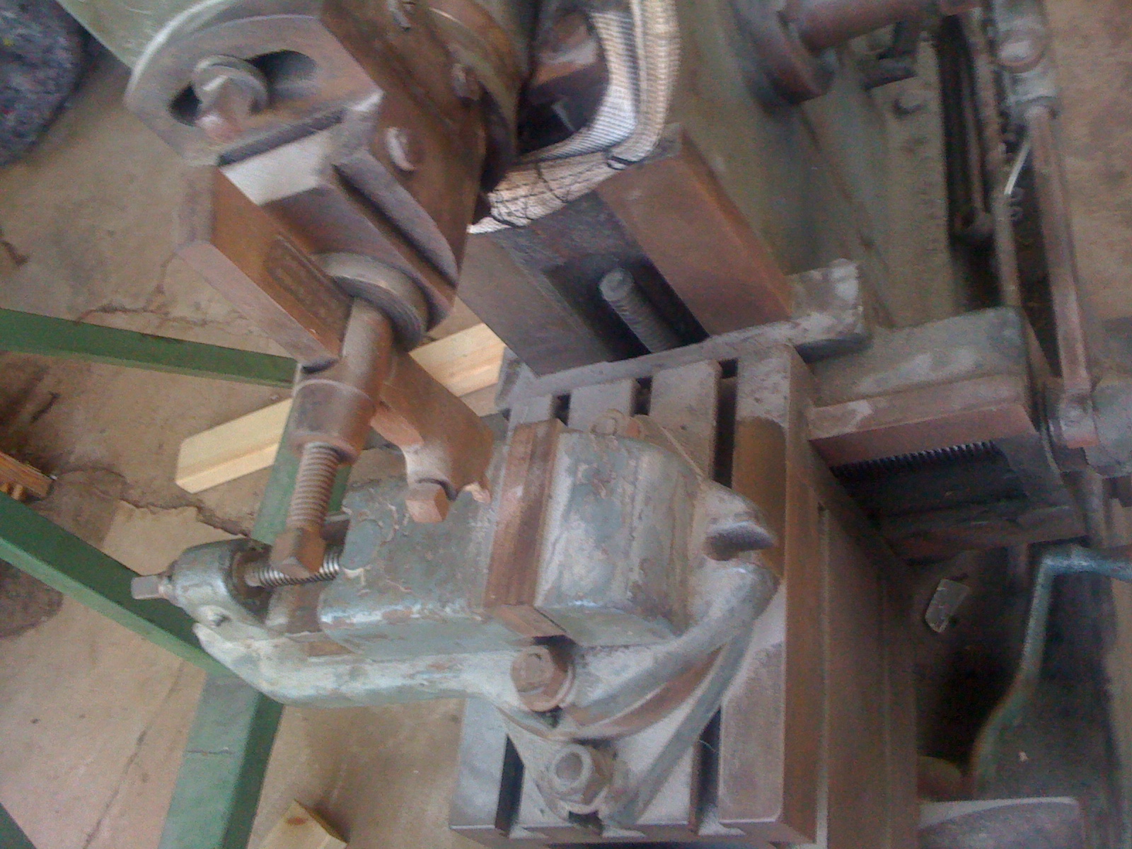

Anyways, the machine is in good nick. Has two gear speeds and two pulley speeds. Horizontal and vertical feeds which can be engaged at the same time. Not sure what the significance is of this but recall someone who was disappointed that his machine could not do this. Knee can swivel but not tilt. The ram seems to have a max travel of about 10" but 9" looks to be a safer option with less risk of striking anything. It came with a vise which can swivel but not sure if it is a propper shaper vise.
I fired it up and seems to run nicely although the clutch does still grip a bit when disengaged. Think it might be a bit of rust in the drum or the spring mechanism might just be a bit stiff. Will try and do something usefull with it the weekend. Only paid about $190 for it which I think was quite fair.

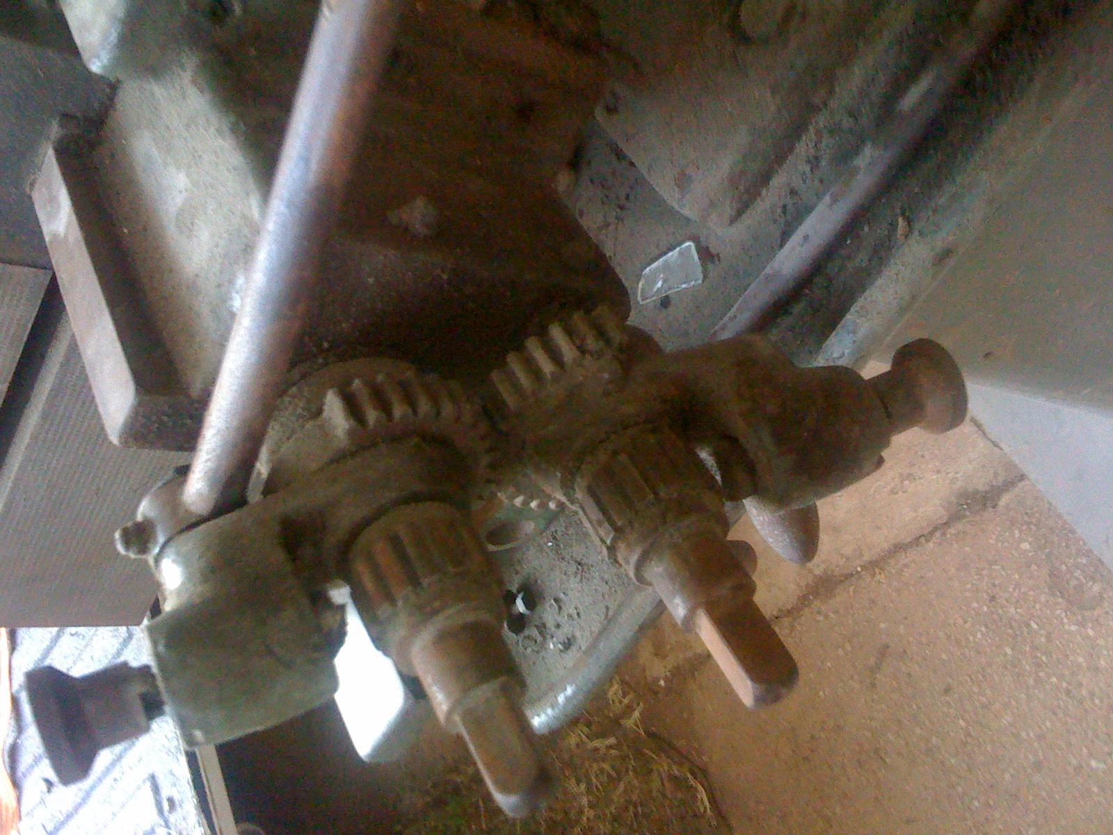

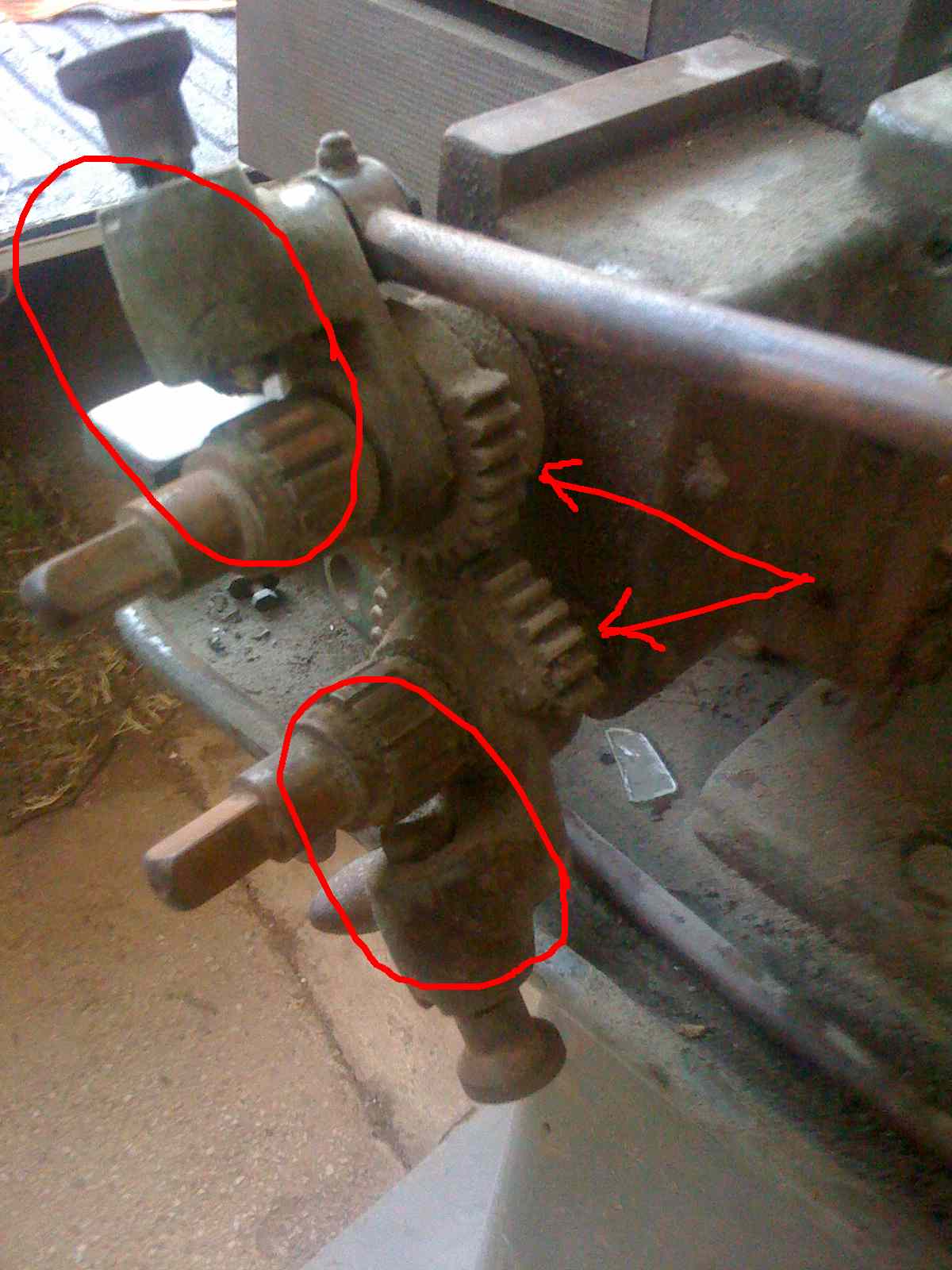

Are you sure about this? I can see only one feed arm. Normally to cut at an angle you will rotate the table.

The two feeds are linked by the half gears so driving the one automatically drives the other if the ratchet is engaged - look at picture 4 (CDC-2000-IF-3 001.jpg ) and you will see what I mean. I've attached an edited pic to show the critical parts.
