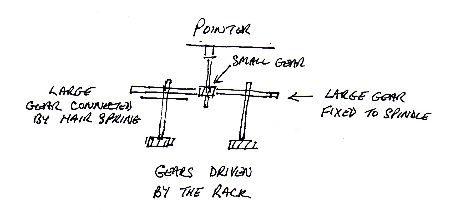

Hi Chris
it must be 15 to 20 years ago but from what I remember
two small gears are driven by the rack
one drives a large gear that in turn drives another small gear connected to the  pointer
the second gear train is the same ratio but the larg gear is connected to the spindle with a hair spring
this provides the tension to take up the backlash
I guess an alternative arrangement could use concentric spindles
edit   oops wrong indicator  but you still need to look for missing teeth , broken springs and pivots
