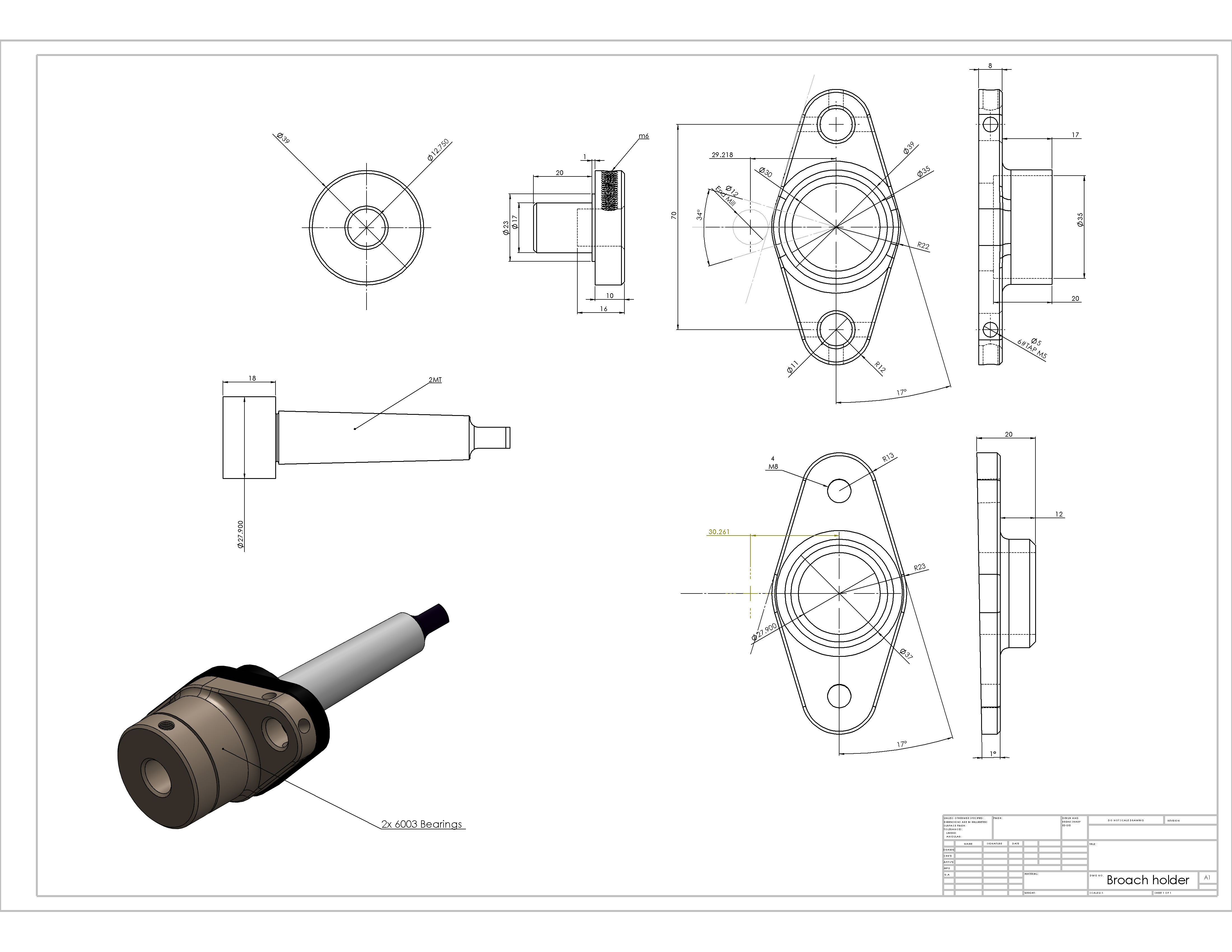

« Reply #12 on: October 29, 2011, 05:08:34 AM »
The doodle i used to make mine

« Reply #13 on: October 29, 2011, 07:44:02 AM »
Very Nice.  Can you elaborate on its function and use, how come you adjust the clamp bolts in 2 axis not one ?

Hi Joules
                  Joules
Did you not watch Bends video  :poke:  ,,,,,,,,,, its for poking odd shaped holes in things  :lol: :lol: :lol:
Ease of manufacture ,,,, other wise you would have to devise some other way of keeping perfect alignment on one axis
