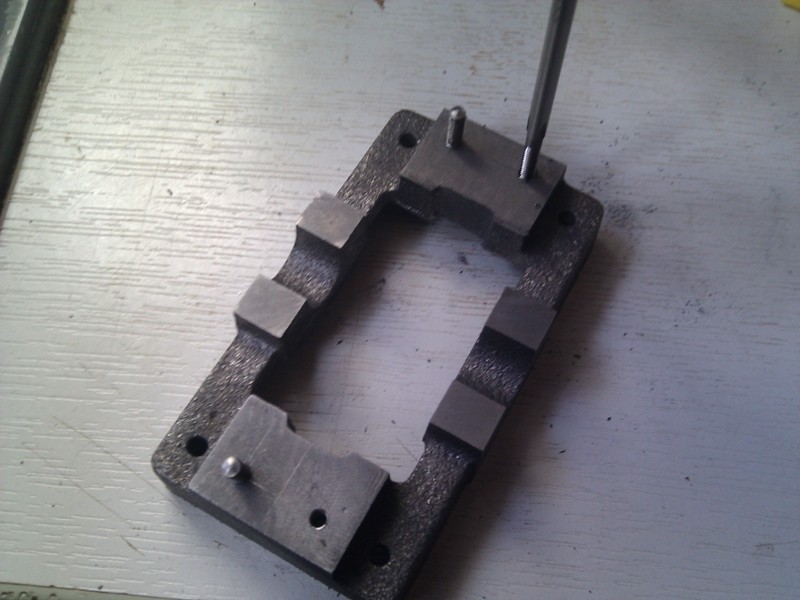

I will add some pics up later, but this post will contain my ongoing project of mainly my Stuart 10V build, but also bit and bobs that I do in the meantime.
Last night I decided to attack the kit, though some would say it was rather hasty after reading the book and not understanding what half of it meant.  :hammer:
So far i have milled down the top and bottom of the base, managed to drill and tap the base to 7BA and bolts actually went into them to my suprise. You need to remember I have not done this before so its all a bit exciting to me when something actually fits. i have also drilled the main bearing base, and to my shock, these holes actually lines up with the base and I could put all four bolts through to hold it on, now there was one happy puppy. I still need to take a tiny bit off the base to get it to size, but all feeling very pleasing so far, no cracked castings as yet, no missing fingers, life is great :)

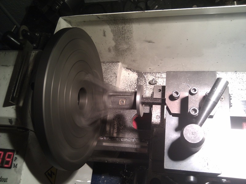

I also managed to attack the flywheel a bit as well, after a bit of filing, I stuck it in the 4 jaw chuck and managed to centralise it pretty well in the end, though this did take quite a while it appears the time spent doing that is worthwhile, as I managed to machine down half of the outer flyweel, one side of the flywheel, one end of the flywheel and one side of the hub top of the flywheel, as well as centre drill it and drill it, and yet again, to my complete amazment, the side I have worked on seems to run quite true, like a dog with two, erm, tails.... :)
I will try and post up a couple of pictures later, I know its not all that interesting and I know its not much to most of you guys, but it's my first ever work, and even if if it was turning down a bit of ally by 1mm, I would have still been chuffed to bits  :D

Thanks Andy. I think the enjoying myself is defiinately happening, the only downside is as like yourself, i have no one about to tell me if I am right or wrong, and no experience to of any of it, and everything is a first, I pretty much kack myself with everything i do at the same time as enjoying it, makes my heart go with each cut or movement, wondering if something is going to break, snap, fly off etc, working so close to the chuck frightens the ..... out of me , lol.
Can casting have different areas of material, as one part of the base just made horrid "hammer drill" type noises as I went over it, and it just didnt seem to "cut it", though changing the position of the work in the vice, changing the mill bit and changing the direction of cutting certainly seemed to help eventually, but I have no idea what caused it to happen?

That was me, about 18 months ago - brand new to machining, new (to me) mill & lathe... and all the same fears. In fact, probably the most risky time is as the fear starts to go away - cockiness can follow and you'll have a couple of broken tools or tool crashes on the lathe: At least, that's how it went for me. In fact, I went through a period of really not getting along with the lathe at all, everything was a damn struggle, nothing seemed to work; but, as my skill slowly improves, I now find it much better. BTW, the 4-jaw does get easier to adjust, but it's always a pain. On the other hand, so long as the jaws are holding straight, you'll always be more accurate with a 4-jaw independent than a 3-jaw scroll chuck. So if it's got to be bob-on to the nearest thou (0.001"), then the 4-jaw is the only real choice (unless your lathe does collets).
It's taken those 18 months, but I can be pretty confident now that I'm not going to break anything worse than a carbide insert, or take too much metal off whatever I'm cutting (which is bad enough).
As for your "hammering" issue; it does sound like you hit a hard spot in the casting. There are basically 4 things you can do in such a situation: a) Faster spindle speed, faster feed; b) Faster spindle speed, slower feed; c) Slower spindle, faster feed; d) Slower spindle & feed. Picking the right one is simply a matter of trying them (probably the slower options first) and seeing what happens. Beware blunt tools in steel! If your cutter and/or workpiece is getting murder hot (enough to discolour, or if there's visible redness in the tool), then your cutter is blunt and ruined; don't bother trying to carry on with it, put it in the "to be rescued" pile & carry on with a new cutter.

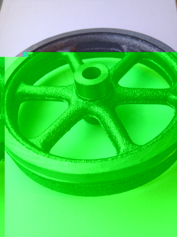

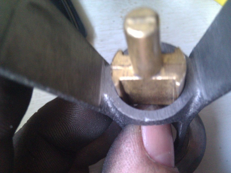

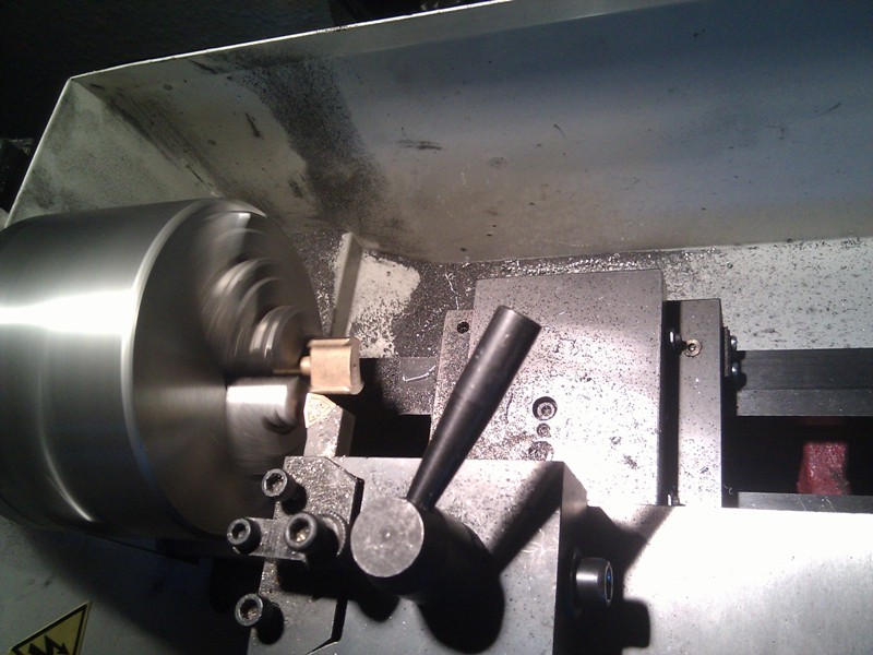

« Reply #12 on: October 22, 2011, 10:08:05 AM »

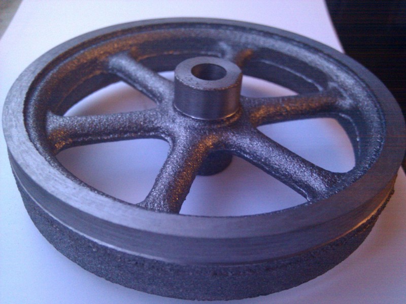

Next on the agenda today was to do some more to the flywheel of the Stuart 10V, and here is how its going to be other than a bit of paint or varnish and a parting tool of some description down the middle of it.
Unfortunately the 5ba grub screw was missing from the kit, so I has a bit of steel bar, and a ba tap and die set, and sat down and made one myself.
Also the 7mm bar to do the work between centres, all I could find to hand was 8mm, so I had to turn that down to 7mm before I could start, all the joys of it all, lol

« Reply #13 on: October 22, 2011, 10:32:30 AM »
Very nicely done Steve!  :clap: :clap:
The best practice, is in the making of widgets. This builds your confidence for the important, (mustn't be scrapped) work.....  :palm:
The flywheel looks very good!  :thumbup:

Cheers Dave, glad you like the flywheel, I must confess I am quite chuffed with that as I managed not to break it, it all seems to be running fairly straight and is drilled to the right size as it just about goes onto the crankshaft, I am sure it could be much much worse. Once I get my new parting tool I am hoping to put a slot down it.
Its been a very good day today for me, these little nick nacks as you say, do build the confidence a little and of course build experience which is something I seriously lack. Today I had part of the lathe pulled apart as it had some slack in it, I ended up replacing 2 stripped screws and tightening up a few bits here and there. I cant say what everything is called as I have no idea, but where it slide back and forward and whre it slides side to side and has 3 adjustable screws to make is slide properly, all had to be adjusted on both bits. I have absolutely no idea if I have done this right or wrong, or even if I was supposed to, but its made everything less slack feeling but nothing appears to be binding when turning the "knobs" and "stuff". This is when it would be really useful to have someone experienced about to say if I am doing right or wrong, and to show me once, how to do things and what to do and what not to do. Its really difficult when you simply don't have a first clue, just general knowledge and guess work, lol

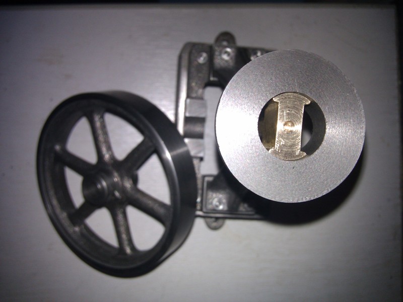

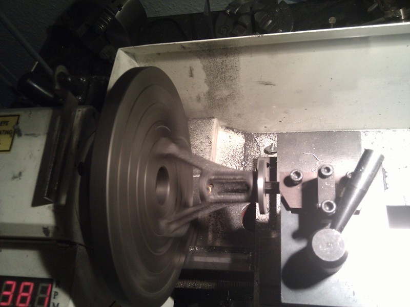

« Reply #15 on: October 29, 2011, 12:40:56 PM »

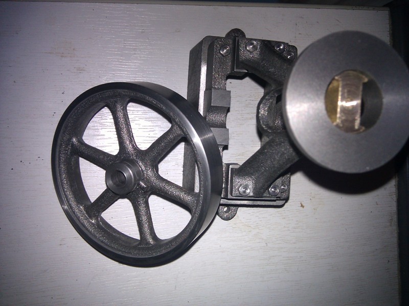

Well I dont know what happened to all my previous pictures, they all seem to be missing :(
Anyway, I spent some time on the Stuart today, and managed to get some bits and bobs done.
I polished up the flywheel a bit.
Managed to get the main stantion machined out and topped and bottomed as well as the brass bit in the middle done too. I have no idea of the names, but I have some pictures below :) Its quite a good fit not too tight but not loose either, a bit of oil and it slides in and out quite nicely, though it will need some running in. I managed to get some more tapping done and some more bits bolted together. This is my first use of my lathe and mill, so I don't expect everything to go quite as well as it did today. :)

Looks like quality work to me!
Remember everyone has been new at this some time and the gents on here is top notch, so no need to be afraid to ask questions or tell about the mishaps. Usually you'll get loads of good advice on what to do to avoid that in the future!
Henning

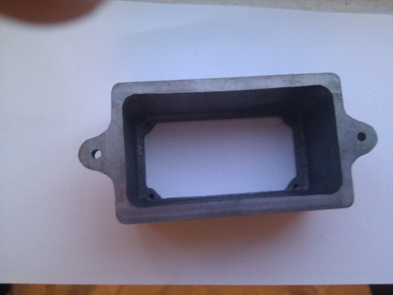

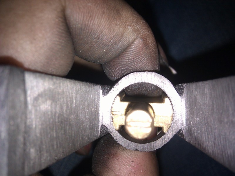

Well, first boo boo was made today......  :(
I had a go at the cylinder block, I was really struggling to try to work out what was level when it came to the top and bottom as neither was flat. After a bit of faffing around I "thought" I had managed to sort it out (mistake no. 1). So I faced up both ends and the steam block side. By the time I had finished milling both ends to try and and it flat I ended up a little short on the cylinder block, nothing major though a little disappointing (mistake no.2). Well, then it was time for the bore, never having done this before I took a "best guess" at the cetre of the hole, BIG mistake (mistake no.3). I took measurements from whe existing hole assuming it was central  :doh: It wasn't. I ended up with a near prefect bore of .750 through the clyinder block, the only thing is, not only is it offset from true centre, it also goes through the cylinder block at a slight angle  :doh: Looks like a new cylinder casting is in order.....though....I may continue onwards and see what happens as I "think" it will still go together and "may" even still run, Its just that the tops and bottom of the cylinders will be offset and the piston will be going up at a maginal angle. Oh well, we live and learn, certainly not put off and consider it a bit of a lesson in needing to take my time  :D

Steves, that is happend to us all.  :Doh:
When you aree going to drill the cylinder, you can not expect from the hole, you must measuring from edges. I little tip is, piece of wood and fill the hole, then it's much easier to center the cylinderhole.

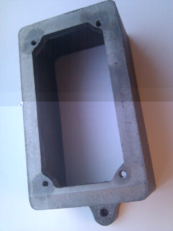

« Reply #24 on: October 31, 2011, 12:22:26 PM »
Well despite my little knock back yesterday, I had a day off today and did a little more between things.
I managed to do the tops and bottoms of the cylinder, the only bit left to do is tap the bottom one with an ME tap. Of course I need to drill them and then tap the cylinder liner as well.
You can see how far my cylinder bore is out on these, though it look worse in real life than on the pictures..

Well, despite having my lathe working much better than ever before I made a couple of MAJOR BOO BOO's with the Stuart 10V :(
1) I went to mill the steam chest face, forgot to put the Z lock on and ended up with a lot more metal removed than anticipated, so much so that it has far more taken off one side than the other, not the end of the world I thought, a few modifications here and there and its not really a problem.
2) Much smaller, yet bigger and catastrophic mistake.... I drilled the steam chest for the eccentric guide rod, centre drilled it and all that and the first hole was no problem. however, that hole continues at the top of the steam chest dome. Now this was using a 2mm (ish) drill, having it quite a way out the chuck in the tail stock as I needed the length to reach the top of the steam chest, the drill was so flexible that it caught on the rough surface and put it off centre and continued to drill off centre, no problem I thought as the rod will still move ok. What I didn't take into account was the brass block which moves the steam from top and bottom on the eccentric, this needs to run flat at all times creating a steam tight seal, this now can not happen as the rod moves at an angle and is lower at the top than the bottom. Its a great shame as the outside of the chest was near on a days work and looked super by the end of it, but it just wont ever run like it.
My options now are to order a new steam chest and do it all again, remembering to file the inside of the steam chest before drilling it, and drill the eccentric rod hole first with the bigger drill it needs and then use that thicker drill to create a "dimple" in the top of the dome for the small drill to start from.
Very gutted at the moment and no sure what to do next, I think a call to Stuart may be needed to order a new chest.... :( I am more gutted about all the work that went into it, and now it has to be binned...
The other option is to have it as a decoration piece only as it would still turn by hand, and probably air/steam if it were under enough pressure, lol :)
Oh well, the saga continues, lol....
very new to all this....
Offline AndyB
  • Posts: 192
Re: What I am working on
« Reply #37 on: November 07, 2011, 04:34:30 PM »
Hi Steve,
We have all done it!!!!
Don't be disheartened; you may be able to rescue it by drilling oversize and plugging, then restart your proper holes. I did that with a broken tap in an aluminium casting.
And if you can't, don't bin it, there is a lump of metal there that is crying out to be made into something, even if it not part of this engine!
It is all a learning curve and you seem to be getting on much better than me! :clap: But! Take your time and work out what can go wrong before starting and that will give you loads of ideas about which way to go and what you have to check before you start.
Only my tuppence worth...
« Reply #38 on: November 07, 2011, 04:57:39 PM »
Stive
Like andy says drill it out and put a plug in it
Or turn a fancy brass bit for it and screw it in

« Reply #39 on: November 07, 2011, 05:05:58 PM »
Hi Steves.
Sorry about your'e mess, but we have all been there.  :Doh:
The steam chess is a little tricke part of the casting to machine, but I belive that you can repare by follow the tips you have got here.  :headbang:
If you can't do it, you can always order a new one from Stuart.   :D

« Reply #40 on: November 07, 2011, 05:45:40 PM »
That's a real bummer mate,  :Doh: but, as has been said, try the plug and redrill trick. :thumbup:

« Reply #41 on: November 07, 2011, 06:01:33 PM »
After you've plugged the existing hole, you might want to consider turning a steel rod the diameter of the required drill, putting a point on it, and using it as a center punch to mark the plug so the drill starts at that point.
 Now why didn't I think if that  :doh: I was thinking, well there is no way I can centre drill it, or use a centre punch as none will fit down the hole, I just never even considered doing that, this is just a total new way of thinking  :Doh:
Thank you  :)
