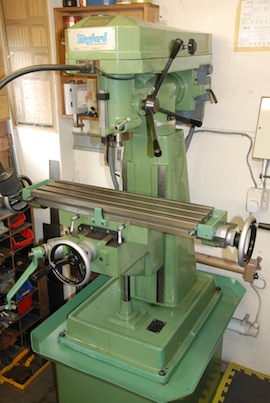

« Reply #496 on: November 03, 2012, 05:25:28 AM »
Lovely work on the cabinet Rob  :thumbup: don't know how you do it!
One of these has come up for sale:
Looks to be a 626 with a myford badge on it, the VMC, made in Taiwan. Do you reckon it'll be any better than any other 626? It's not cheap, about 2/3 of the cost of a new one. Lathes.co.uk only has a short paragraph and reckons the only difference is that some myfords were fitted with uk switch gear and motor.
Cheers,
Nick

« Reply #497 on: November 03, 2012, 06:10:32 AM »
Nick, I've had one of these from new in around 1987 and is the target of my CNC conversion thread on the forum.
http://madmodder.net/index.php/topic,7345.0.html
It is essentially a 6x26 but without the fine quill feed wheel - a feature that I've not found a problem.
Naturally it will have similar design compromises but in order to earn the Myford label, they were imported into the UK and stripped down by myford and the slideways scraped and generally given a check over. Mine also had a British/eu motor fitted as at the time, Chinese ones had a bad reputation. I had one on a drill press that was badly balanced and soon became a doorstop.
In any case I now run the VMC with a 3 phase motor and inverter.
The machine in the photo looks very clean and has possibly had little use as the paint usually gets stained by oil/coolant etc on hard worked machines.
Provided the feedscrews and nuts are not badly worn, I'd say it is worth getting at 2/3rds new price.
Note that spares will be no more available for it that warco/chester machines.
If you are looking for a target for CNC conversion there won't be much that Rob supplemented by my project experience won't know about the task. Feedscrew condition will then be irrelevant.
hth
Bob

« Reply #498 on: November 03, 2012, 10:26:43 AM »
Hi Nick
I am pleased Bob chipped in on this as he is better placed to give you advice on the build quality of Myford machine , I would expect it too be built to allot  better quality  than the two Chester 626 machines i have  come across .

« Reply #499 on: November 03, 2012, 10:30:22 AM »
Because of it's age the Myford machine would have been a Taiwanese based machine which at that time were of decent quality.
The Chester / Warco machines being made now are Chinese and depending on the factory they are produced at could have differing quality.
