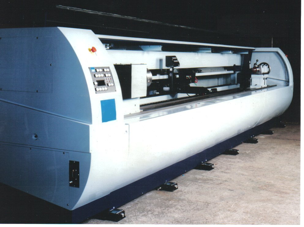

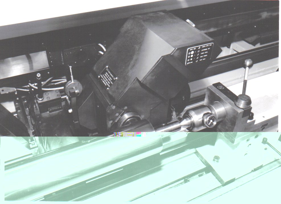

I've only just noticed this thread, very interesting. I used to work for a firm making laser 'engravers' - actually a large (6m long x 500dia x 5 tons max) lathe-like machine for cutting away the surface of printing rollers (rubber flexo and ceramic 'anilox'). It used typically a 2kW CO2 laser, but was generally the same technology as what you are using, physicas is physics, large or small.
