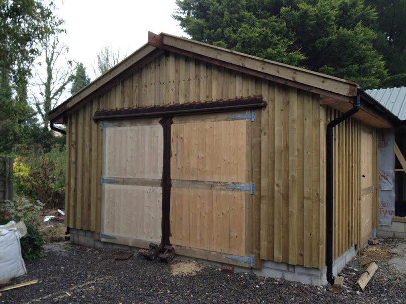

Hi Chris,
Just a quick question; The ground ends of the cladding boards looks to me to be cut straight off without a drop-nose, or do they have one? If not I think you should do that as it prolong the boards life very much.
BR
/Peter
Offline ChriX
  • Posts: 72
    • My wiki
Re: Building a shop
« Reply #77 on: June 18, 2012, 03:29:58 PM »
Hi Peter, thanks for pointing that out, they do have one already. Probably about 30 degrees.  :beer:

« Reply #82 on: August 09, 2012, 05:01:59 PM »
Hi all.
A quick update with a few more photos for you. All of the jobs now seem to be quite time consuming but don't appear to show as much forward progress as the earlier stuff. I.e. laying a floor only takes a day and is huge progress, but building a door and hanging it takes a whole weekend!
We are getting to the point where the outside is almost complete - just that last bit of cladding and window to go in and a few roof ridge pieces and we are there. After that we can work in any weather in the warm and dry.
I have ordered second quality Kingspan to fit between all the studwork, which will then be covered with 1/2" shuttering ply.
Chris

« Reply #83 on: August 09, 2012, 07:28:26 PM »
I'm soooo envious!
Did you leave one of those double doors out in the sun?
Offline ChriX
  • Posts: 72
    • My wiki
Re: Building a shop
« Reply #84 on: August 10, 2012, 04:05:18 PM »
Hi Andy - no one of them has just been on a lot longer than the other one! I guess you could say it's been left out in the sun in that case. We put one up then I went away for a couple of weekends in a row so the other didn't go up until this past weekend.

« Reply #94 on: October 20, 2012, 05:20:55 PM »
The lining out of the walls is now in progress - 1/2" ply.
This is an area we have just cleared and dug out ready for the 'extension'... basically it's going to be an open fronted area just to use up the spare roofing sheet. This will have parking for a car, plus it will house the compressor and dust extraction units, possibly even the phase converter as well, basically all the noisy stuff.
Sorry photos are a bit blurry, it was getting quite dark when I took these.
