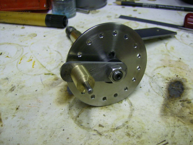

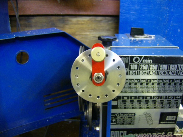

turning the flywheels, using a piece of 2.5 hot rolled, turned to a smooth finish, two blanks cut about .400 thick, drilled and reamed in place, so the bores align with the o.d.'s  They both got put in a V block and drilled and reamed for the crank pin, .750 from the mainshaft holes for an inch and a half stroke.

Thanks for all the kind comments, I will try to make this as interesting as possible as I move forward.  Having turned, cut off and reamed the flywheels, I discovered my reamer was cutting a bit over sized so I tried to use locktite to take up the mainshaft space and ended up with the wheels out of whack, and had to turn down two shafts oversized by three thousandths for a locktite press fit, while turning the shafts themselves half a thou under for the ball bearings to slide on, but it worked out well, with the crank pin hole reamed with a different reamer, on size

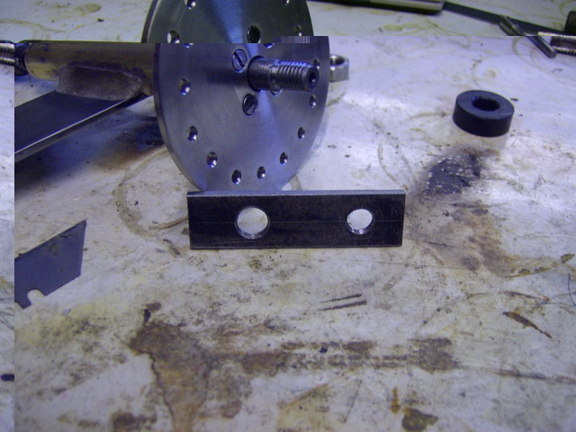

http://i894.photobucket.com/albums/ac150/madjackghengis/_0044-3.jpganother flame eater project

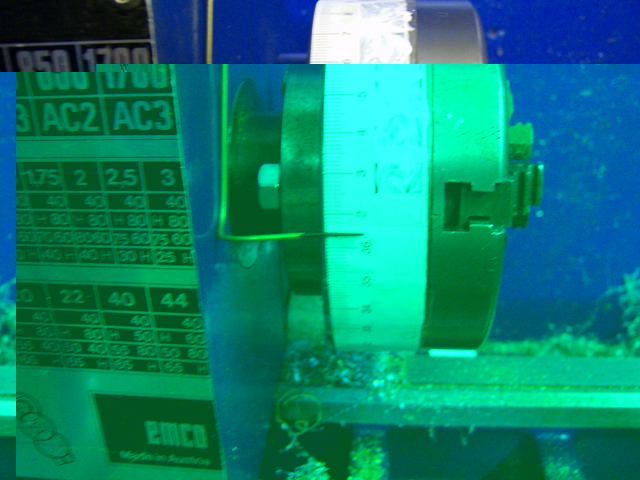

Now, measuring between the wheels, I've got about an extra six thousandths, so I'm making the two piece rod end out of quarter inch brass.  It is made with a tongue and groove, tightly fit, and soldered together for machining the crankpin hole, the rod end threading, and the bolt which will hold it together when complete
http://i894.photobucket.com/albums/ac150/madjackghengis/_0045-3.jpganother flame eater project
the first piece is milled with a slot with a 1/4 end mill, and then a couple thousandths taken from each side for clean up and smooth surfaces.
http://i894.photobucket.com/albums/ac150/madjackghengis/_0046-3.jpganother flame eater project
The second piece is the "tongue, which is machined to a snug fit in the slot, and the two pieces cleaned up with a file so there is no visible light to be seen between them.
http://i894.photobucket.com/albums/ac150/madjackghengis/_0047-3.jpganother flame eater project
Ensuring no excess end room is essential to proper bearing clearance lasting for any length of time so a fine file and care is the key here.

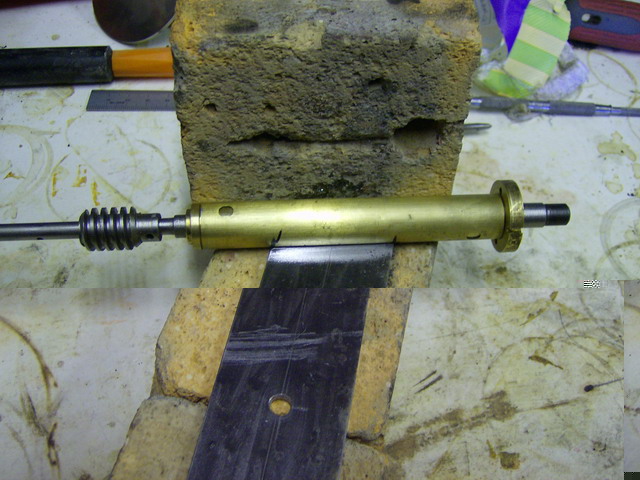

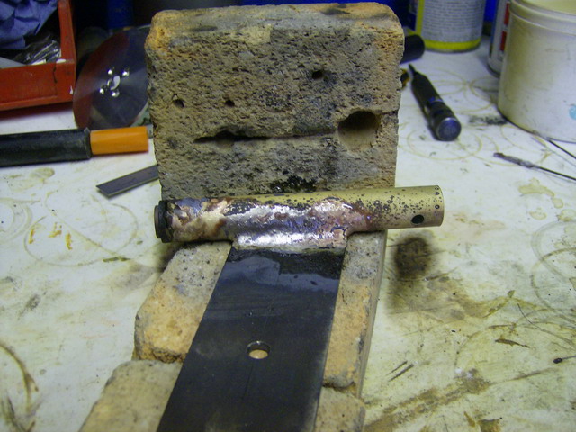

http://i894.photobucket.com/albums/ac150/madjackghengis/_0049-3.jpganother flame eater project

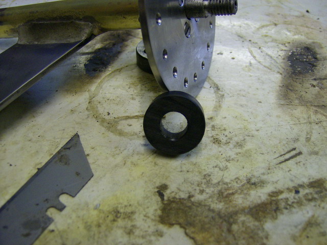

I've laid the two pieces on a piece of graphite square which came from a water pump, and makes a good soldering heat pad which doesn't get damaged, and cleans off nicely.  The two pieces are wiped all over with zinc chloride, particularly between faces as a good general flux.  I use SN63/Pb37, high end electronic solder as it flows the best and wicks into the smallest spaces.  It's not good for structural strength, however its wicking ability and low temperature often make is useful even in such situations, although this one is just a matter of ease.

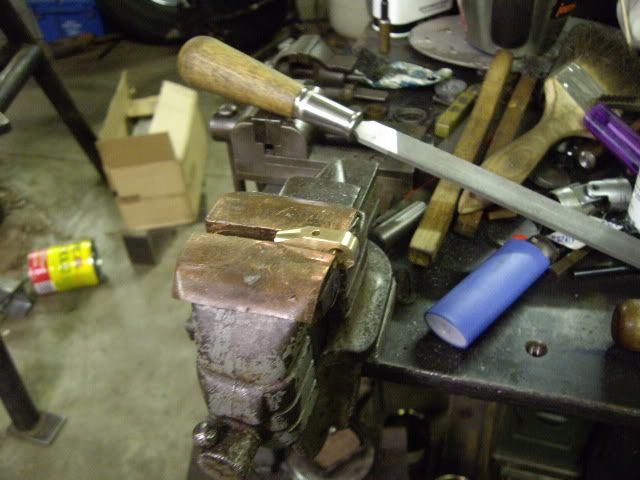

http://i894.photobucket.com/albums/ac150/madjackghengis/_0048-3.jpganother flame eater project
Soldered together, I use a six inch file to remove the excess solder and to get the faces flat and parallel.  With Optivisors and a scribe, I mark the location of the crank pin hole on the solder line at the end of the tongue measured right in the middle.  This will be step drilled and reamed for the quarter inch crankpin.

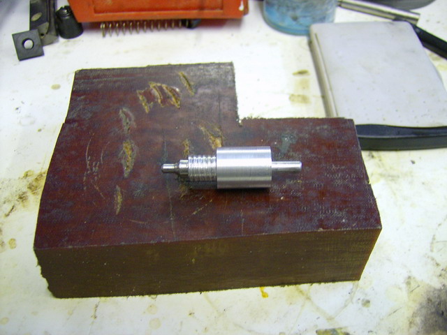

I centered the rod end in my four jaw to drill and tap it for the rod, and to turn a taper on the blunt end of it, making it prettier since we all like pretty, right?
http://i894.photobucket.com/albums/ac150/madjackghengis/_0053-3.jpganother flame eater project
Cutting the taper is mainly an exercize of not cutting the jaws and stopping when it looks "pretty"

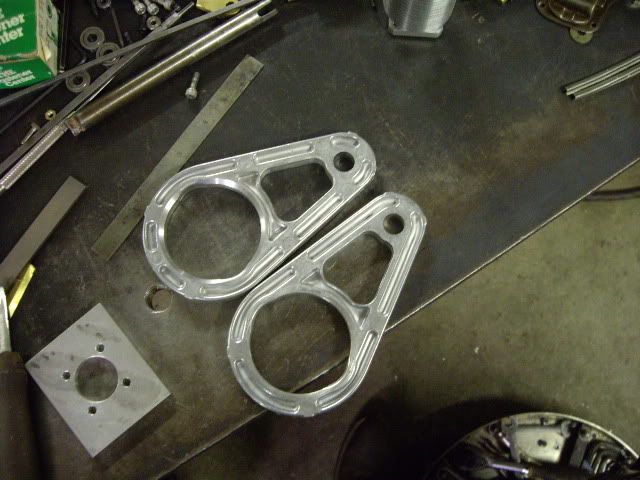

They are matched forgings of aluminum, the large circle is about 2.200 and the small hole is .480 they need a home, as their last one broke open, and they look like engine parts, what more could a fellow ask for?  I took a scrap piece of 2.5 steel bar, turned a shoulder to take the big holes, found a bit of distributer shaft which was a push fit in the little end, then clamped the pair on the jig on my mill table, and using the wiggler, lined the centers of the two holes up so I could get the cylinder base mount holes in perfect alignment.
http://i894.photobucket.com/albums/ac150/madjackghengis/_0002-26.jpganother flame eater project
with this, now I have to make the new cylinder base, setting it up for the four cylinder holes and the four frame bolt holes in the edges.  The plate will also be scalloped on the sides for bling purposes.

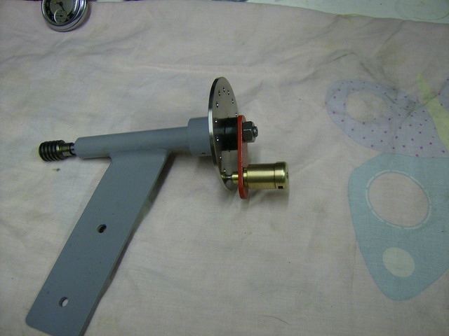

with the bearings fit on shafts an extra cam from my last engine, testing the fit of the frame and setting up end play for the mains
http://i894.photobucket.com/albums/ac150/madjackghengis/_0018-15.jpganother flame eater project
Another shot of the partial engine, ready for valve train work
http://i894.photobucket.com/albums/ac150/madjackghengis/_0006-20.jpganother flame eater project
in this position I see a way to run the valve, I just need to mill that fancy curve so the inside ends of the frame mounting holes are exposed, and a shaft matching the i.d. of the tap drill will pivot between the two mount bolts, which can establish fixed end play.

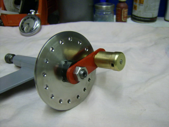

a series of shots of the big end of the rod completed and fit to the crank pin
http://i894.photobucket.com/albums/ac150/madjackghengis/_0014-19.jpganother flame eater project
the rough assembly with the cylinder plate milled for the valve shaft, almost just like in the "Poppin", just slightly different.
http://i894.photobucket.com/albums/ac150/madjackghengis/_0013-20.jpganother flame eater project
I measured the distance between the mount bolt ends, turned a shaft to match the tap drilled holes, and with the intent of having both ends of the valve gear 180 apart, I clamped the shaft in the vise, centered over it, and drilled and tapped two holes for the two levers at #0-80.
http://i894.photobucket.com/albums/ac150/madjackghengis/_0011-21.jpganother flame eater project
Since I changed my frame idea, I had to make a new con rod, to match new dimensions.
http://i894.photobucket.com/albums/ac150/madjackghengis/_0015-17.jpganother flame eater project
With the valve shaft in place, it is easy to take some 1/16th drill rod, thread both ends for a valve rod, to carry a .006 in piece of feeler gauge, and thread one end of the leftover drill rod, and watch the valve movement with the cam pushing merely against the drill rod, bent to bear on the aluminum bronze cam.  It worked so well I decided to make a judicious cut, then carefully bend the end of the rod around a piece of shaft, and have a round end of rod bearing directly on the cam, and in setting the timing, found the cam fits well with this arrangement, and is a very light and easily moved valve set up.
I kind of sort of want to put this engine in some sort of vehicle maybe, so while it is complete except for mounts, I found some scrap pieces of stainless with a bend, and cut mounts out of it, for it to stand on for now.
http://i894.photobucket.com/albums/ac150/madjackghengis/_0002-27.jpganother flame eater project
Feet straight up, resting
http://i894.photobucket.com/albums/ac150/madjackghengis/_0001-27.jpganother flame eater project
lying on its back, you can see the loop which is the cam follower
http://i894.photobucket.com/albums/ac150/madjackghengis/_0003-25.jpganother flame eater project
on it's side, showing all.
Well, got to get to work, somehow I didn't get a shot of it on its feet, but I'll be posting a video tonight if I get the chance.  Thanks for looking, hope you enjoy it as much as I do.  cheers,  :beer:  mad jack

It really is a good method of making the big end that. I didn't bother with the soldering on my two but the outcome is better with soldering - a lot less room for error when drilling for bearing and pinch bolt.  :thumbup:
I have to say Nick, that's one of the nicer rod ends to make and to hold up well with time.  I like the tightness of it when it first fits, it shows it will work in, and still be a good snug bearing fit.  The soldering is just the icing, but it sure does the trick. jack
