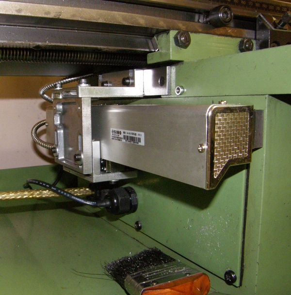

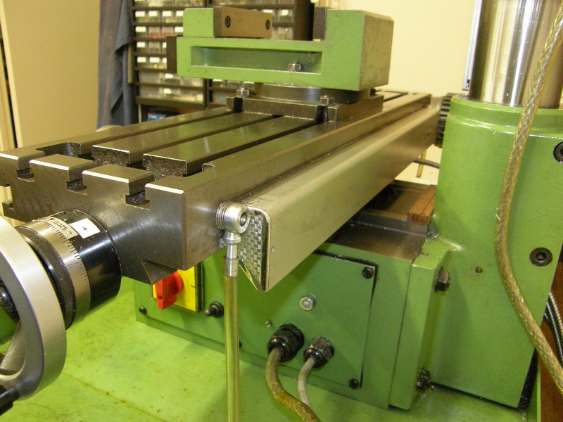

I recently fitted a Shumatech 550 DRO (was lucky enough to get into the power buy) and have fitted glass scales to all three axis’.  The Z axis is fitted to the column/head as the quill only has 40mm travel and I only use it for drilling.
X axis scale
Y axis scale

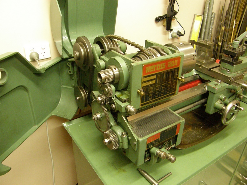

My Lathe is an Australian made clone of a Boxford.  It has a 1 ¾ in, 8TPI, 4MT spindle nose and will pass 1 1/16 in. through the bore.
The lathe has 16 speeds (8 direct, 8 back gear) covering 65 to 2650 rpm and a screw cutting gearbox with 8 tpi lead screw.  It came with the stand made from 2in sq tube.  I made the drawers, lined the frame and fitted the cupboard doors as you can’t have too much storage.
I have a good range of accessories for the lathe (steadies, 4 jaw, ER32 chuck & collets etc) but the next job on the list is a QCTP.

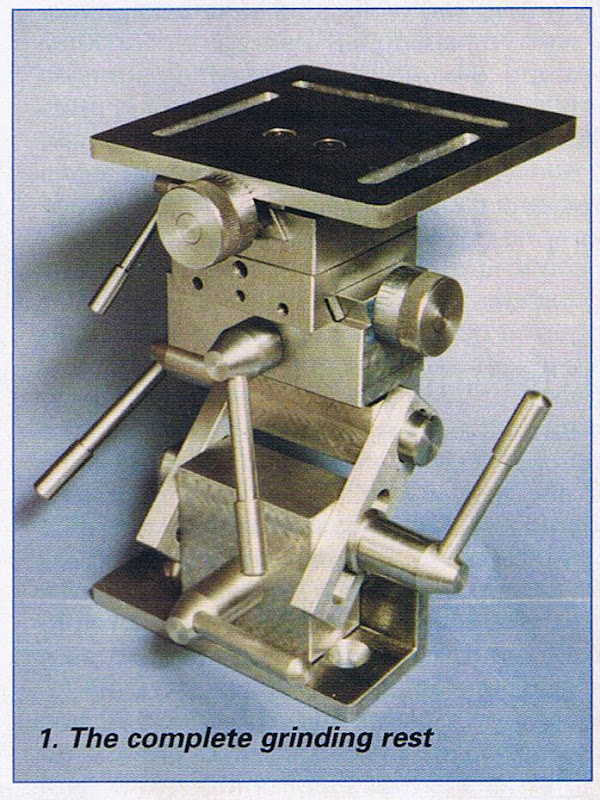

I am currently making a grinding rest designed by Harold Hall (published in MEW).  The design includes fixtures for sharping drill bits, end mills, lathe tools and slitting saw blades.
This is what it is meant to look like when finished.

Col, thanks for sharing your shop and nice work on your projects. You did the right thing by going with the glass scales.  I built the 350 within the first 3 months of release and used the calipers....I really regreted it.

In looking at that scanned photo of the completed grinding rest (which project interests me strangely), I'm not seeing any way to tilt the table precisely on either axis.  :scratch:
It surely has a plenitude of tommy bars and knobs, though!  :headbang:

The table tilts in the Y axis and rotates in the horizontal plain.
