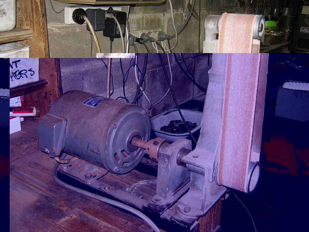

It's always interesting looking at photo's of peoples workshops and seeing what machines are featured - it's usually the bigger expensive stuff like lathes, surface grinders, pillar drills and mills.
Yet one machine I use on a very regular basis for deburring, facing, and polishing, seems absent in a lot of those workshops and I wonder whether many people use or own one of these great items.
It is of course the humble fixed belt sander.
I built mine up many years ago from a unit I got at a garage sale which was originally intended to be driven by an electric drill via a flexible drive cable.
This was pretty cruddy arrangement and explained why it appeared to be relatively un-used.
I modified it to something more practical and it's now direct driven with a 1250 rpm 240 volt motor I rescued from a hard refuse throw out day.
Doing it this way the relatively slow belt speed enables me to hold small items against it without them going into orbit, taking out a window, or grinding my finger tips down.
Really useful machine.
So how many of you modders have one of these?
