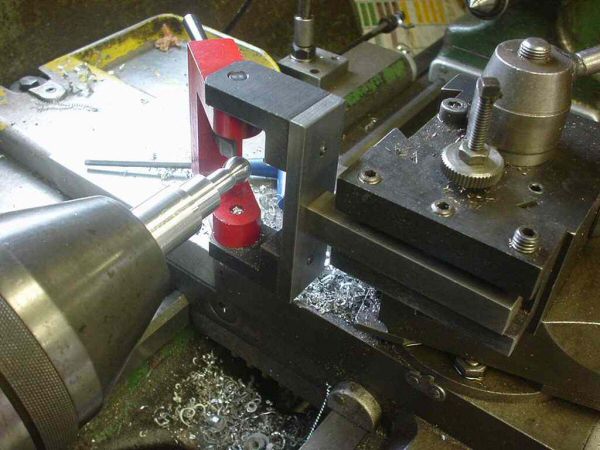

Made this attachment long time ago; looking at it now & comparing it to the latest designs this is designed way OTT! This was made to suit the height of my Clark combo so it is a fairly high piece.The cutting tool has gone walkabout but it sat in the round hole upper left & the diameter of the ball could be altered via the 'micro adjuster' arrangement on the baseplate.
One of my 'new projects ' will be to make the simpler design as seen on modders posts, but as I am looking to update my lathe & have a milling machine separately (as part of the outside shed project & am looking at Chester 'comet' & 20V anyone have these,what is their opinion?) it will be put on hold.
Have att more pics for your cogitation
Cheers for now  :nrocks:
http://i1136.photobucket.com/albums/n490/mechman48/DSC00614.jpgBall turning attachment
Another shot with a couple of examples made with it inc' the handle
http://i1136.photobucket.com/albums/n490/mechman48/DSC00616.jpgBall turning attachment

I use one of these.
It's the ball turner for the minilathe in a universal holder I got from ARC.
dead easy to setup, very quick and I can swap it about between machines.
I have a similar one to what George showed that came with the CVA but it takes ages to setup after removing the top slide etc, then i can't remember how to use it  :doh:
