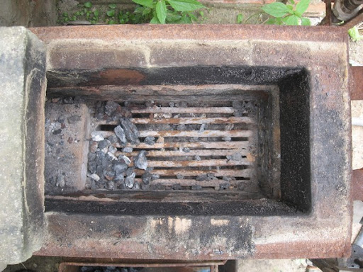

Offline szaroleta
  • Posts: 5
Re: Vertical twin steam engine with alternator
« Reply #15 on: July 18, 2011, 07:38:54 AM »
Thank you for all your kind words.
To build the steam boiler I used two u-shape tanks. I took it from old cooking furnaces. When you are cooking it also heats water in central heating.
It was something like this:
I linked two tanks and added pressure gauge, safety valve and water gauge. I also built hand water pump. In the chimney there is superheater. The building next to the boiler is smokehause. They have got mutual chimney.
There are some photos:
