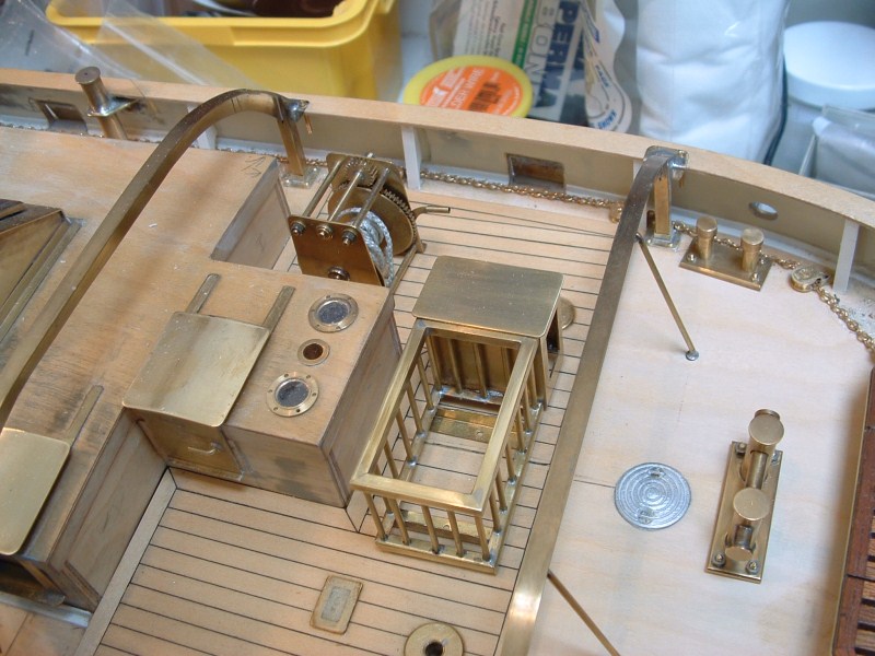

I do a lot of small brass soldering and I have not found better than this for flux  Bakers Soldering Fluid No3   this sort of thing
http://www.chronos.ltd.uk/acatalog/Bakers-Soldering-Fluid-No3.html
Peter

Thanks for the flux recommendation ... and beautiful work on the boat.  More pictures and a description please.
Allan
