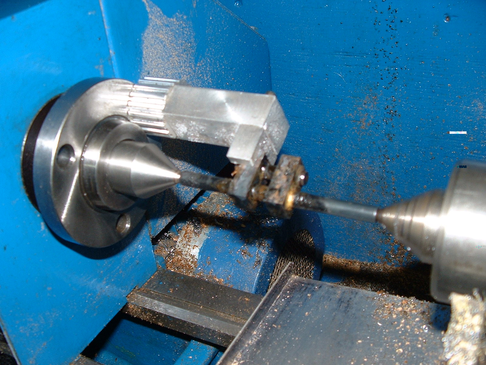

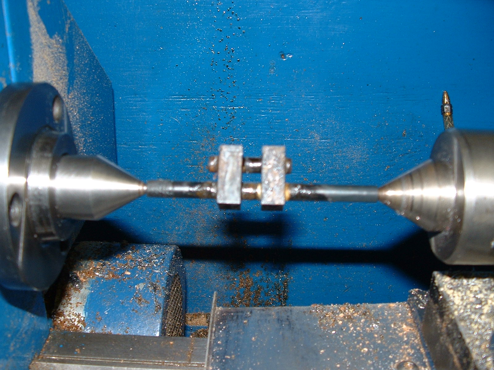

hi her is sum pics of my set up fore turning up betwen centers

Thanks. I'll have to remove 3-jaw chuck. Thanks for the ideas, I have to somehow use the chuck backplate to drive the dog. Thanks for the picture krv3000, something like that.
